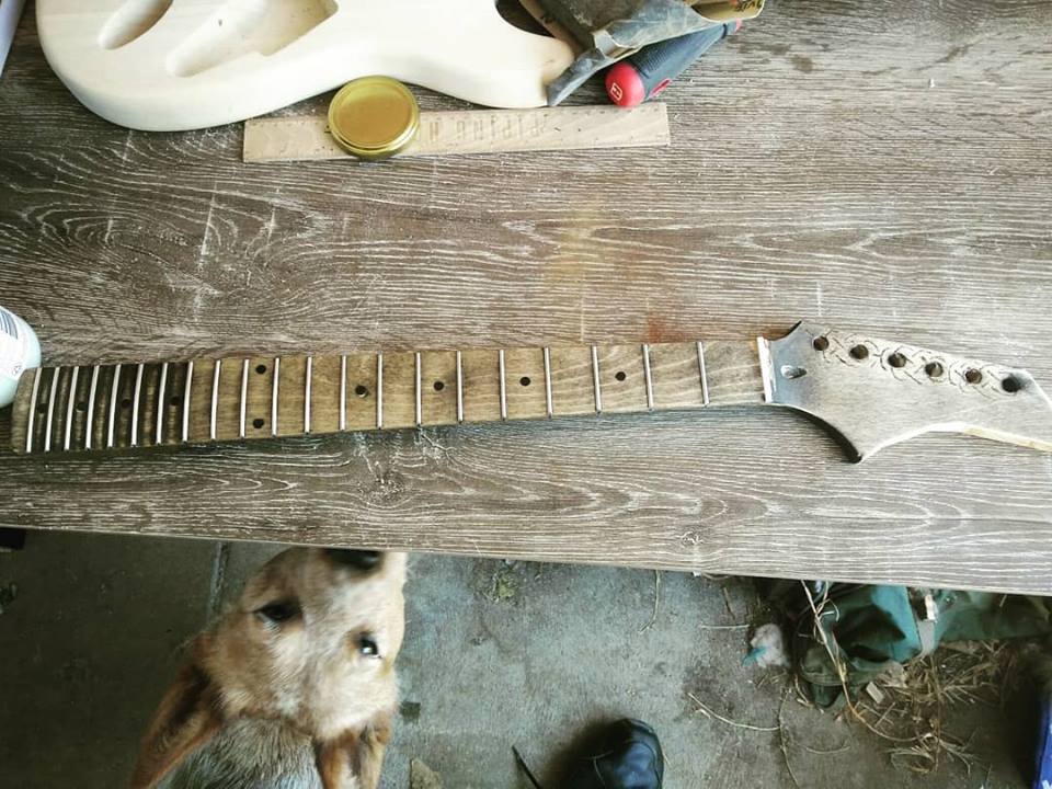

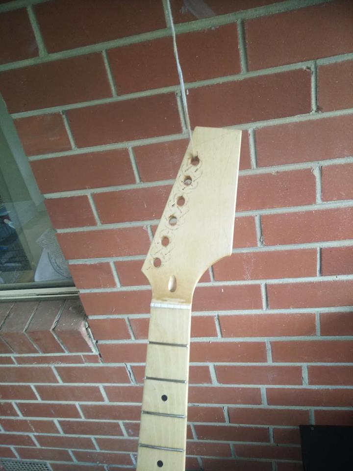

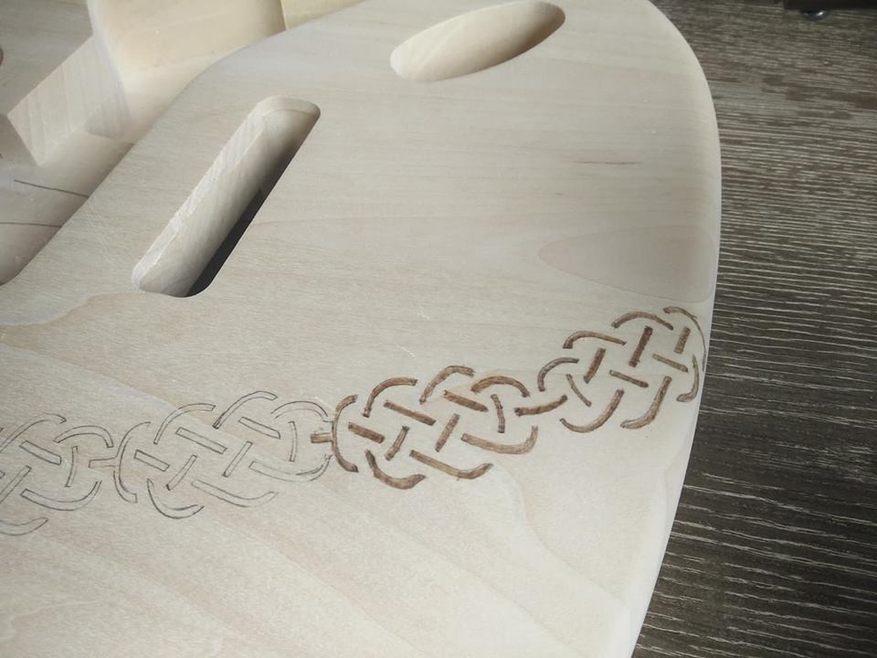

ID:	28287slowly staining the neck and burning in the designs

    I like the design there! Will you paint it and pick this out, or stain it?
    Im gonna stain it, ive just stained the neck with a mixture of tea and coffee plus cinnamon and played around with soaking steel wool in vinegar. im gonna buff and polish it when its all done to get a shiny finish, but im not sure what to use for that. will probably do the same with the body
  6. #16
    Are you leaving the headstock that shape?
    If not it may be best to cut & shape it now if you plan to have a uniform stain colour all over.
    On my 5th build (link in signature below) I did the chemical wash stain method you described above and it will need some top coat otherwise parts will gradually wipe off over time through natural wear & tear. If buffed straight up it will disappear before your eyes in no time at all. I used lots & lots of Tru Oil but any type of top coat should do equally as good a job to help you achieve a shiny finish.
    Cheers, Waz

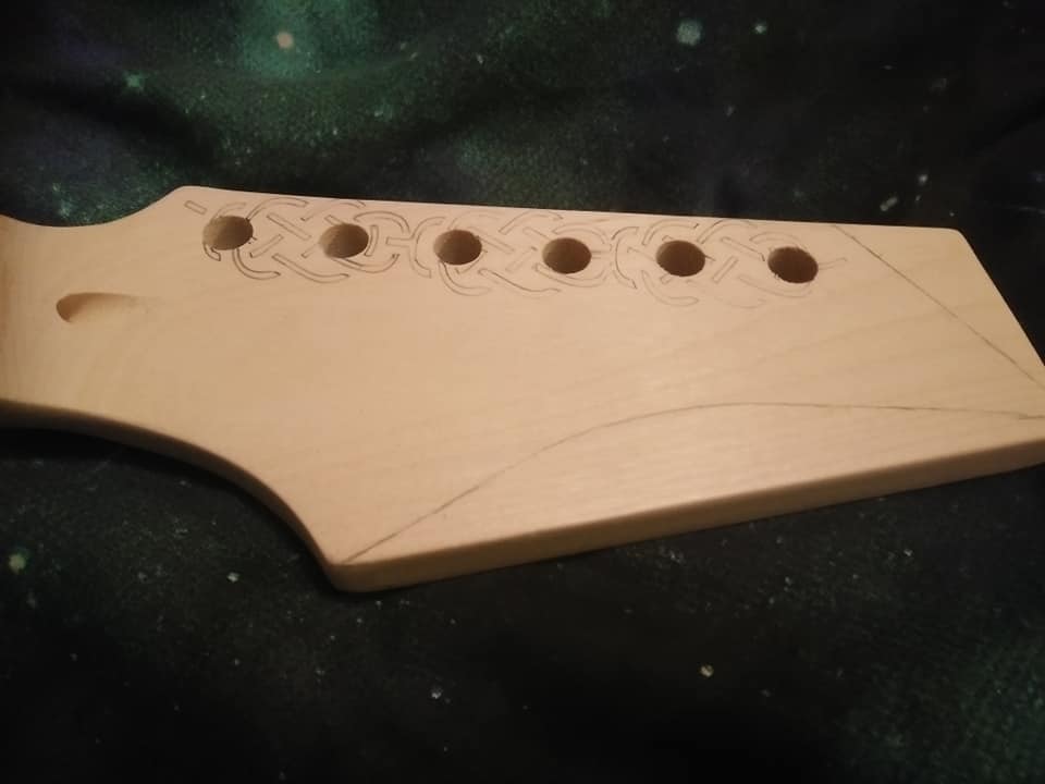

ID:	28317faint out line of the headstock shape.
    I get what you mean, i probably should shape that sooner rather than later. I love your builds too man

    look at the colour difference haha. ive shaped the headstock more or less with a handsaw haha

    I love that stressed timber look on the neck. Just some sanding to finish the headstock and it will look great!

    If he hasn't already, Fido looks keen to have a go at it.
