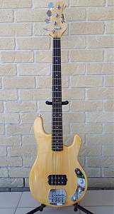

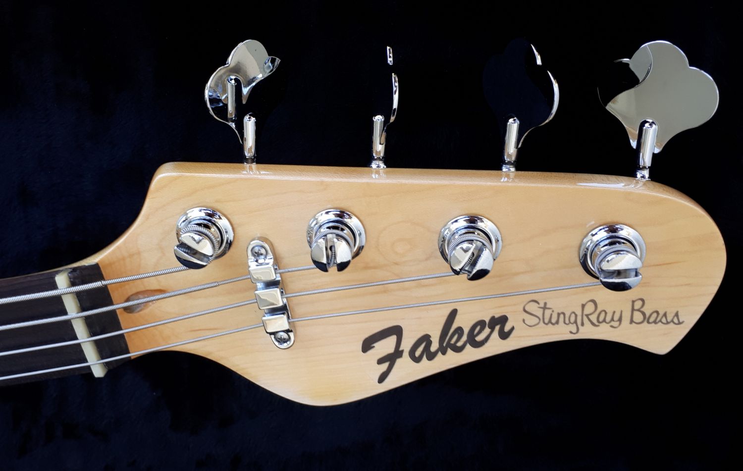

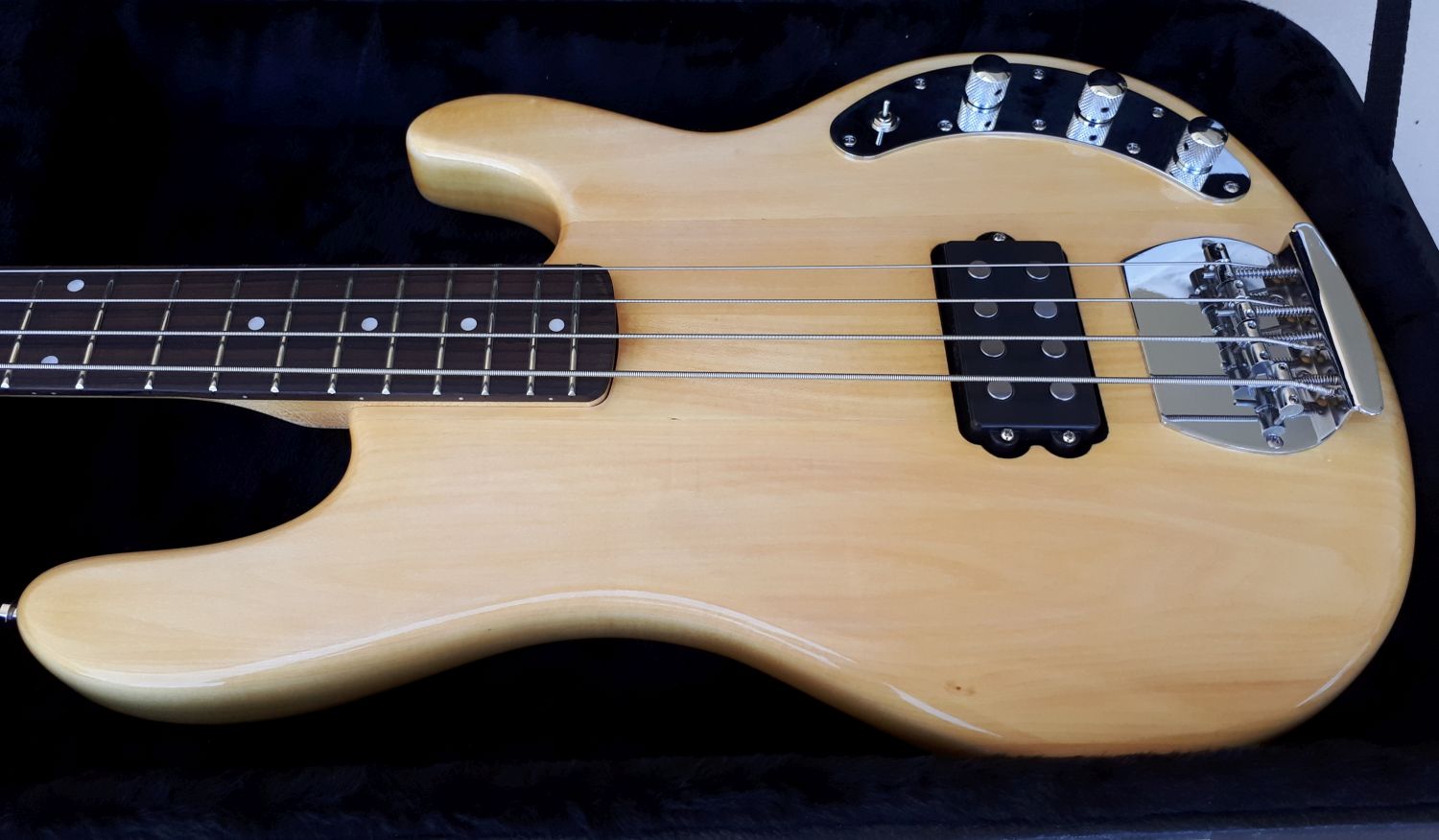

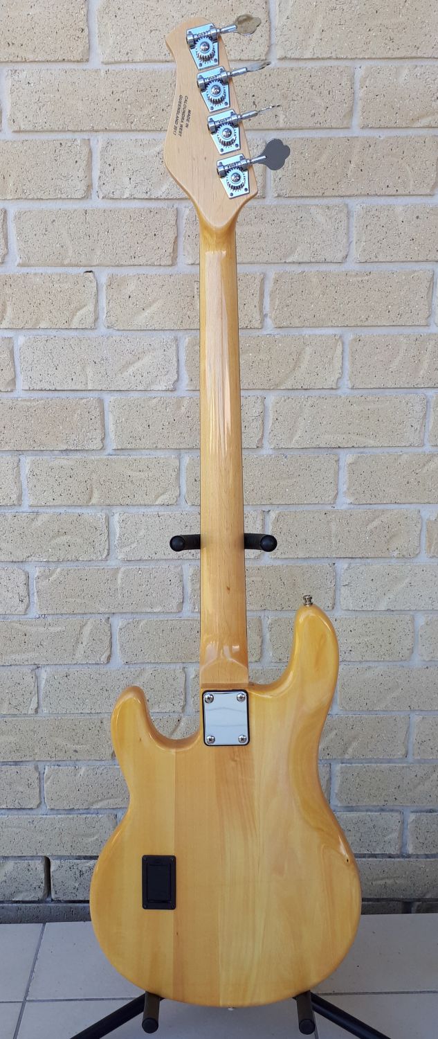

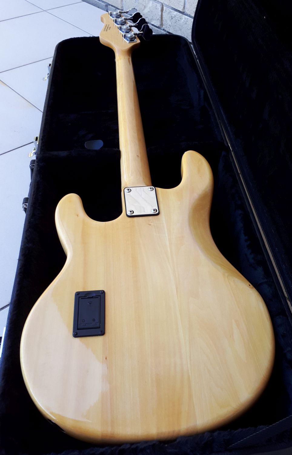

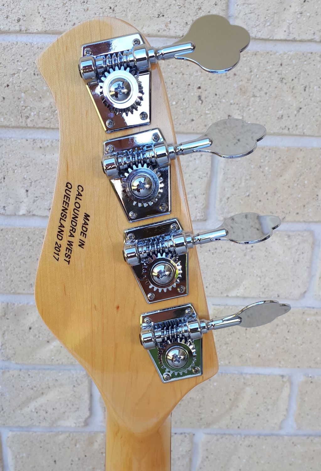

    Next entry for Rockotober is my MMB4 that has been on the go since March 2017.
    http://www.buildyourownguitar.com.au...764#post171764 for Build Diary.
    https://youtu.be/fbjI0MssJtc for sound demo.
    Not too many original kit bits ended up being used other than neck & body, bridge, control plate & screws, neck plate & bolts.
    Some of the modifications included:
    Rounded over the side profile by hand using 80 & 120 grit sand paper.
    MM 5 string headstock shape used without the offset 5th string tuner hole
    Allparts 4 in Line Bass Tuner Set
    Allparts Tele style Chrome Electrosocket Jack Plate
    PBG Bone Nut
    Chrome 3 string retainer
    GFS MM Pro Plus- Alnico Music Man style pickup
    Belcat Pre-Amp
    Jaycar mini DPDT on-off-on pickup coil split switch
    Straplocks
    Finished with well over 30 coats of Tru Oil
Name:	Full length front on top of case 1.jpg
ID:	28008Click image for larger version.
Name:	Body in case 2.jpg
ID:	28009Click image for larger version.
Name:	Full length back on top of case 3.jpg
ID:	28010Click image for larger version.
Name:	Headstock - front 4.jpg
ID:	28011Click image for larger version.
Name:	Headstock Rear 5.jpg

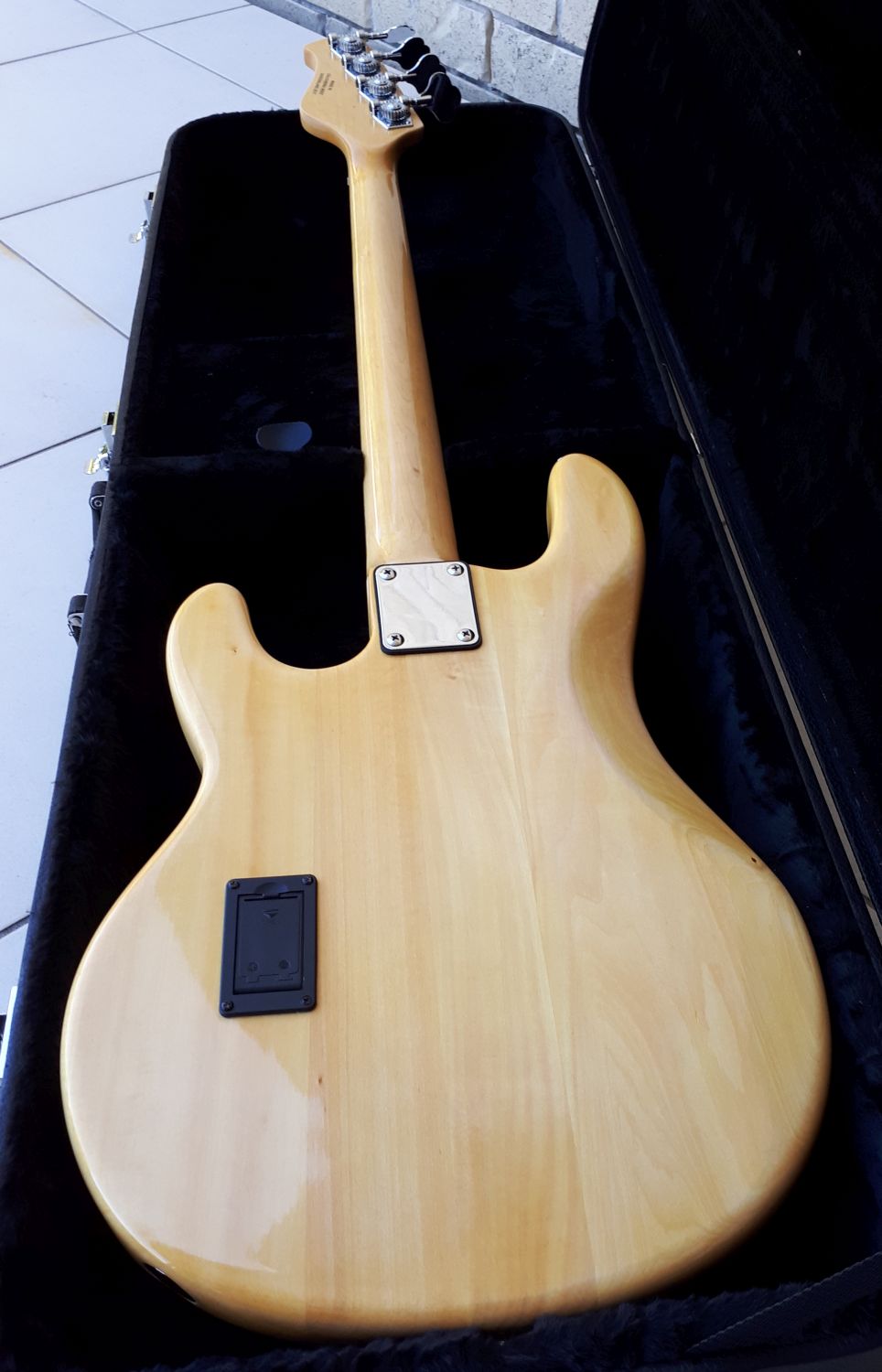

    And a few more....
Name:	Full length front in case 6.jpg
ID:	28013Click image for larger version.
Name:	Front full length square on 7.jpg
ID:	28014Click image for larger version.
Name:	Back full length square on 8.jpg
ID:	28015Click image for larger version.
Name:	Back close up 9.jpg

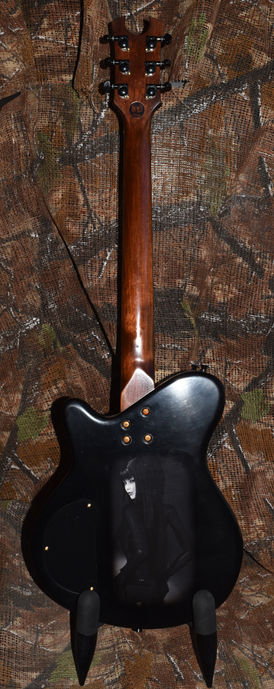

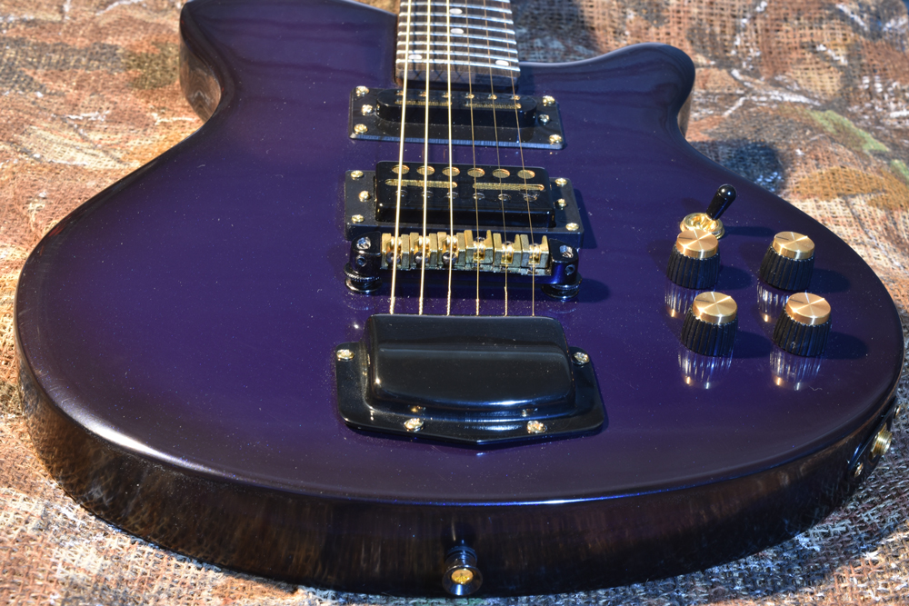

    Decided to call this finished before I over did it.
    PGB-2 kit.
    The only real mod is filling in the stop tail holes so I could fit the replica Teisco tail piece. Bridge is a combination of parts from a gold roller bridge and a black one. Pick ups are GFS Gold Foils which where previously in the Community prototype build ( now onto its 3rd makeover). Pots are Alphas, 250 on the single coil, a 500 push pull splitting the humbucker. Knobs are Marshal amp knobs. Brass nut. Tuners are Grovers with gold nuts and screws from a set of kit tuners. I cut the headstock shape with a hole saw in a pedestal drill.
    Paint is auto acrylic, its a dark blue metallic pearl on the front which flip flops to dark purple in different light. There is a black burst on the edges which is just visible as I mixed some of the blue in the first clear coats. On the back is a large print of one of my 3D renders which I tried to blend into the black, even with umpteen layers of clear the edges are still visible.. oh well, it was an experiment.
    Anyway it plays and sounds nice, the tail piece is a right pain the string up. I resorted to putting all the strings in and holding them in place with a bit of tape until they had tension on them, then reaching in with bent tweezers an pulling the tape out.
