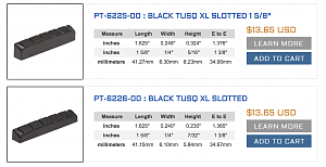

    Can't find replacement graphite nut this size doesn't exist anywhere
    I have an old guitar with a similar bone nut. I'll try it.

    Should be a standard Gibson sized nut and therefore plenty of aftermarket options available.
  3. Liked by: Souhail
  4. #13
    43mm is the standard Gibson size, 41.7mm certainly isn't! I had/have a similar problem with my EX-1. The top of the nut that's fitted is slimmer than 43mm, and the string slots are closer together than on a standard 43mm nut. I've looked at using a 43mm nut and just filing the ends down (which you can do with some necks) but the strings would be too near the edges of the fretboard. So I've bought a 43mm bone blank, filed it down at the ends and need to cut slots in it using my nut files using the old nut as a template for the slot positions.

    http://www.warmoth.com/Guitar/Necks/NutWidth.aspx
    it's a nut size that exists "Vintage" my very old Yamaha has the same nut size, not a PG custom nut size .
    i'll double (quadruple) check the size to be sure that it's a 1-5/8 (41,??mm) length and it's exactly the same size from E to E.
    it looks like fender also uses this size on some of their guitars.
Name:	Capture d’écran 2018-08-31 à 13.40.31.png
    one of those two should be the exact size.
