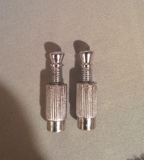

    ran into my first problem
    I just noticed that the posts for the bridge are different. I think this will be a problem.
    I know colin2121 had the same issue.
    Is there someone specific I should contact about this?
    As Simon indicated, contact Adam.
    He will post some replacements.

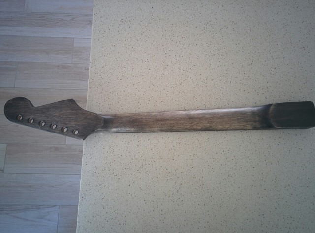

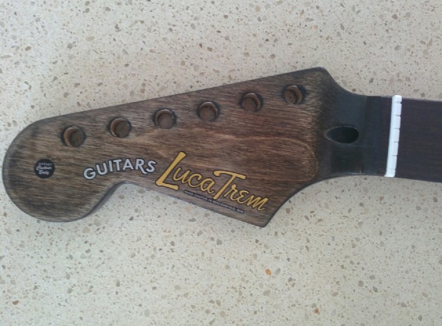

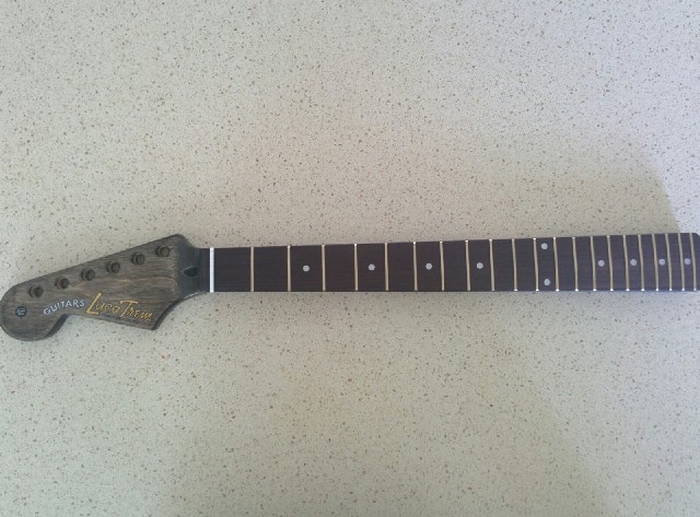

    The neck is almost done.
    So I think i'm almost done with neck.
    I just need a few more coats of wipe on poly to make the decals disappear.

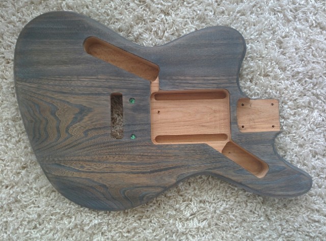

    More work on the body.
    After adding Ebony stain to the grain filler and sanding it back, I put on one coat of Saman's white wash water based stain.
    I really like the way it looks but I'll need to darken it a bit so that it fits with the look of the neck.

    Body work continued
    Once again I sanded back some of the white wash stain and it gave me a really cool, blueish grey, white in some parts of the grain. I then wiped on and immediately removed a little more ebony stain.
    The look was unexpected but I like it.
