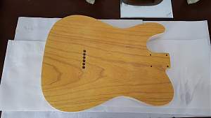

    Anyway here is the starting point, just arrived. A one peice ash body set up to accept vintage spec hardware.Unfinished, and made in Japan. So its going to be my tribute to a 50's tele. Hope to get a genuine Fender repo '52 neck from Stratoshere or somewhere similar. No doubt be a MIM one as I'm not spending $600+ on a made in the USA piece.
    Plan is to finish in a traditional Butterscotch / Blonde colour, black pickguard. Here's hoping I get this one right.
    Attachment 27498
    Attachment 27499

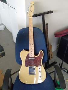

    So, basically like the finish on the body of my custom Telecaster then?

    Quote Originally Posted by Rossc0 View Post
    Yes Butterscotch. My own fault, really shouldn't have tried in the weather we're currently having.
    You in Qld? I don't know where you are.
    In any event, I usually find that it just takes longer to dry before the next coat
    NSW, but at the moment I don't think it matters where you are. Will wait till we get a slightly cooler less humid spell. May just be I went too may coats too quickly.
    You recon the Butterscotch takes longer to dry than other DT's?

    Got the period correct 5 screw pick guard without the neck pickup screw holes and a 7.25in radius '52 model neck, Just need the weather to change so I can give the stain another go.

    Take 2. In the house this time sitting under the AC running on Dehumidify. We'll see how long it takes till I'm kicked back out into the garage :-)

    That looks great mate.
    Ok so, as there is only a "stain coat" being the mix of butterscotch and white base, it takes just a little longer than a normal stain coat but a lot less than a normal intensifier coat to dry.
    Look as a general rule I always wait about a week between stain coats before applying the next coat, if its humid I'll wait two weeks or more.
    The thicker you put it on the longer you have to wait.
    I found that once I put on each butterscotch coat it would look rad, then fade as it dried. So I'm pretty sure I put on somewhere between 4 and 6 coats all up.

    Cheers Andy, Yes it fades a huge amount, I've got 2 on, and with having done a couple and sanded off probably don't have enough for 6, but will get another one at least.
