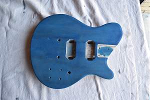

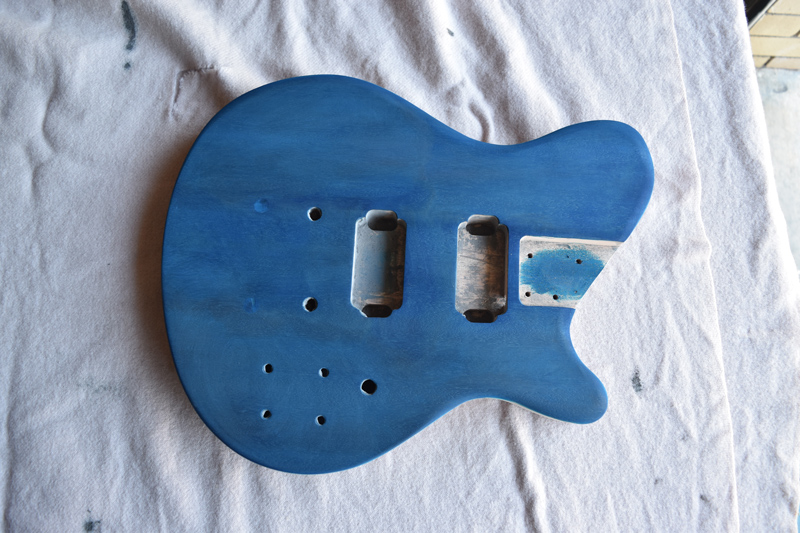

    first stain coat on. The filled in tail piece holes will be hidden by the new tail piece

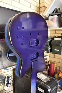

    well, there was a problem....on applying a clear coat (acrylic) the dye went a khaki green. So off to the paint store... new top colour scheme comin up . I think this is a result of the timbers underlying hues, as I tried dissolving some of the dye powder in the actual clear coat and it looked fine, sprayed fine on pine but went hideous green on the mahogany. Metallic pearl navy blue top coming up.

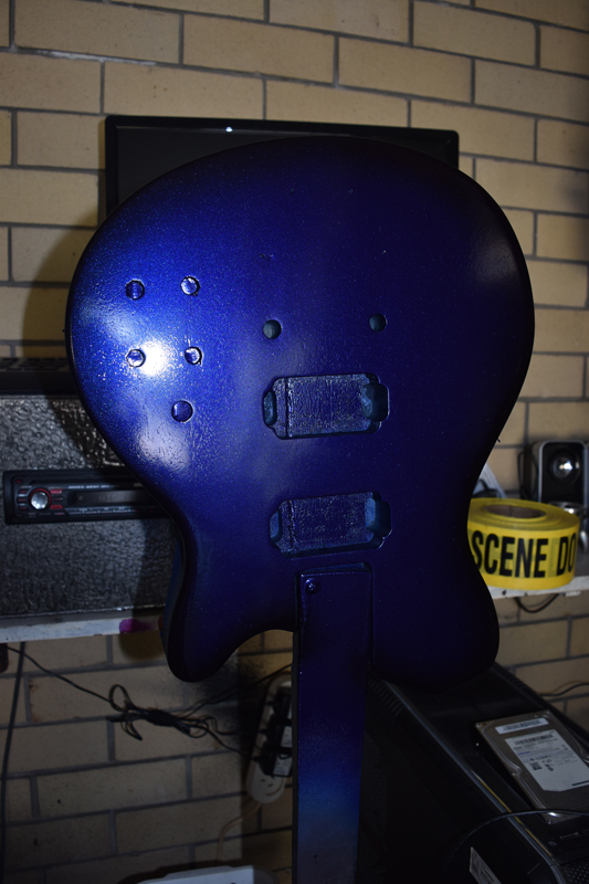

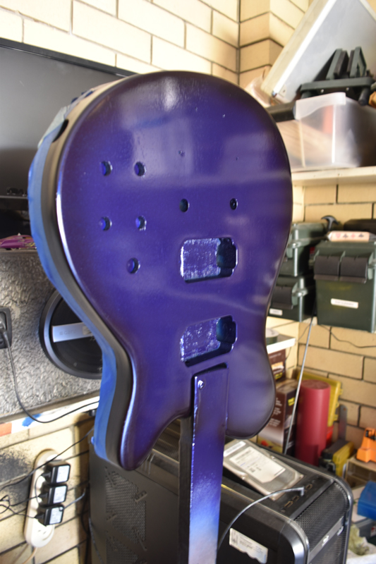

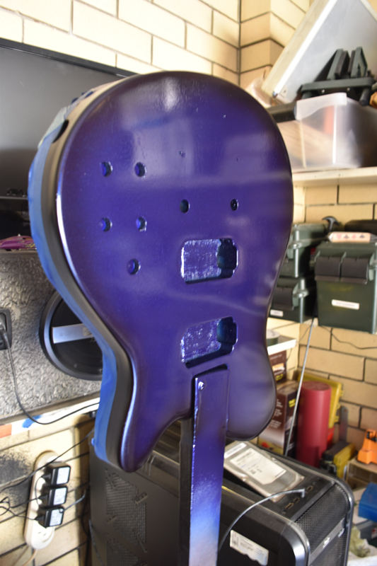

    LOL Waz. well. This is kinda cammo... is it blue or is it purple? We could go viral with this!
    There is a bit of red pearl in the colour so depending on the light it can look purple or blue. There is a thin fade/burst on the edges but I mixed some of the colour in with the first clear coat, the result is an extremely subtle fade. That is the first clear coat in the pics. Subsequent coats will fill the last of the visible grain.
