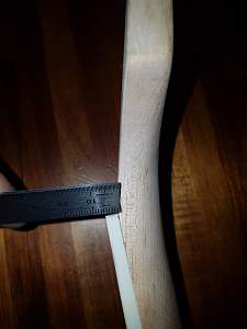

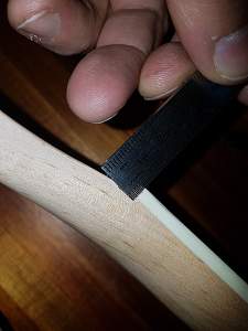

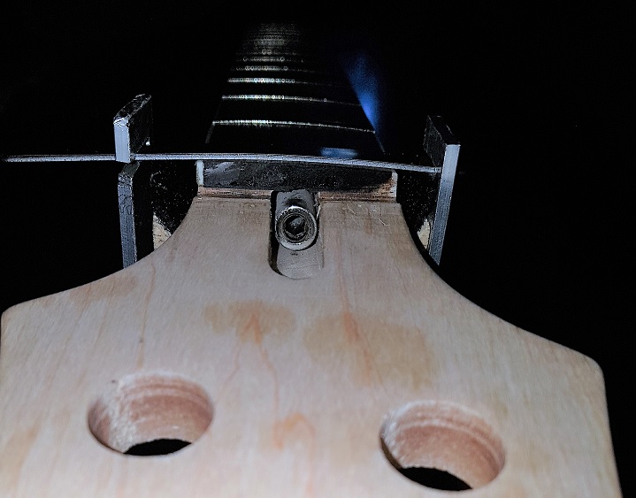

    The height of the original nut would also have caused some fret buzz if left on. The E string slot was not even the same height as the first fret.
Name:	E string nut slot height.png

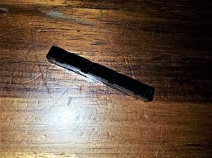

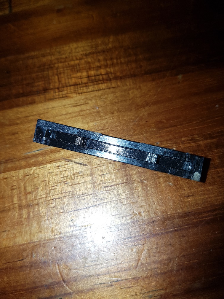

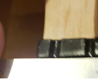

    Here is the nut.
    Plastic and hollow.

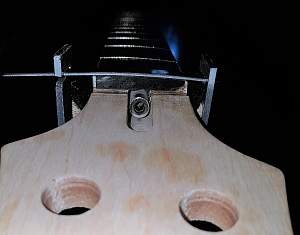

    I got creative this morning and made my own version of stewmac's safe slot nut guard.
    does the job ok. Not as pretty as the original but just as functional.
    Using this tool, feeler gauges and following the how to videos on the stewmac site I was able to determine the accurate height of the first fret as 1.13mm. (0.044") which is OK.
Name:	fret height.jpg

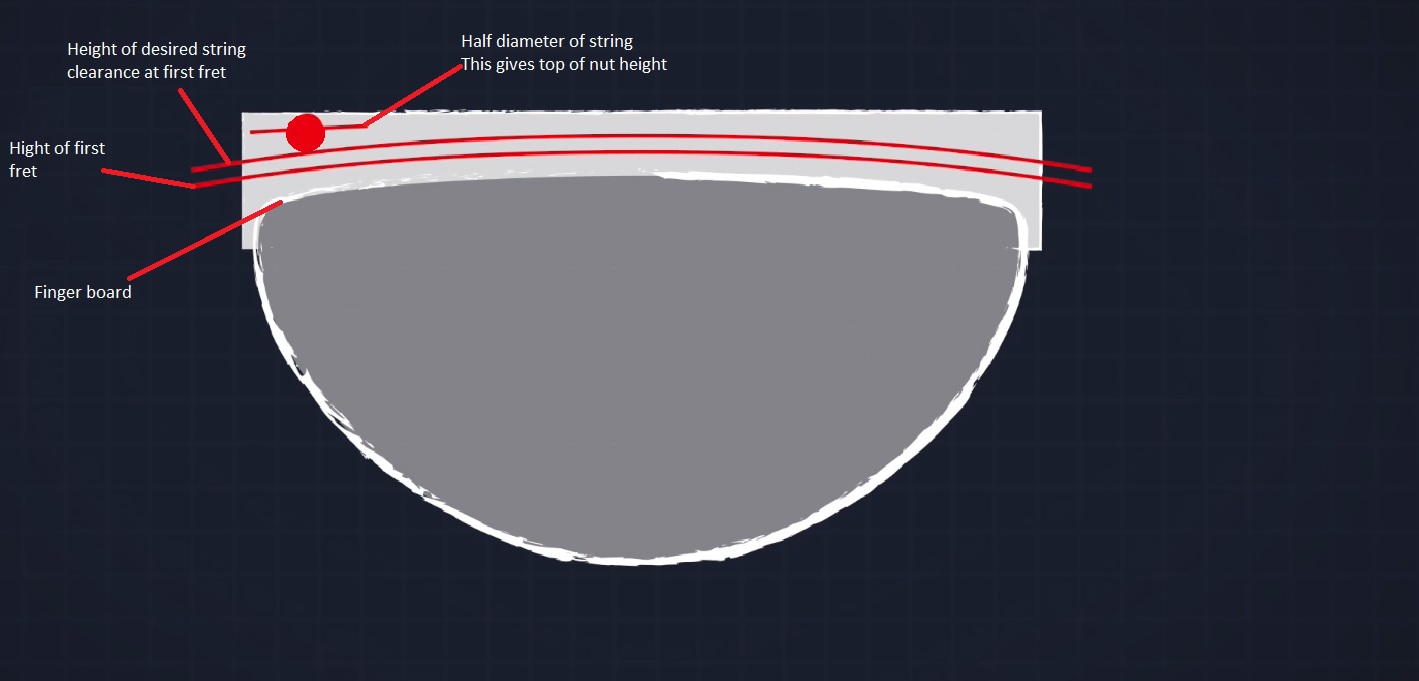

    The below diagram is adapted from a still shot on a how-to video on another site.
    The top of the nut needs to be height of first fret + height of string clearance + half diameter of string.
Name:	nut height.jpg
    l Like a string clearance of approx 0.55 - 0.6mm at first fret.
    So using those figures the nut slot depth above fret board for E string should be 1.13mm(fret height) + 0.55mm (string clearance hight) so 1.68mm. The top of the nut should be that figure plus half of string diameter (I'm fitting 45-105 which is 2.667mm E string) so another 1.33mm. This means my over all height of nut at E string is 3.01mm above fret board.

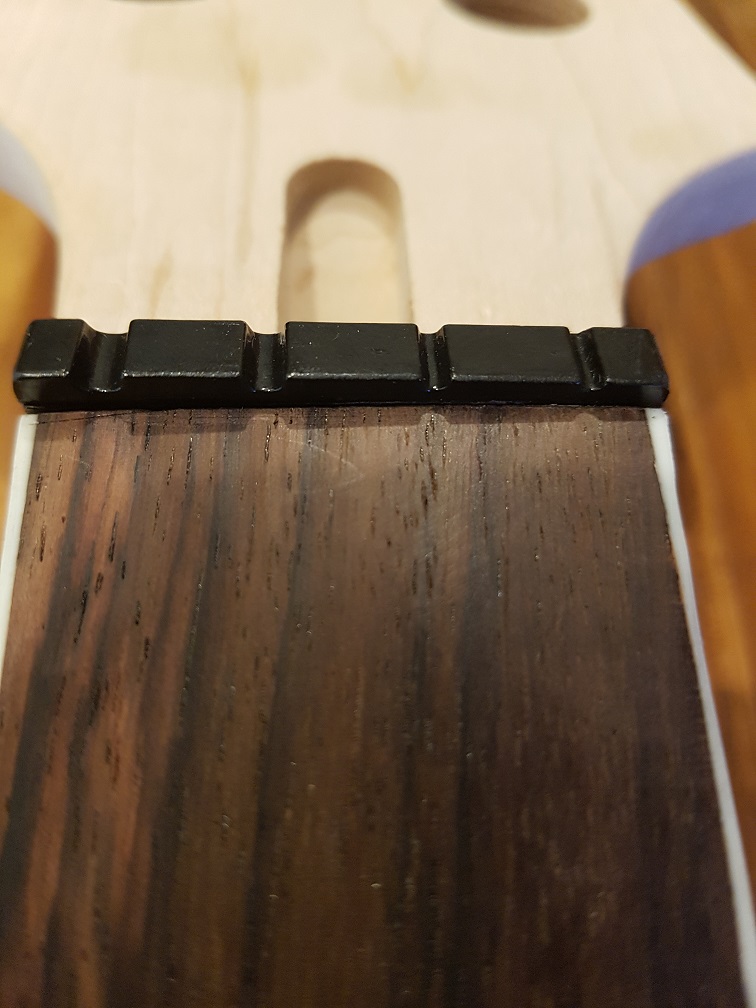

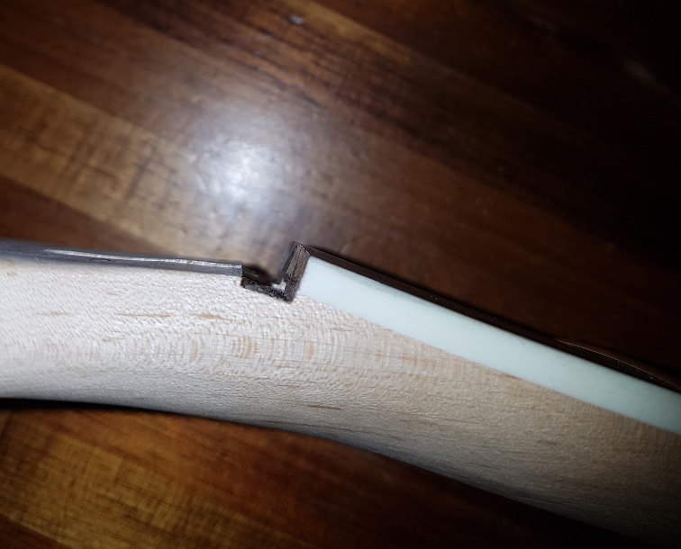

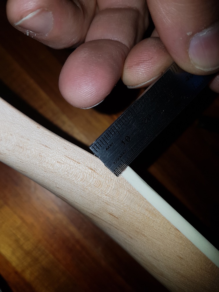

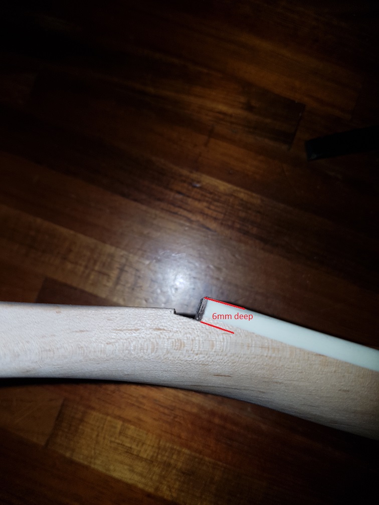

    I'm going to have to get some more bone nut blanks.
    The recess for the nut is a lot deeper on this neck than any of my other basses or guitars.
    This will mean I need a nut blank that is almost 11mm high.
    Not a common size...
