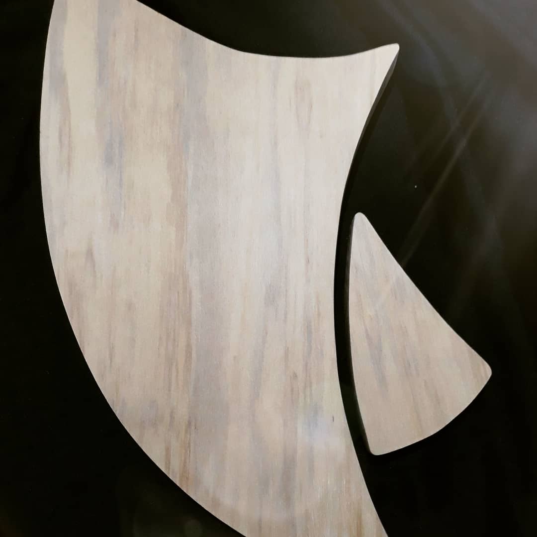

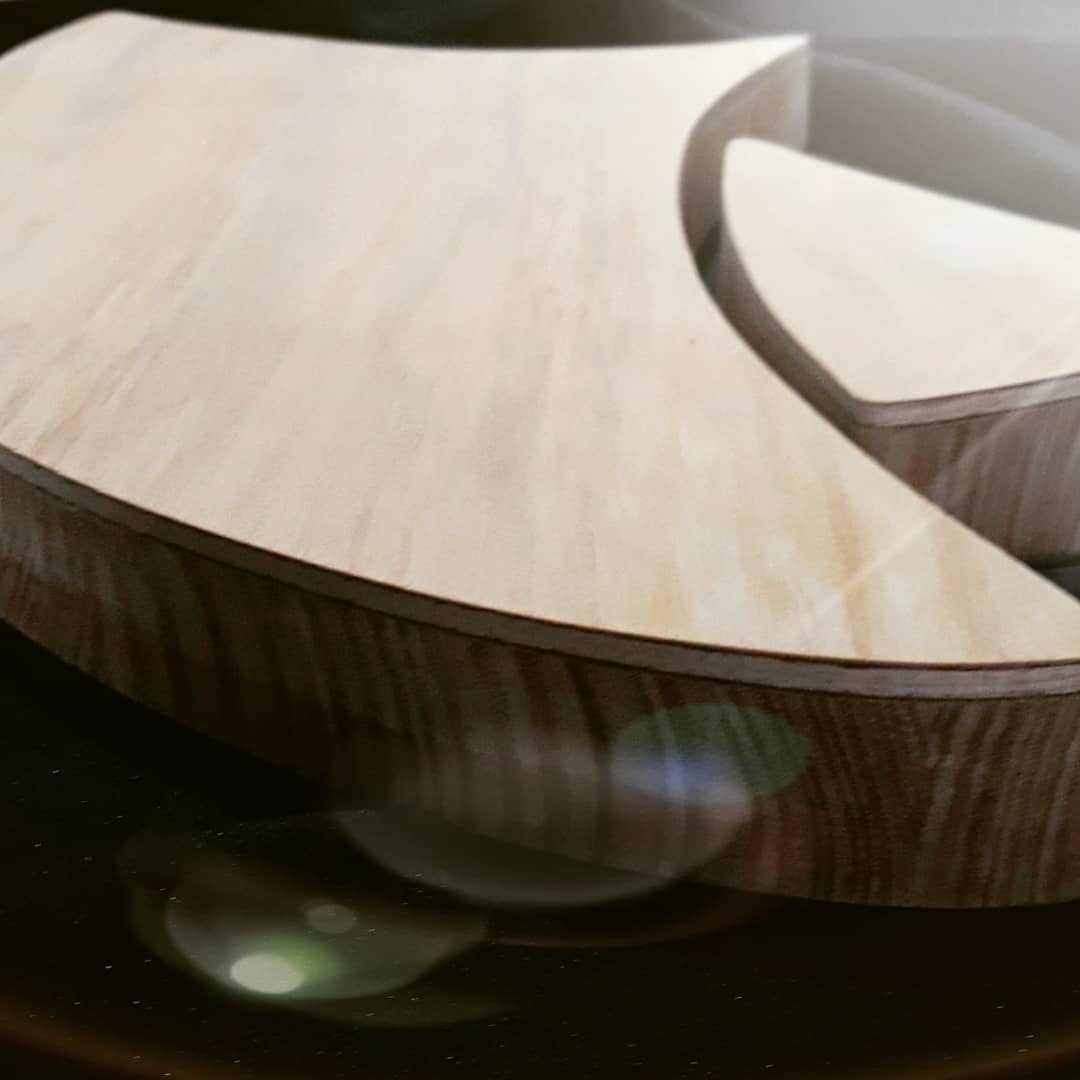

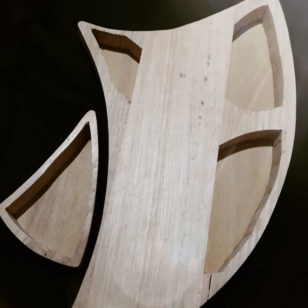

    Sun and Moon Guitar body
    Couple of pics of the body going well despite having a few arguments with my router table, my fault forgetting about grain direction!!! Doh! 😕

  11. #17
    At least it’s just the hidden bits.

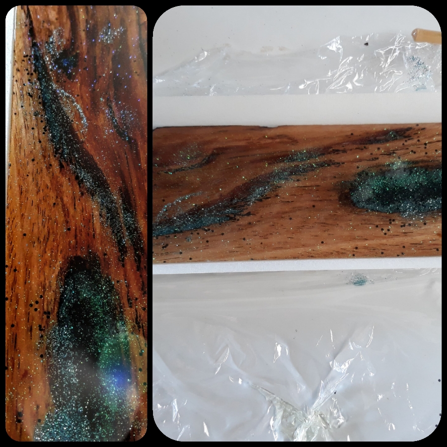

    Fretboard for Sun and Moon Guitar
    Thought I'd show you all a pic of the fretboard, I was going to use a neck I had in stock but decided I needed the practice on making one and that it should be a bit different considering the body shape.
    The neck is European Beech and the fretboard is rustic grade Vic Ash flooring. The occlusions will be resin filled with a bit of added colour, black, white and aqua flake.

    Oh dude, this is going to be amazing....really keen to see how that fretboard comes up!

    Thanks Frankenwashie this is the resin infill it will be sanded and radiussed then clear coated or oiled hopefully the occlusions will look like Aussie Opals🤞
