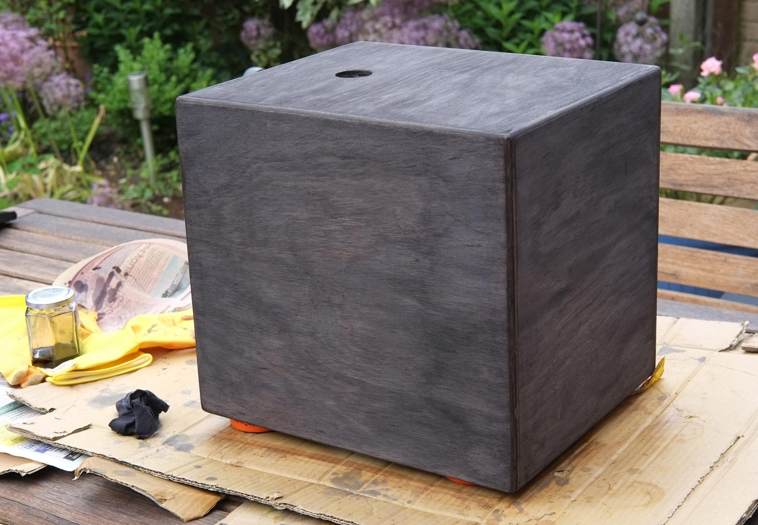

So started out with a black stain:
Name:	Bass cab black small.jpg

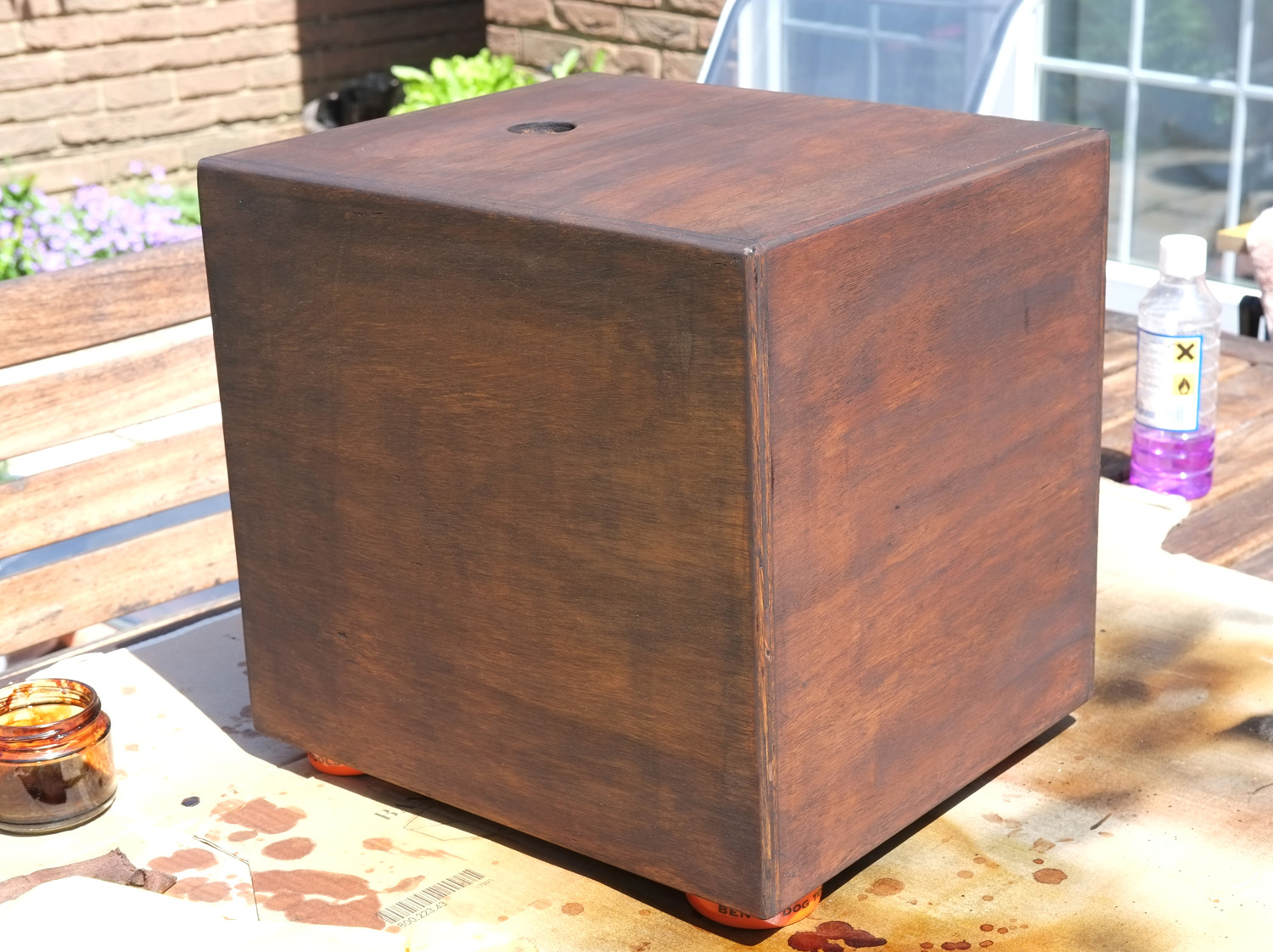

Then sanded that back (like on a figured veneer) and then used a dark-brown stain:
Name:	Cab brownstain small.jpg
I then applied yacht varnish over several weeks, giving each coat time to dry. Despite being as careful as possible, as it got varnished with the front facing down I still ended up with some runs around the front edges, so will be leaving it for quite a while before addressing those to give them time to really harden. But after five coats of varnish, I didn't see any reason not to finish putting it all together.
