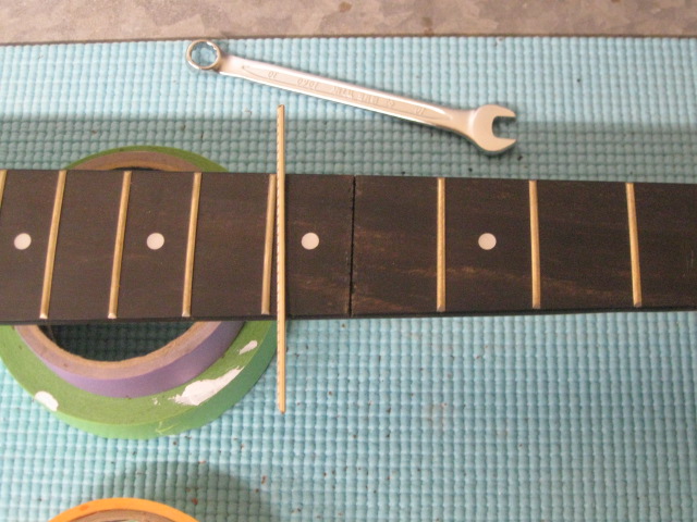

    Extraction successful.

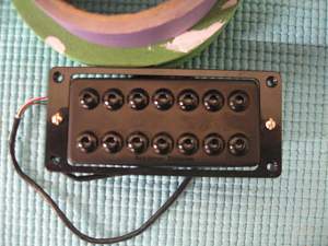

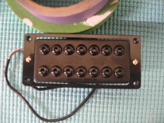

    The invader in the supplied kit ring as it came with a flat one.

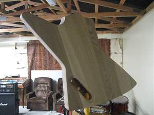

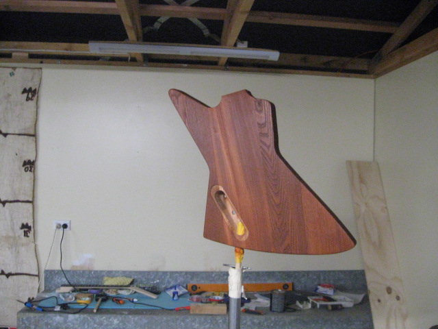

    My budget staining rig made up from a taped up drumstick with a drill bit through it, sitting on some stand with wheels on it I found lying around the yard.
    One coat of stain I picked up at a clearance store for $10. Varathane chestnut I believe.
    Pretty chuffed with the result and the colour to be honest. It was my first time trying to do any kind of finishing. Looks sort of similar to Mr. Hetfield's Ken Lawrence beast. Another coat or two should even out the colour a bit more.
    Looking good. You’ve been lucky with the wood orientation. The light-dark-light-dark strips look really good. Better than if there had just been one piece of wood that took the stain differently.

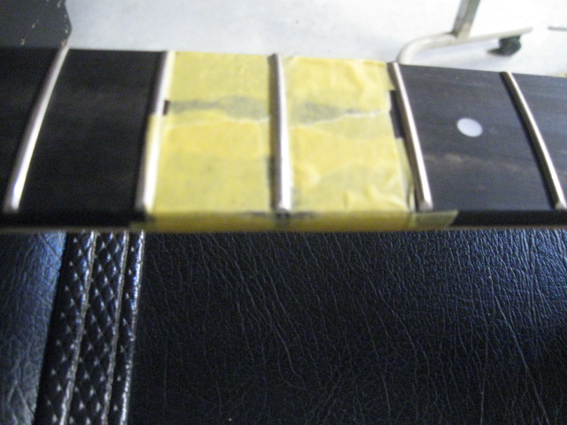

    Cannibal corpse could probably write a song about the events that unfolded after this showed up.

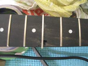

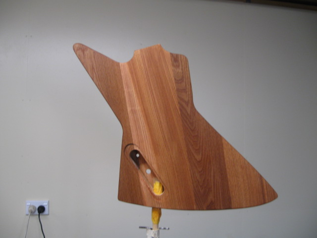

    My attempt last night resulted in resounding failure, I didn't put enough curve in the wire and the all fix glue wasn't doing it. Went and bought some proper super glue, put a bit more curve in the wire and wound up with this.

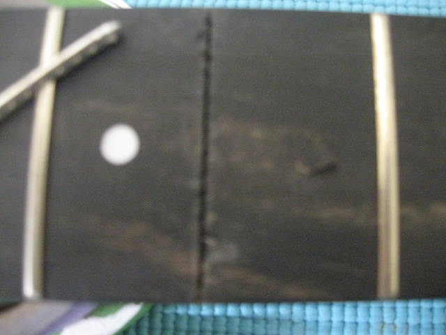

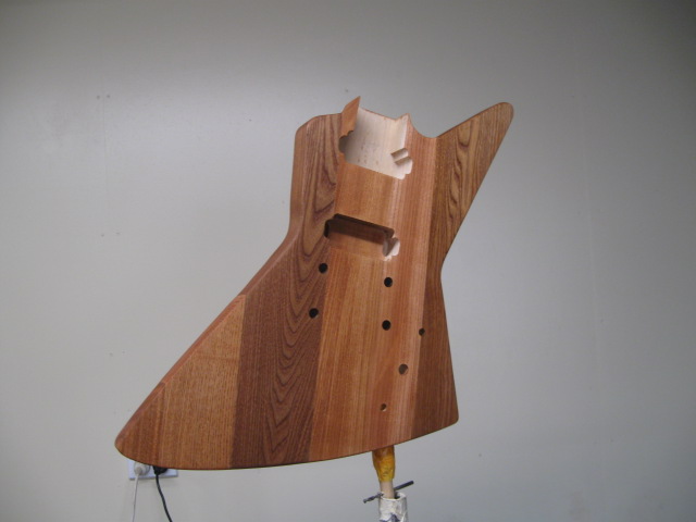

    Pretty happy with it, the edges are staying down and that was my main concern. Have started to build up glue in the visible chips and also in this hole further down.

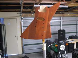

    The State of the body, stain applied with a foam brush. Found out about overspray from the brush pretty quickly. This is four progressively lighter coats with a light sand after the second one. I was doing a coat a day and buy the end of it I think the wood was getting pretty saturated. Has been sitting for about 2 or 3 days now, I think I'll leave it like this and try to match the neck up or get a more amber colour to contrast.
    The colour in the first shot looks a bit weird because it's sitting under a led light but hopefully you get the idea.

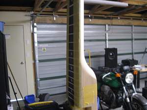

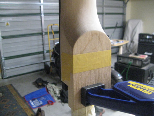

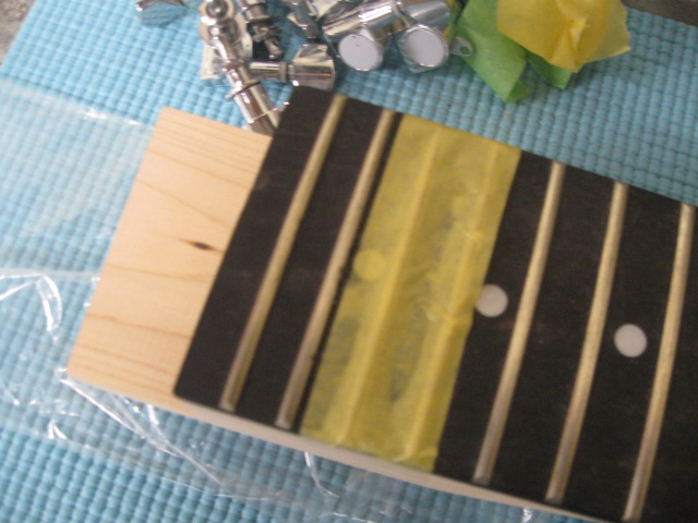

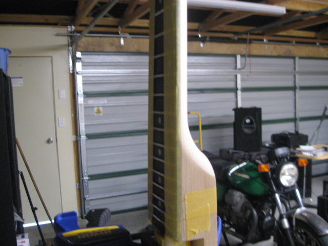

    Also had a crack at levelling the frets but it just wasn't happening with my limited setup. Managed to track down a local guy that builds his own guitars from scratch and got him to do it, charged me next to nothing too. There's always the next one...

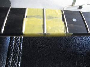

    Started taping off the neck to put the colour on that.
    Have started staining it, will probably give it a couple of sands in between coats as there is now a few rough spots that have made themselves obvious with colour. Have got a bit of this on the body too but I'm not too bothered about that, can't really be helped with the differing timbers and I quite like it looking a bit rough and ready anyway. I'm using a different colour for the neck, prepare to be shocked and disgusted...
