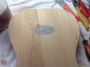

    Ok first job, filling the wonky pre drilled ferrule holes on the back with some builders bog.

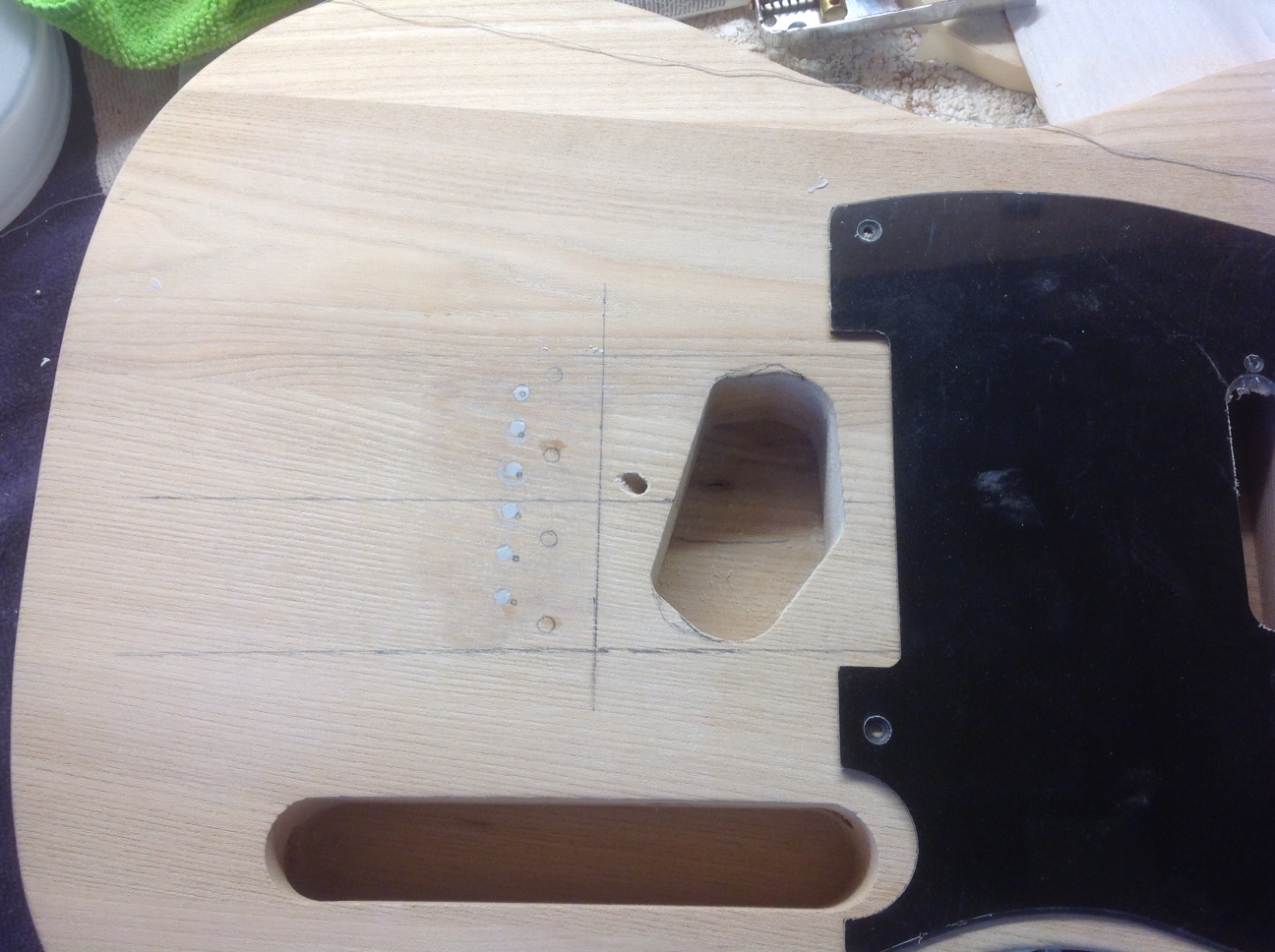

    Mentor Andyxlh's Avatar
    1,206

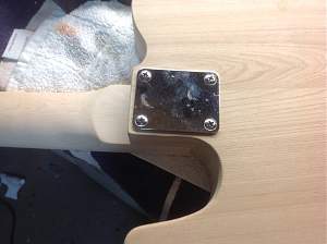

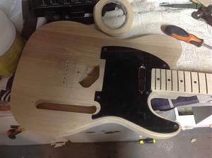

    Hmm, a couple of problems...
    Fitting the neck, it's a wonderful fit in the body cavity so all good.
    The neck plate is a long way off at an angle, so those need filling and re drilling
    The pre drilled holes were squiffy, so I fixed them, but then found out the ones in the front are in the wrong place! They are at an angle and not in the centre of the body, so those need fixing too........

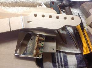

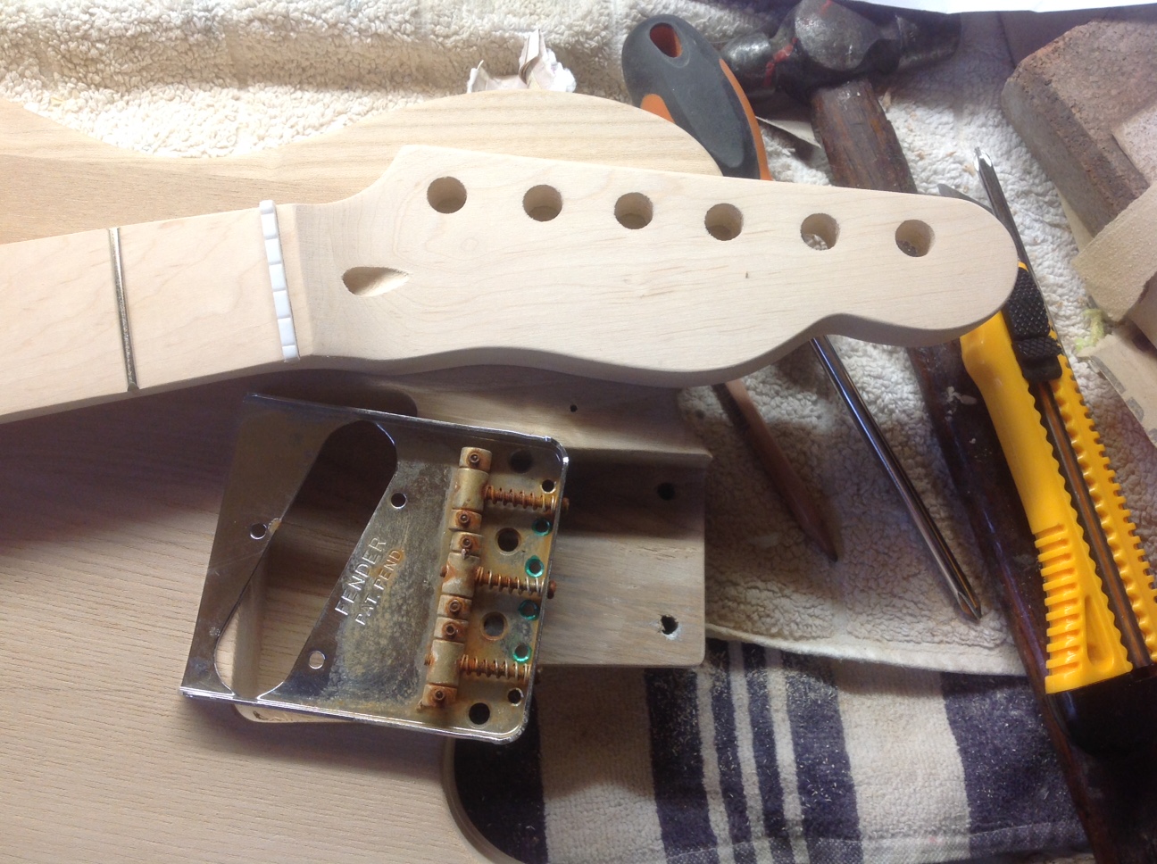

    1,206
    Headstock cut, and I have just dragged the now reliced Fender bridge out of the rusting pot!
