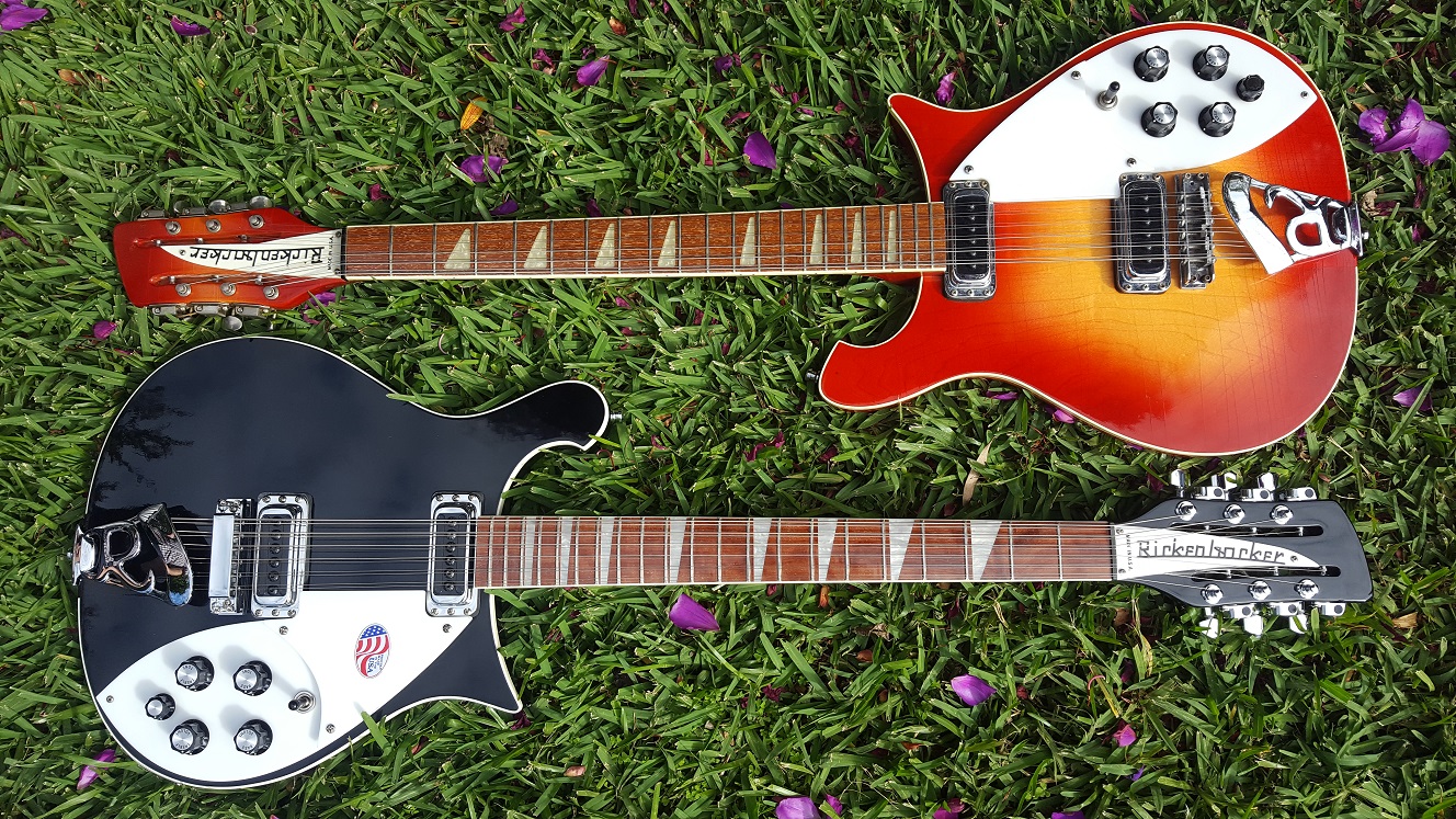

    Funny how interests / hobbies can take hold. When I took up with Mrs Cork Sniffer back in 1969 she was 16 and could knock out popular tunes of the day on her acoustic, I listened but hobby wise did other things. Move forward to about 1992, our son took guitar up and as kids do he became proficient quickly. It wasn't until 3 or 4 years ago that THIS old man decided to join the (guitar) family. Old men take for ever to gain the most modest playing skills :-(
    Photo, her favourite guitar 1980 620/12 taken the day my boy got his 2017.
    Attachment 26787

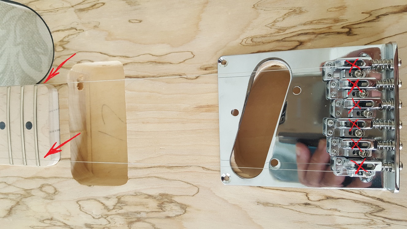

    The factory butchered the neck pickup rout. I'd check that the provided bridge is going to allow you to set up the strings evenly. My 12 string ST has similar bridge pieces and I'm at the point of converting it back to a 6 string and keeping the neck to use on another guitar build with an aftermarket 12 string bridge of a different style.
    Thanks for your comment.
    Is this what you are referring to?
    Holes in body lined up with holes in bridge (red X's) leaved strings offset on the neck.
    If so it looks like an easy fix. Plug the body holes and move bridge south then re drill.
    Yes??? Hopefully :-) or not :-(

    Yeah that should work - I messed up mine on the first pass, but it was easy enough to plug and re-drill. Annoying for you as its come form the factory like that. Are you going with a scratch plate on this? I'd also check that fit and how the bridge sits in it before re-drilling.
    I've developed a habit now, over the previous 3 builds to get it PLAYING first. Then surface finish. Then fiddle with it to make it feel and sound just right. The plan is if I can get a neck pickup fitting in a tidy way then no scratch plate. Later today I'll investigate possibilities of a Jazzmaster pickup.
    What do you mean by "how the bridge sits in"?
  10. #20
    I think Sonic means how well the bridge then lines up with the cut-out in a standard Tele scratchplate, as the position of the scratchplate is determined by the neck, which it fits around closely, whilst the bridge should be 2-3mm away from the edge of the bridge cut-out but centrally located within it.
