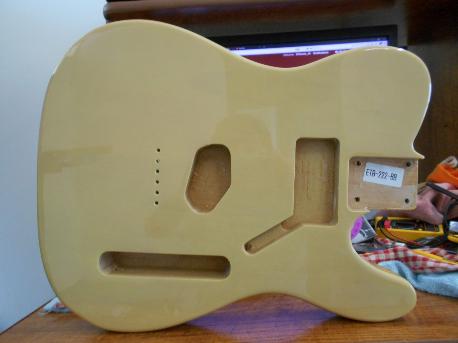

    I'm currently in the process of getting together all the bits and pieces I need to build a custom Telecaster for myself, now since Darwin's weather isn't very conducive to building guitars, I decided to forego doing the finishing-work myself, and opt for a pre-finished Telecaster body, finished in Butterscotch Blonde, which I bought on eBay, here's a pic of the body:
Name:	Tele Body 1_resized.jpg

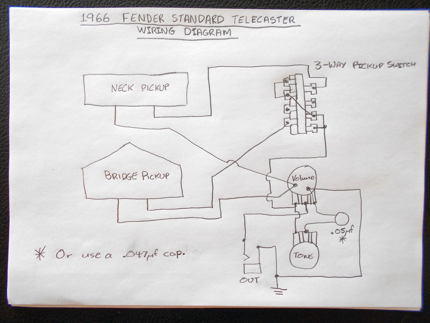

    After putting some thought into how I'm going to be wiring-up the electronics of the custom Telecaster, I had a look through all the Telecaster wiring-diagrams in my Guitar Player Repair Guide book, I bought from Stewmac, and opted to wire it up same like a 1966 Fender standard Telecaster.
Name:	1966 Telecaster Wiring_2_resized.jpg
