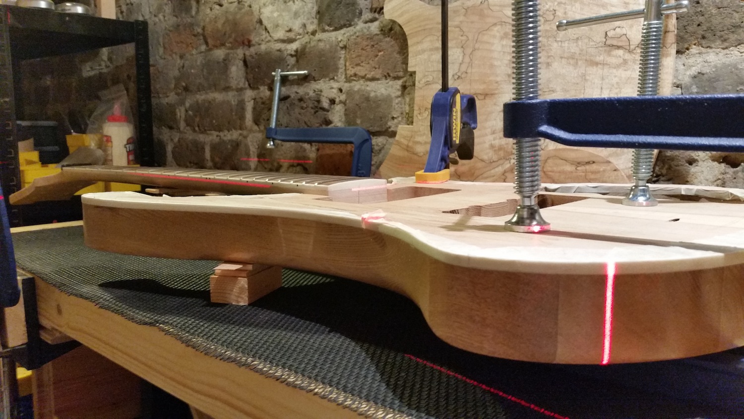

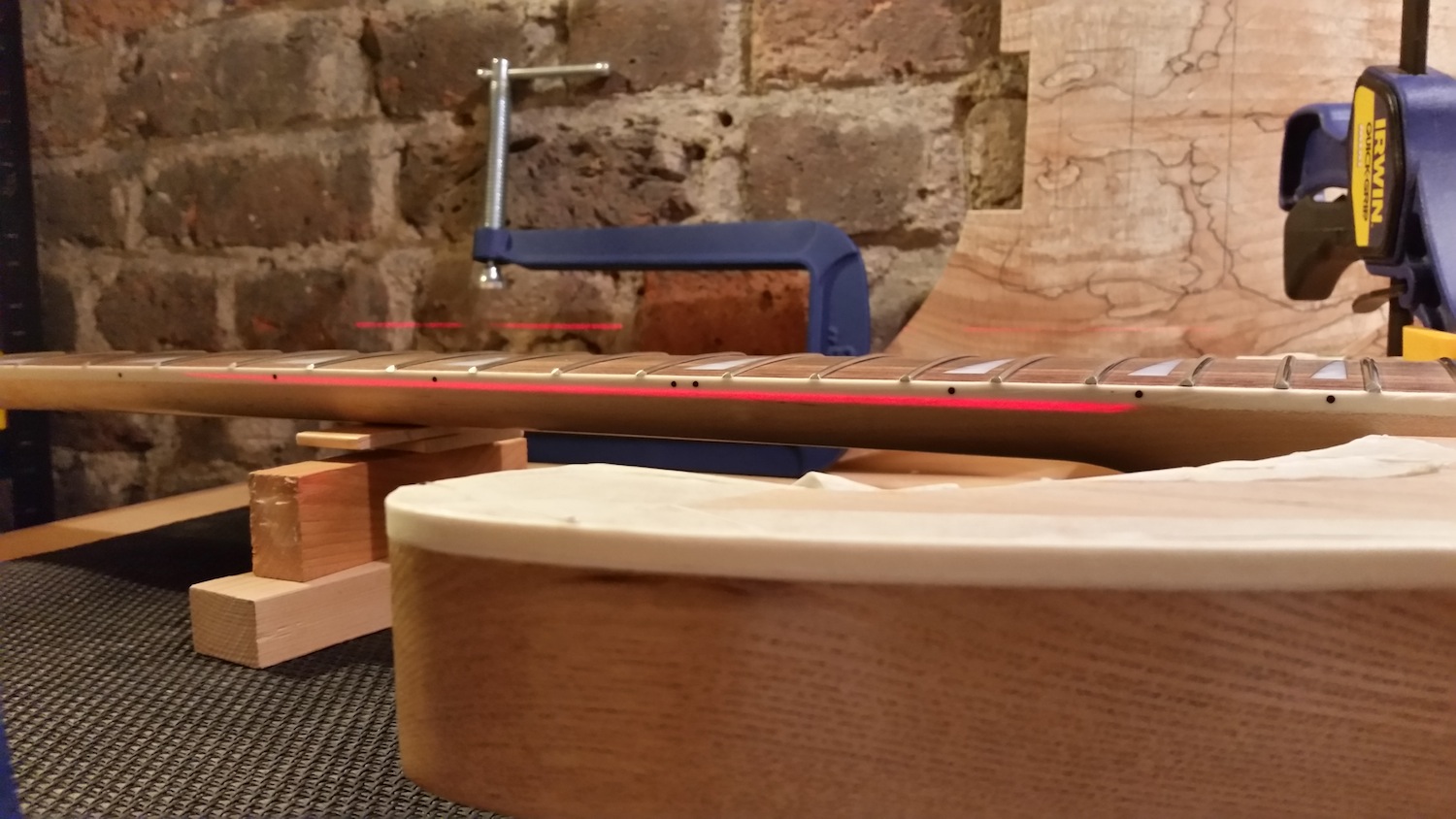

    Neck Setup
    I used a laser to work out the various levels so I could be sure I had the neck positioned how I wanted it. I used the laser to check the level of my bench. Then checked that the guitar body was set level. Then put the neck in place and ensured I had the neck break angle how I wanted it. If you look at the image you might see how small the break angle is. This was so I could fit the GOTOH bridge without burying it in the body!
    You can see the neck is almost flat with the body, but not quite. I could have increased the angle, but I was worried about having to then raise the bridge.

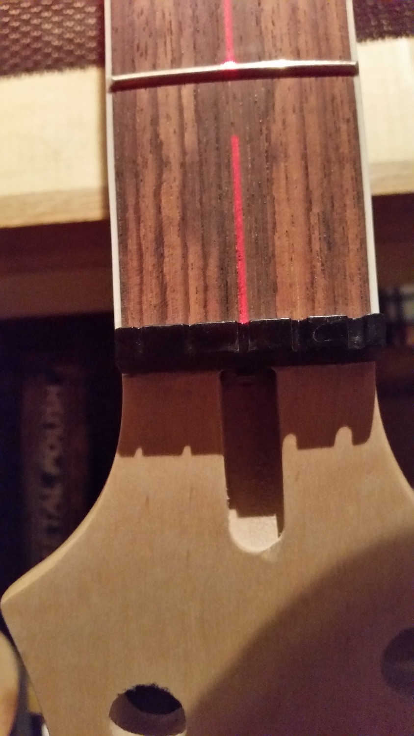

    While I was there with the laser I also checked that the neck was dead on the centreline of the guitar.

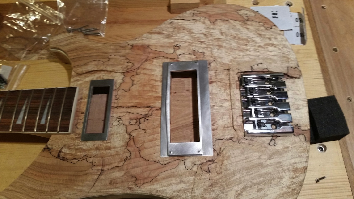

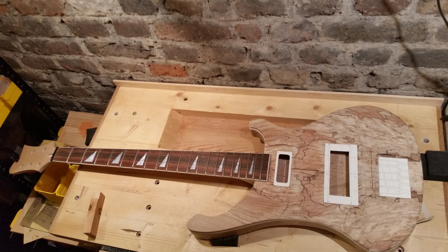

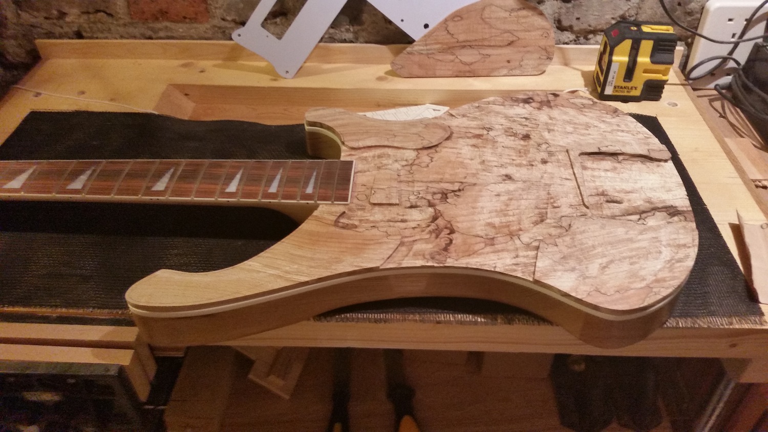

    Mounting the Spalted Maple Top
    I used the shape of the body to provide a guide for routing the top. The more deliacte areas around the neck I shaped by hand with sand paper. I also used a router to get a rough cut on the relief patterm I wanted in the top. I wanted to get away from the completely flat surface of a guitar body and come up with something much more organic.
    A little more routing later, again using the holes already routed into the body as a guide, and I had the recesses for the pickup holes. Note that I could use all the original wiring channels created by Pitbull, so I didn't need to worry about that, apart from the earth wire to the bridge. One carefully drilled hole later...

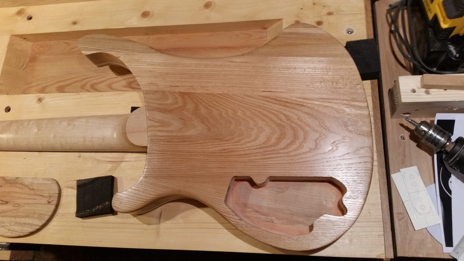

    The Back Control Plate
    Being an engineer, I wanted access to my soldering (or collecting of dry joints if you prefer!), consequently I departed from the original plan and put a cover over the control cavity for easy and frequent access. My apologies to all the people I can here screaming Noooooo! Oops too late!
    I added another piece of thin maple to reinfoce the area in the cavity under the top. I intended to recess the controls so I made sure I have a good 8-10 mm to play with.

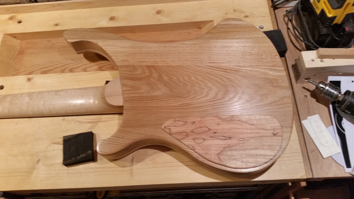

    I then made a cover plate out of the same Spalted Maple, strangely it just looked right to me.
