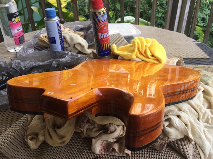

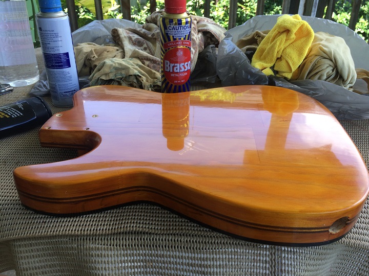

    Hi guys, I am a long time user of Tru-Oil but have used MinWax Wipe-On Poly on a few guitars now.
    I believe Simon is correct (as usual) in that Poly definitely seems to set/cure harder than Tru-Oil. I apply both products in the same manner but it is only when you have finished that I found that the Poly seems to need a lot more work to get that high gloss finish. I especially noticed that on my current build when I left the final coat about a month before trying to get a gloss.
    But you can get a nice gloss from Poly, definitely on a par with Tru-Oil.
    Here are a few examples:
    My last completed build
ID:	26020 Click image for larger version.

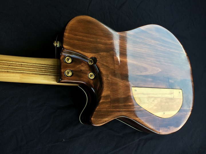

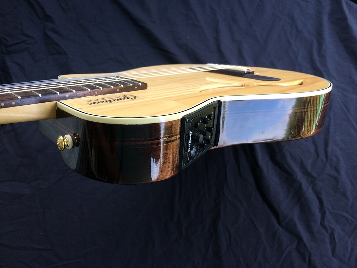

    and my current build
ID:	26022 Click image for larger version.

    Product information in the big green shed indicates poly is one of the harder finishes Simon. Great photos Robin, this choice isn’t getting any easier.

    Looks great rob, I already had some wipe on poly here already, so I might go with that. Cheers for the feedback
