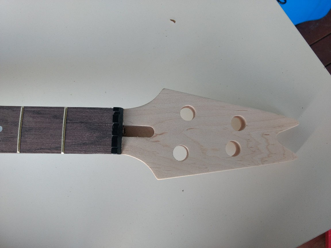

    I am going for the Flying V head with some mods, black hardwear and Coolangatta Gold stain. i must say it is a bit confronting to see the bag of screws and pieces with no real idea on what i am doing, but i will have a look at the videos and take it one slow step at a time. I can build fly rods so hopefully this shouldn't be too hard.... i hope

    Have to agree the back wing has a few irregularities that will eventually sand out. Just need a cork sanding block, 80 grit followed by 120 grit, and keep checking frequently that your sanding efforts keep things perpendicular and 90 degrees to the faces either side of the rear edge.
    3 point bridge is different to the one that came standard on EX-5 and unsure how low or high things end up using one of those.
    Using DT Coolangatta Gold suggests you are somewhere in OZ? Great colour, same as on my EX-1 which can be found under 2nd build in my signature. Need to be very, very patient applying DT to avoid any dramas.
