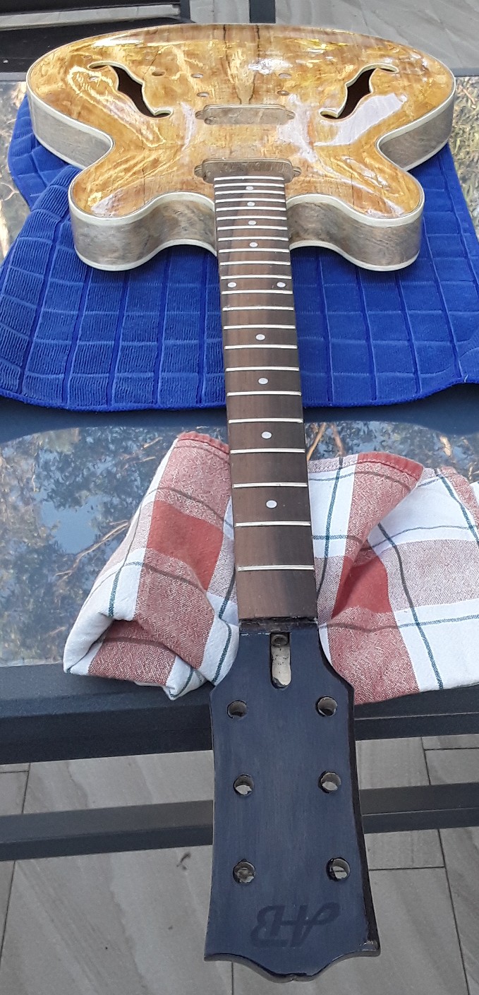

ID:	25788 true oil po,ished with meguiars scratch x used 3/4 of a small bottle
