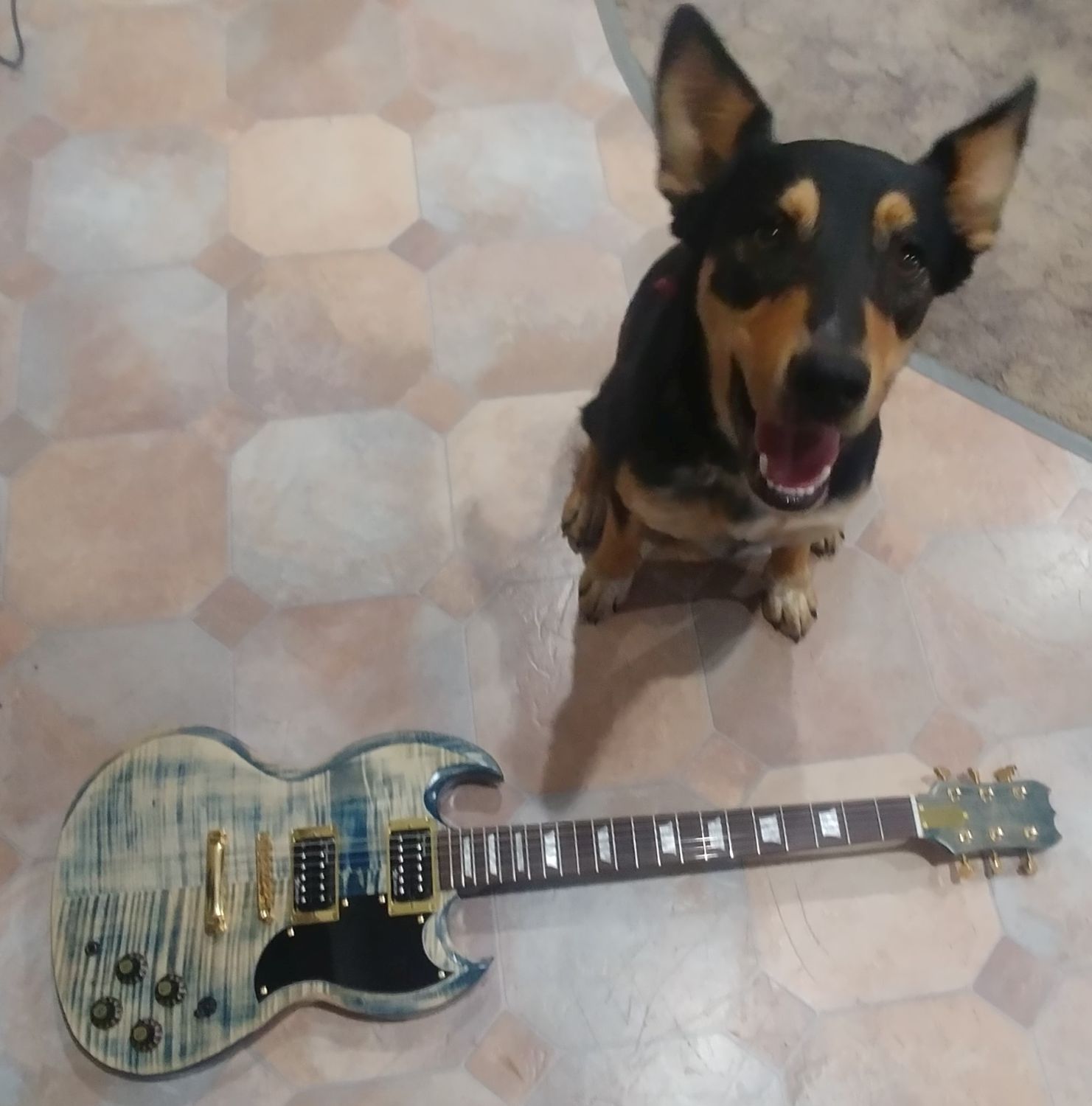

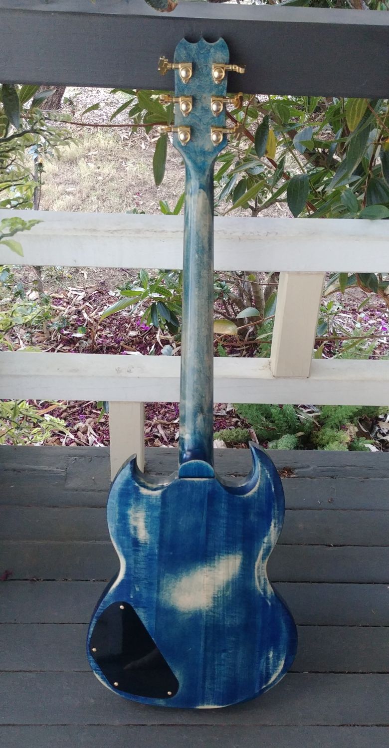

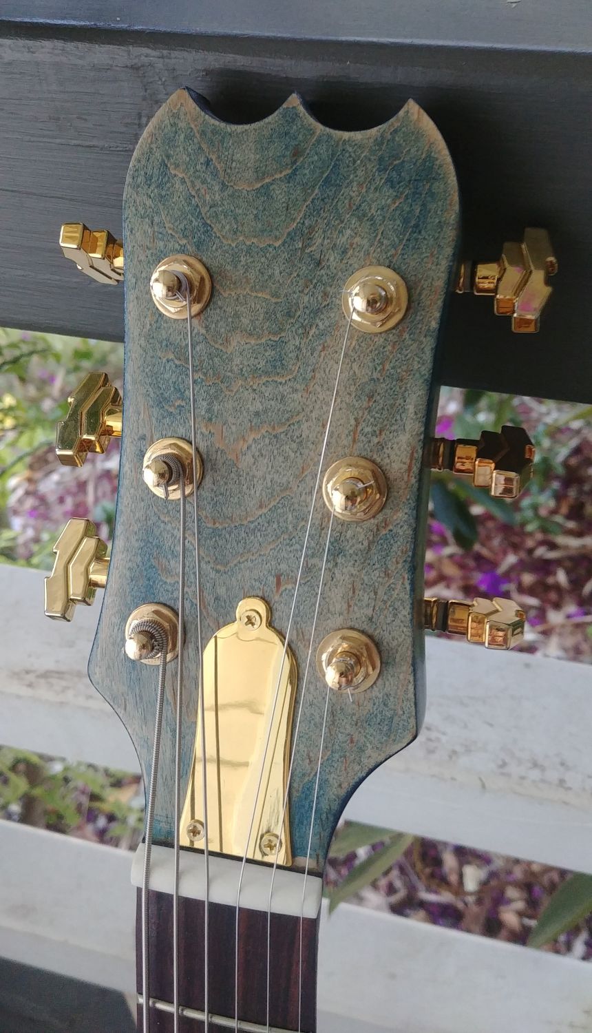

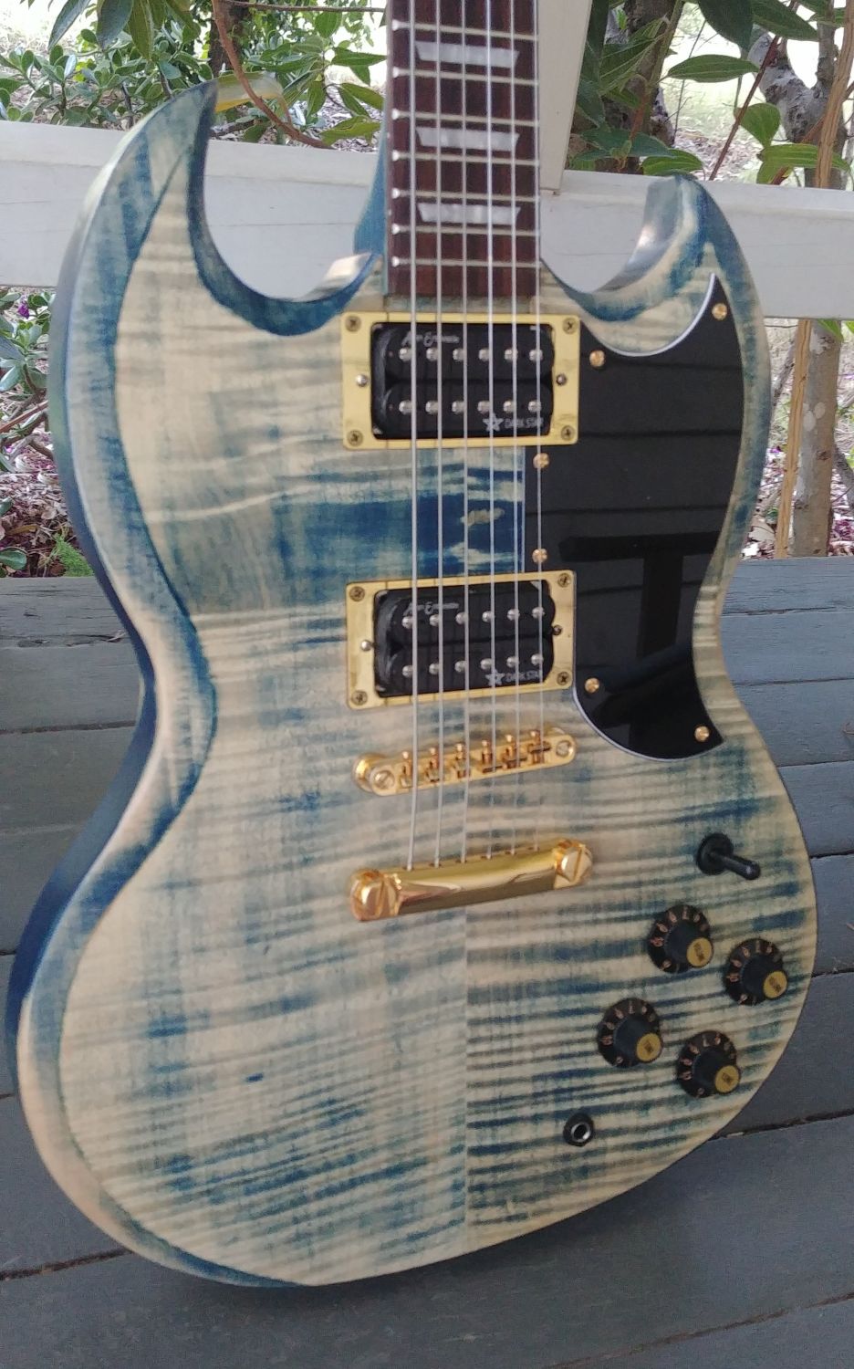

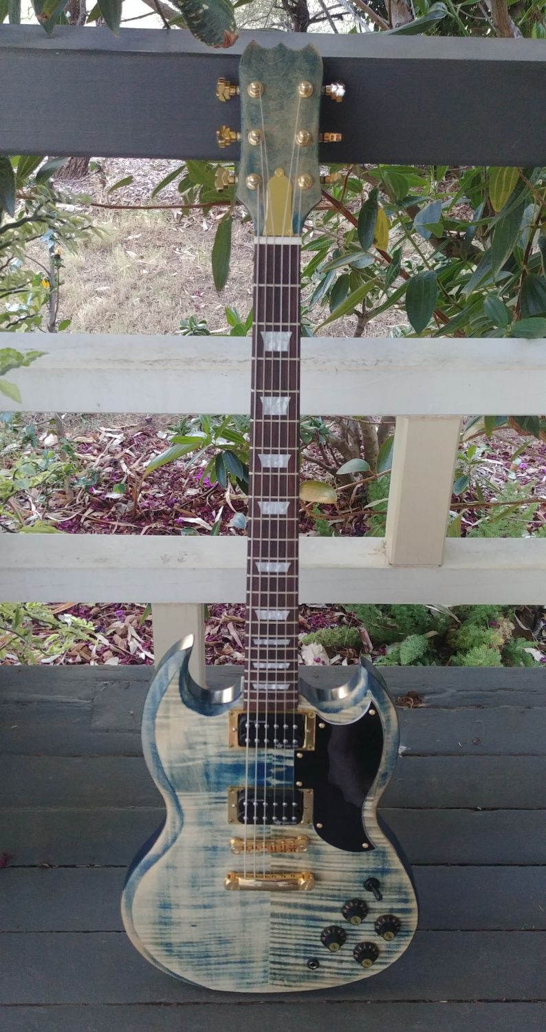

    Hi All
    This one has been a long time coming (I even lost the build diary)
    It is an SG-1F, I have installed Entwhistle Darkstar pickups which are crazy hot, a bone nut, Rotosound 59-11 strings (tuned to C standard), it has push/pull pots for coil splitting and shiny gold bits.

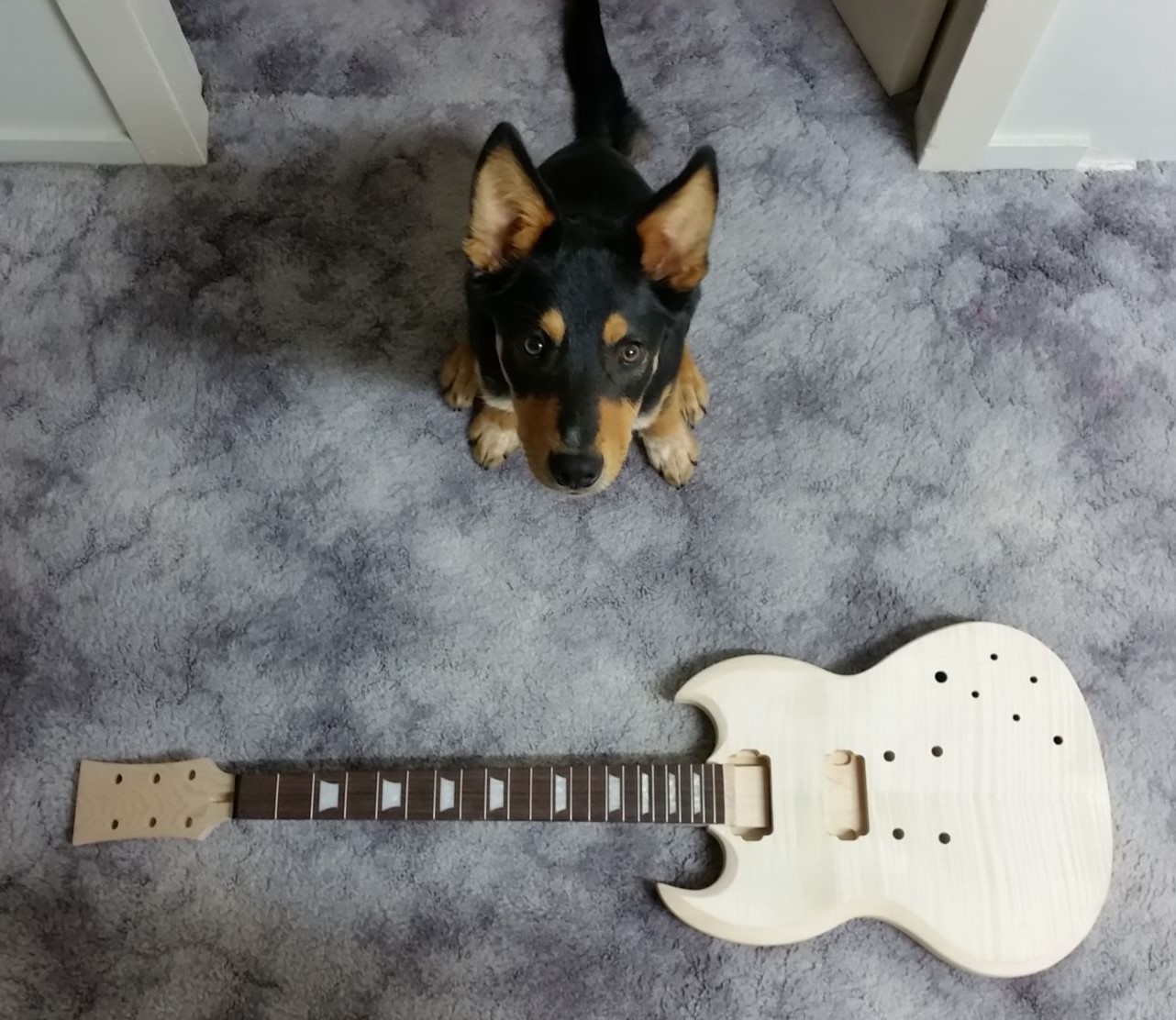

    This is a bit of an indication of how long it took.

    Puppy looks happy that it's finished

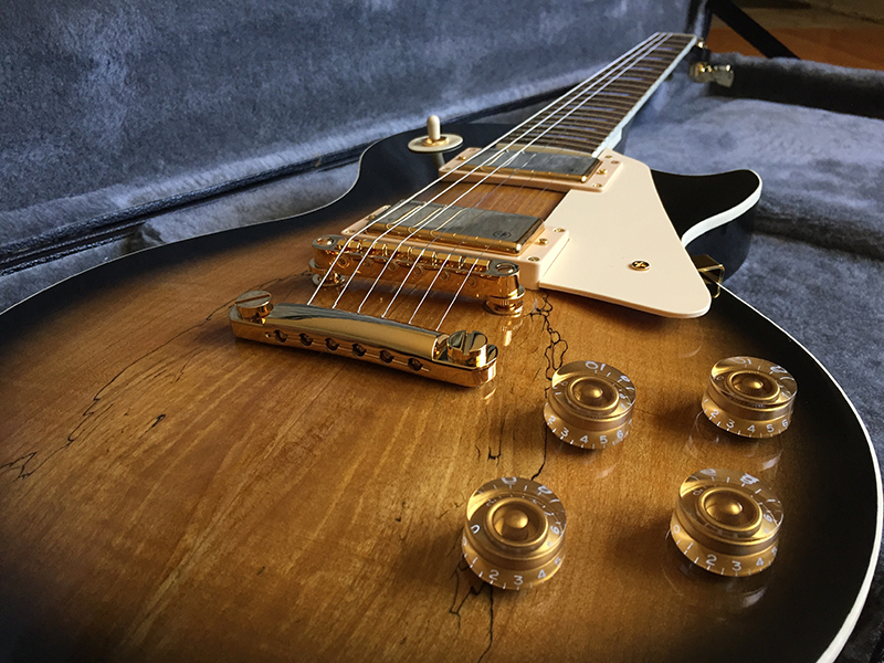

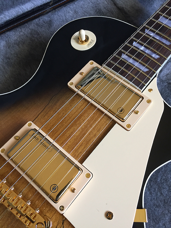

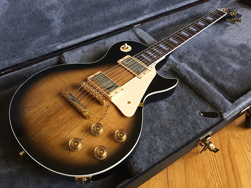

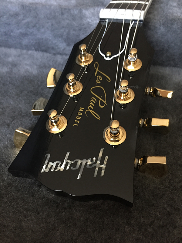

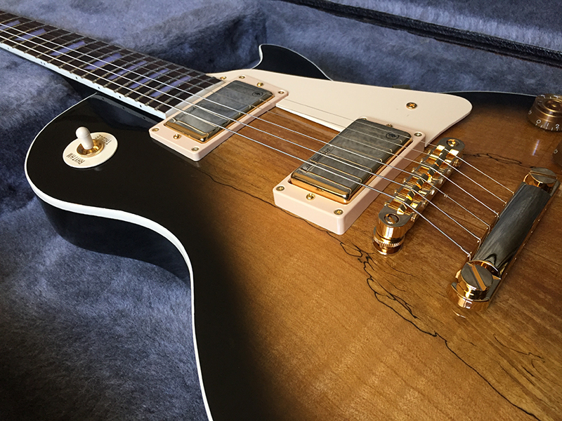

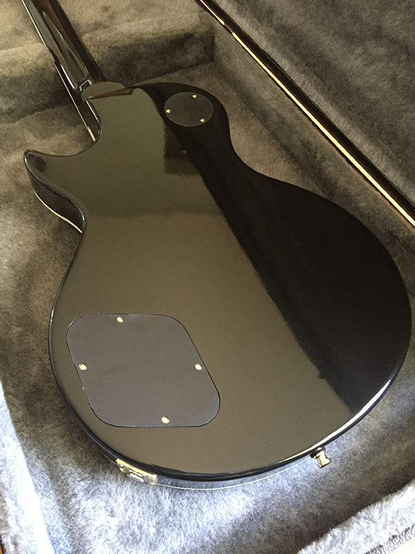

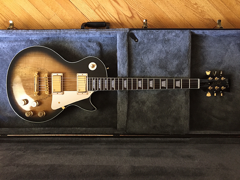

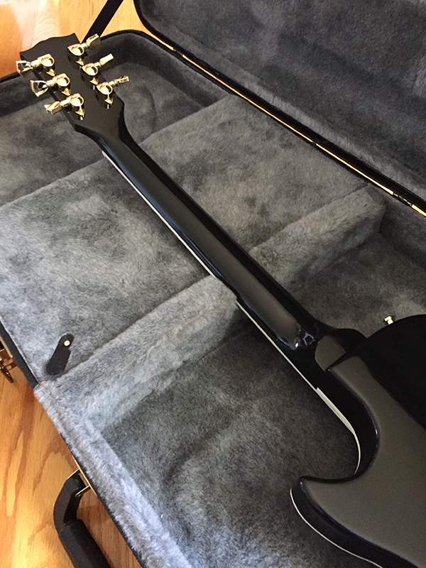

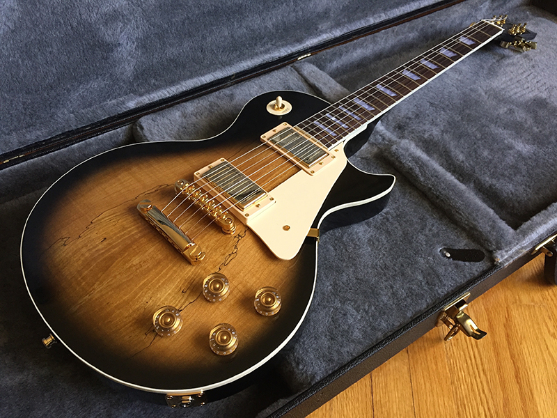

    This month is ridiculous. Beautiful builds everyone!
    It took nearly a year to complete, here is my first attempt at building a kit: the Spalted Maple 'Halcyon' LP-1SS
    It features Lace Dissonant Aggressor pickups, modern wiring and two coil-split push/pull volume controls (no treble bleed)
    The build diary can be seen here: trv's Spalted Maple LP-1SS
    Upgraded parts:
    - Grover Keystone tuners
    - Modified Gibson truss rod cover
    - Graphtech TUSQ nut
    - Switchcraft 3-way toggle switch
    - Lace Dissonant Aggressor pickup set
    - Gotoh Tune-o-matic bridge
    - Gotoh 'Stop' tailpiece
    - CTS push/pull DPDT 500K volume pots & CTS 500K tone control pots
    - Orange Drop .022uF caps
    - Switchcraft output jack
    - Grover strap buttons
    - Various guards, rings, knobs, etc.
    Finish:
    - Minwax Oriental Ginger, Saman Hop & Saman Black stain
    - Sunburst painted with Createx Wicked Jet Black airbrush paint
    - Tru-Oil finish (38-44 coats depending on the area of the guitar, not counting touch-ups)
    - Hand cut celluloid logo inlay
    - Screen printed wordmark

    Here is my first attempt at building a kit: the Spalted Maple 'Halcyon' LP-1SS
    DUDE! This look killer. I love it. Amazing work. The top is so great.
  11. #20
    Holy crap. Rook and TRV, you guys have knocked it out of the goddamned park. Both of those guitars are incredible.
