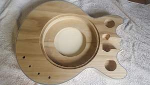

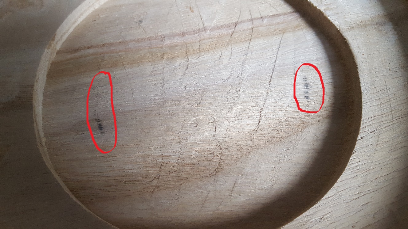

    I've found the wafer thin bottom of the sound hole has warped (been sitting in a hot room), now the cone doesn't sit correctly, it's resting at two places on bottom.
    Given the very thin nature of the material and the cavity between the warped bottom and the ply back of guitar body, is there any reason why I shouldn't use a Stanley Knife and cut the bottom out? This won't weaken the body at all but will make the air volume greater under the cone. Possibly this may give the electric guitar a "slight" acoustic advantage?
    Attachment 25728

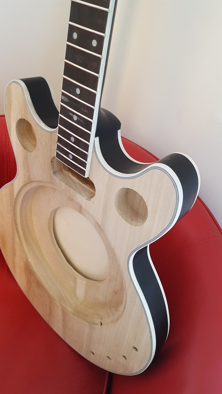

    The second issue, I assume I'll have to drill a hole through the spider to allow the piezo wire to pass through?
    When the piezo sits in the bridge recess I think the wire would have to be bent to an unacceptable level. A hole would allow a less strained cable on it's way to the control cavity.
    Attachment 25729
    I've actually just done this very thing with mine, for a similar reason. My concern was aberrant vibration of the wafer thin wood after i had modded things, so i have scored and gradually cut through to leave a void between the main body section and the rear ply top.
    I have similar concerns about the Rod Piezo sitting funny. Not quite sure what to do about that just yet.
    Glad we are thinking similarly, with that reassurance I'll open the bottom up to the void.
    Re the piezo, from what I've seen online the timber bridge supplied is too thin. I get the idea it should be a close fit into the spider, mine flops about. I think I'll make one that fits more snugly and after a little more consideration drill a hole through the spider to get a relaxed track for the wire.

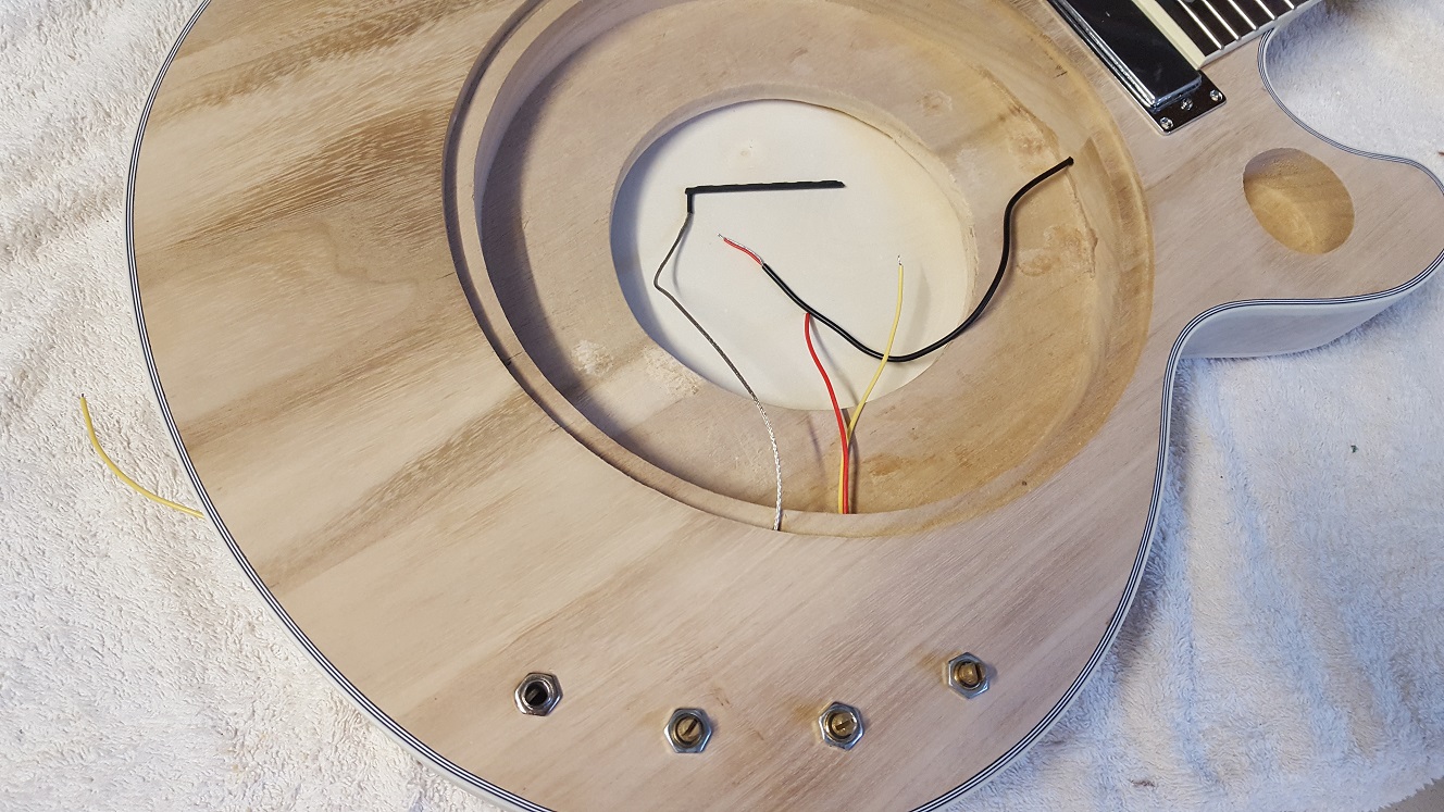

    Bottom cut out from inner body, all good!

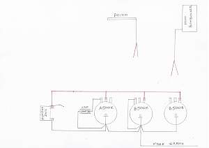

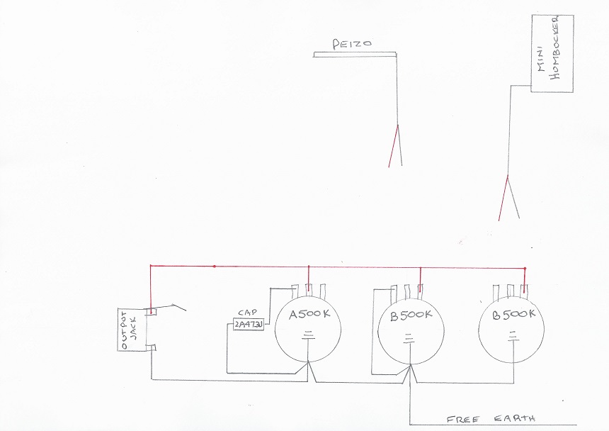

    I'm lost with the pre-wired pots. I made a sketch of what they supplied, can anybody tell me how to connect the mini-humbucker and peizo?
    I understand two options are available,
    1, use wiring supplied then out to an acoustic pedal. If somebody can fill in the gaps on my drawing to do this I'd be grateful.
    2, find a SMALL acoustic pre-amp and fit on-board. Preferred option but without one at hand no point asking about wiring.

    Hi CS, I’ve been trawling through t’Interwebs looking for resources on this. I found some interesting stuff here: http://handmademusicclubhouse.com/ph...ams-schematics
    which outlines some basics, and does include one reference to wiring in a pre amp. I’ve been looking for some alternatives on the on board, but so far coming up empty on a standard unit that satisfies my idea to edge mount it. I’ve got a couple of options to consider that might be modifiable to do what I want.
    Thanks, that link looks like it covers the basic problem BUT please keep me updated re the "on board" explorations.
    I've reached out to a few people both here and in the States for ideas and will happily pass on anything that looks good.

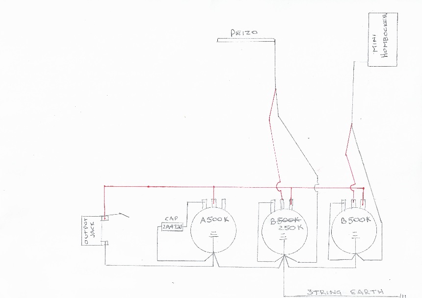

    A well respected US contact has upgraded my drawing ...
    He assures me this WITHOUT a pre-amp will work well, two volume pots to blend peizo and mini humbucker. He said being a resonator and not a smooth sounding high quality acoustic the lack of pre-amp is fine.
    If a small affordable pre-amp turns up before I wire it I'll fit one (and can retro fit later) but for now I'll set the neck and work with the attached plan in mind.
