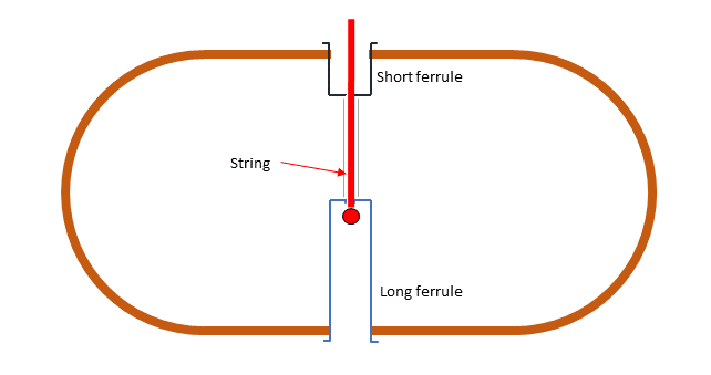

    I'm sorry, but that was bad advice you were given. You'll need to fit them the other way around. The 'long' ferrules are only sized for a bass string, not the ball end. So if you fit those on the back, the ball ends will stick out of the body rather than fit in the large recess of the 'short' ferrules, which means that the total string length would be even longer than using the 'short' ferrules on the back. You'd also have the ball ends exposed witch is going to be rather uncomfortable for you.
    Don't panic though. The bass has a 2+2 headstock design, not a 4 in-line headstock. Bass strings have a lot of extra length on them as they have to reach the last tuner on a 4-in line headstock. You will be adding some extra length, but in terms of overall length, you should be fine as the longest run on your bass will only have to reach the A and D tuner positions.
    Bass strings are suitable for 34" and 35" scale lengths, and the typical wound length is normally between 36.5" and 37.5", then as long as the overall length of the run for the wound part of the bass string is less than 36.6" (so you've got at least 2"/5cm extra) then you should be OK. I have a Lakland P-bass with rear stringing and I don't have any string length issues. The kit comes with a set of cheap strings, so why not use them to see what extra length you have spare on the string with the end of the wound part just past the nut.
    You can always countersink the rear ferrules into the body by 1 - 2 cm or so, to give you a bit of extra length. Drill the 4 string holes all the way through the body, then drill out those holes to the diameter of of the smaller part of the ferrule to maybe 2.5cm (or whatever you feel you need) deep. Then drill out those holes with a drill that's the same diameter as the ferrule lip by 2.5cm - the overall depth of the ferrule, then push the ferrules into the holes. Don't drill the holes so deep that you can't fit the top ferrules into the body, so measure the body depth first, and then compare it with the depths of the two sets of ferrules.

    @ Simon : I think I wasn't clear (in english !), sorry about that.. what I'm about to start is :
    1 : drill 4 small holes (Diameter 6)
    2 : enlarge with diameter 10 on top and on the bottom
    3 : insert ferrules as diagram below:

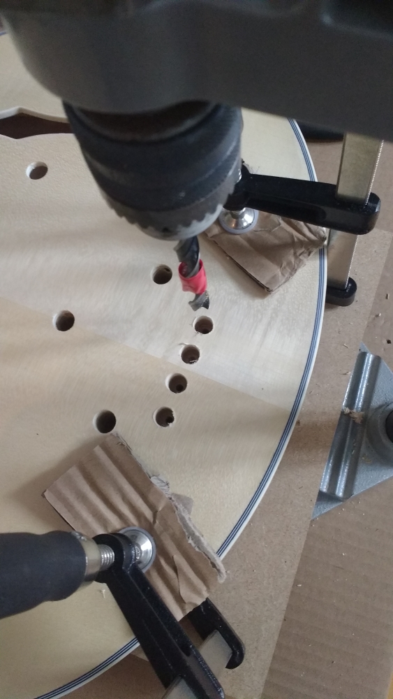

    To be honest, to drill a 300€ body was a huge stressful experience.. And, of course, everything isn't perfect but I don't mind : I'm more interested by the sound than the look

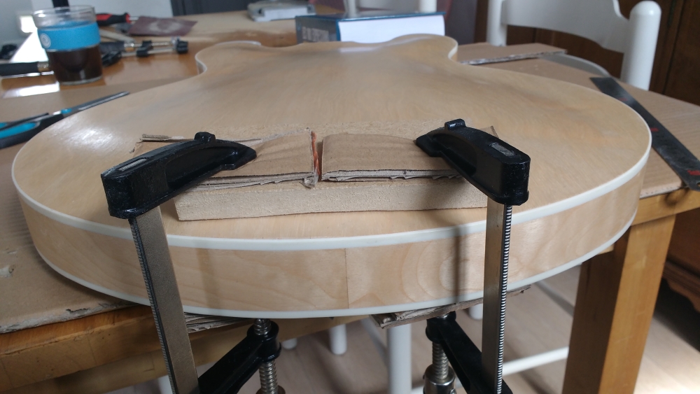

    First, I dug (dig ?) a piece of wood to make it fit on the back of the curved body, to avoid the wood to crack when the driller will go thru :

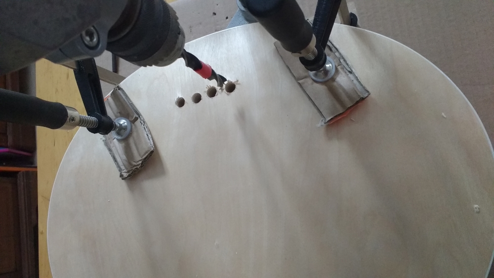

    Then I drilled, first with a small diameter (biggest string). Somehow the body moved, so the holes aren't perfectly aligned.. but the bigger ones will fix it (maybe !) :
    And so, small holes were visible on the other side.

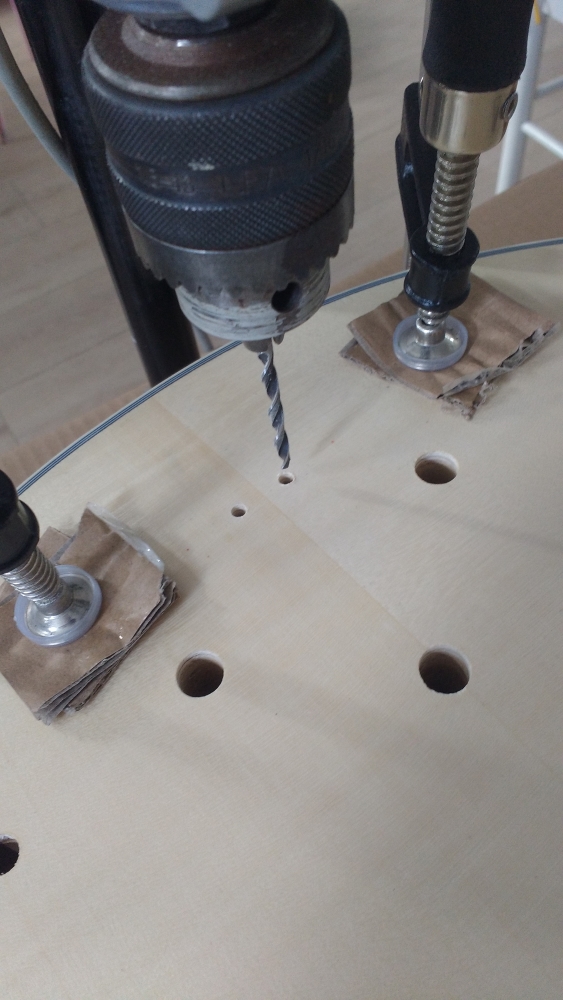

    Now, time to drill with the ferrule's diameter (10).
    Unfortunately, it destroyed some wood around the holes.. I'll sand this later.
