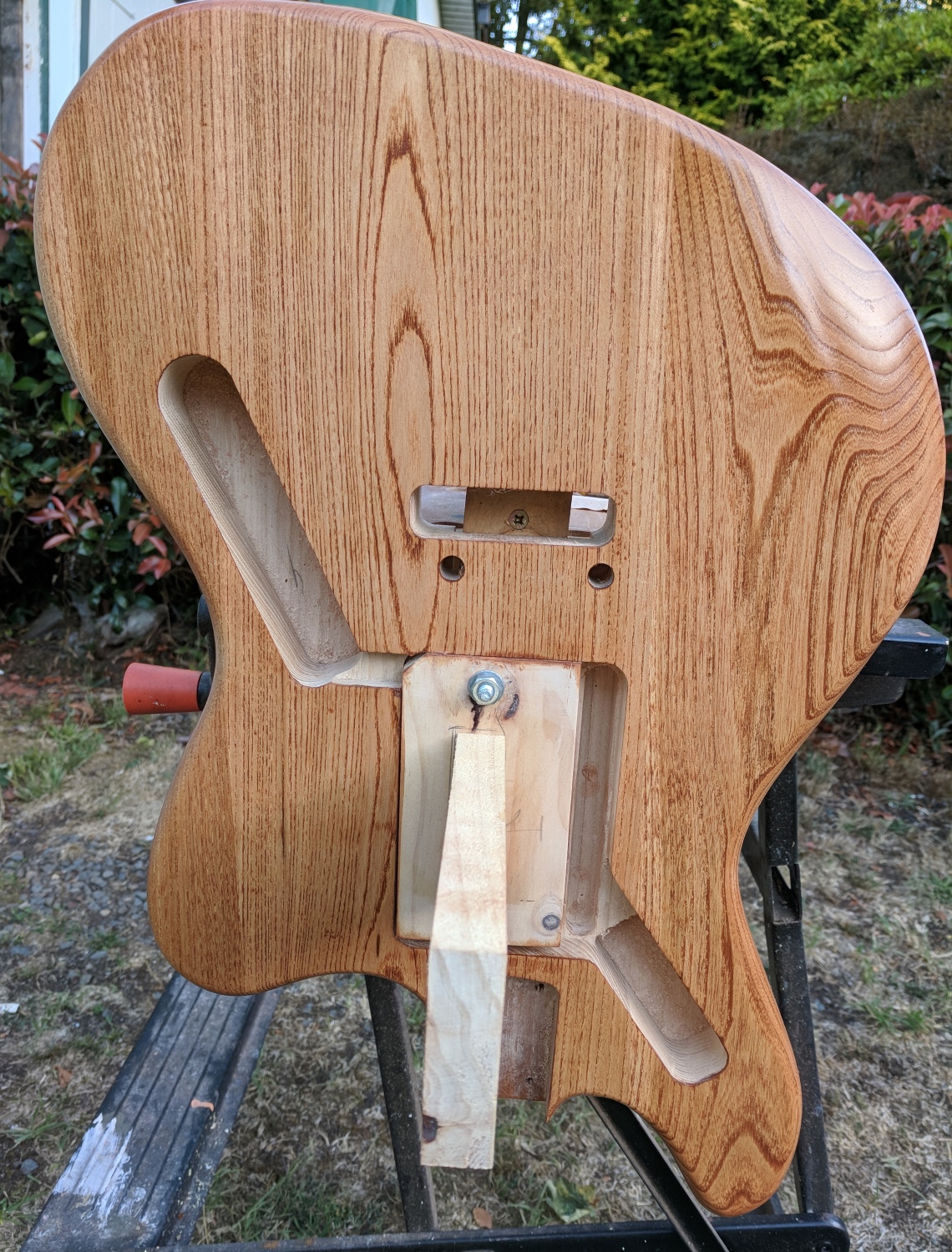

    Thanks for the suggestions guys. I followed DB's advice and now have a much better looking body.
    I actually sanded a bit more aggressively than "light", especially on the top and bottom, because the blotches were somewhat persistent but also to get a more even base tone in preparation for the fourth coat of stain. I have since applied the stain coat plus two coats of intensifier, picking warmer days to do this. I'll know tomorrow if a 3rd intensifier coat is needed.
Name:	After I-Coat-1_2.jpg
    I think some of my previous troubles arose from applying stain back in October/November last year when the air temp was a lot cooler and humidity a lot higher. I also may have misinterpreted what was said on the instructional video because I let individual coats of stain dry before applying the next and it looked suspiciously like coat 3 dried on top of coat 2 without really soaking in. [This time around I followed the written instructions, not the video]. The other thing I observed this time was that the prescribed follow up rubbing after stain application helped eradicate places where the stain subsequently started to pool. I went over the body two complete times after the initial stain pass and the diligence paid off.

    Tbe second coat of intensifier took a lot longer to dry/cure. The Body now has a generally uniform glossy skin but tbere are a couple of places where tbe grain lines are presenting surface fissures. Is this a sign that I need a third intensifier coat ?
    (I'm otherwise happy with both the grain and colour as is )
    Sounds like a light wet sand with 1500 wet & dry is required then another thin intensifier coat.
