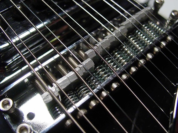

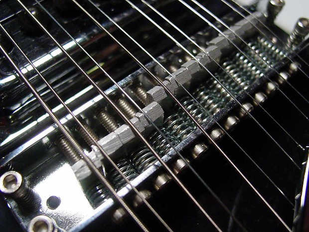

    If you have a look at this picture of a Ric 12-string bridge, you can see that the notches aren't central but offset in pairs, to get the correct string spacing but still have individual string intonation available. You may be able to re-notch your saddles. or you might need some new ones.

    I'd use a triangular needle file to put a V-notch in the saddles. Alternatively the Gibson way to notch the saddles is to put the strings on the saddles in the required position then hit each string into its saddle with a hammer. New strings then get fitted before the guitar leaves the factory. But that's an expensive method as 12-string sets aren't cheap.

    hi Simon, in this pic the strings in sequence appear to go thick thin - thick thin etc, wheras pabs pic above is opposite?
    is there a standard or does it not matter and just an option? maybe a lefty? never seen a 12 in rl myself, interesting thread.
    guitar looks very nice btw Bill
  8. #18
    Rickenbacker use a reversed string pattern to the normal 12-string arrangement. It's one of those things that help give the Ric 12-strings their very jangly sound. Very difficult to nail it with a normal thin-thick pattern.
  9. #19
    Rickenbacker, for reasons best known only to them, have always strung their 12 string electrics "back to front". Conventional wisdom is that the octave string is above the standard so that all strings will ring out properly when you downstroke a chord. All other major guitar companies use the octave above standard configuration.
