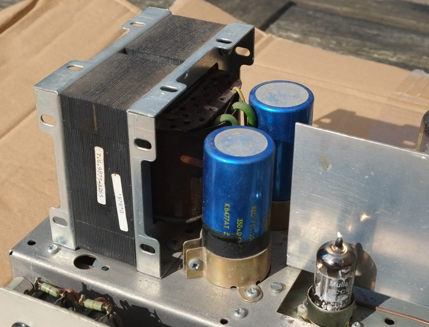

    Well, a quick search for the transformer part number seems to indicate that it is a proper Sound City transformer, probably by Partridge - though this only comes from one hit on an eBay seller in Spain. The part number is T.G. 9875-A265.
Name:	Amp transformer 1 small.jpg

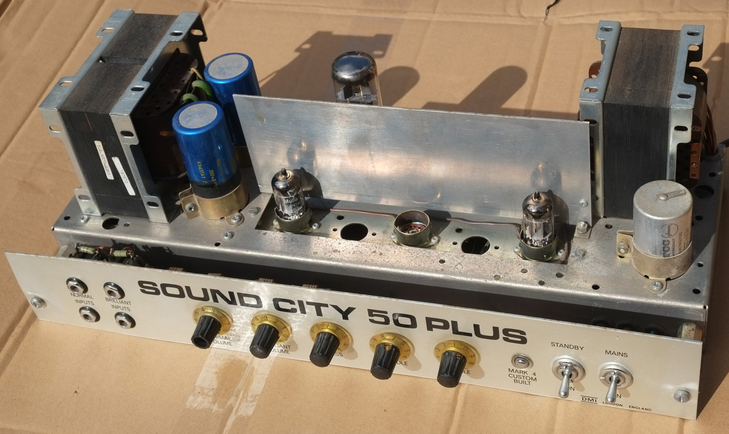

    Here's the front of the amp chassis (some valves removed at the time):
Name:	whole amp chassis 1 small.jpg
    And the back. The PI valve sits between the two EL34s. This is a later arrangement as the PI was originally the other side of the metal shielding plate with the other pre-amp valves:

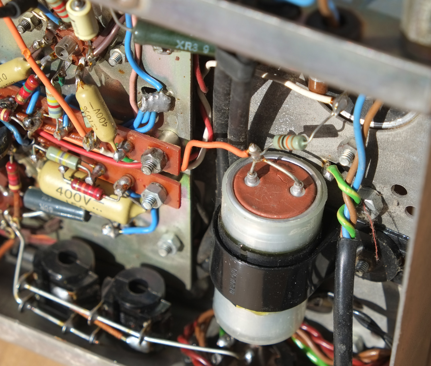

    Here's the only really suspect cap I could see with obvious cracking (though no leakage):
Name:	suspect cap small.jpg

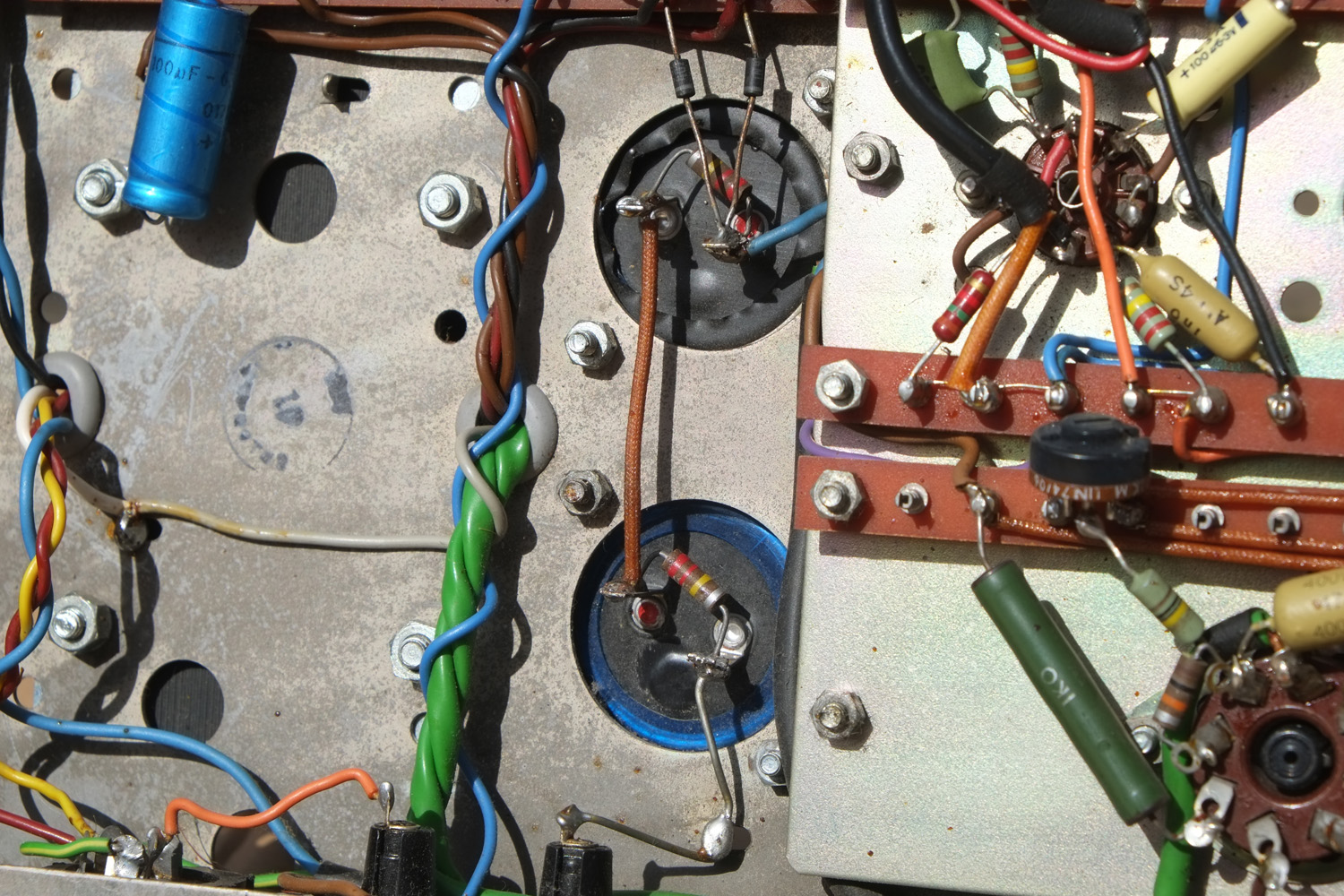

    Here's the bottom of the two main smoothing caps. They both seem to have a small bubble in the rubber/plastic covering, so I'm not sure if that's normal or not.
Name:	smoothing cap underside.jpg

    Nice photos Simon.
    By the looks of it I doubt the transformer has ever been replaced. And the caps look good enough to give them a chance. The dimples on the caps appear normal and are often found on these type of caps, and they are often included as a designed weak point to allow any internal over pressure to escape.
    Based on these photos my educated guess from the other side of the world is that the thermal fuse in the transformer has let go. Be it an actual over temperature event or simply age related fatigue there is nil way of telling and your only option is to replace it, which looks to be a simple enough job to do...
