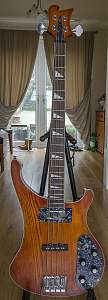

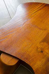

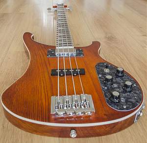

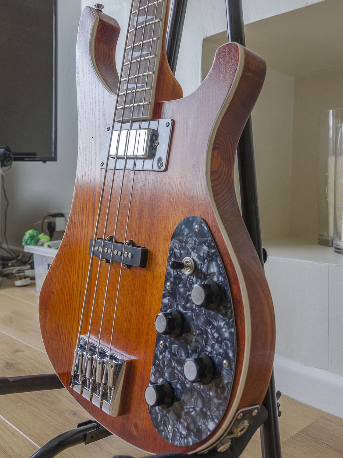

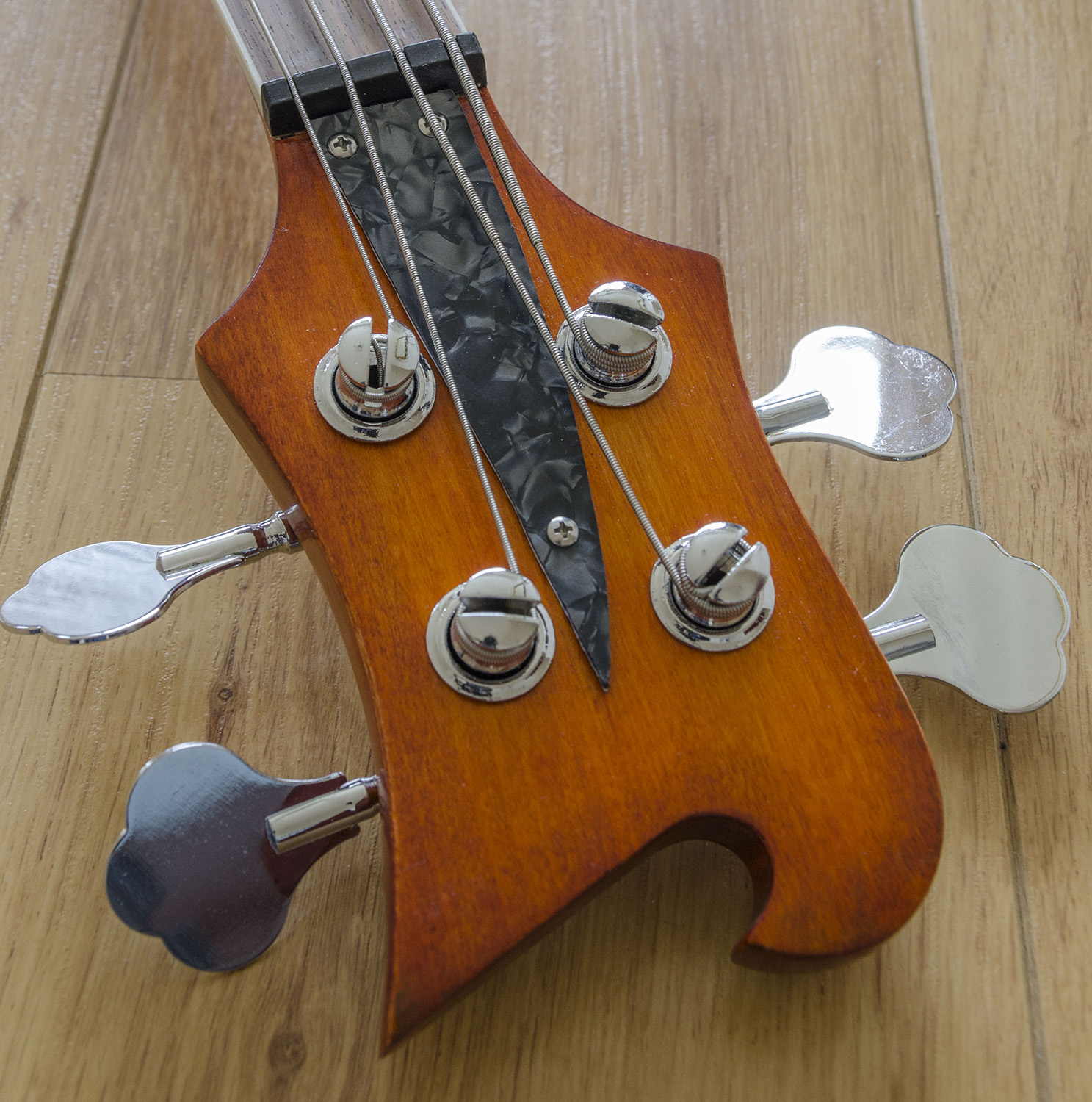

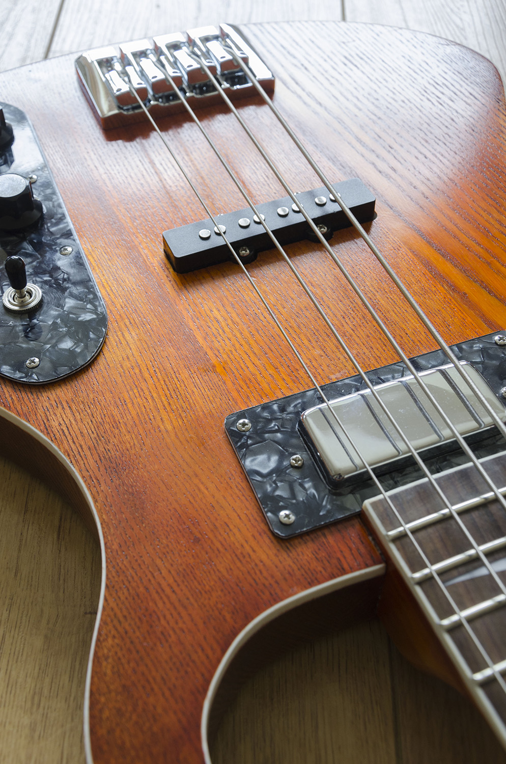

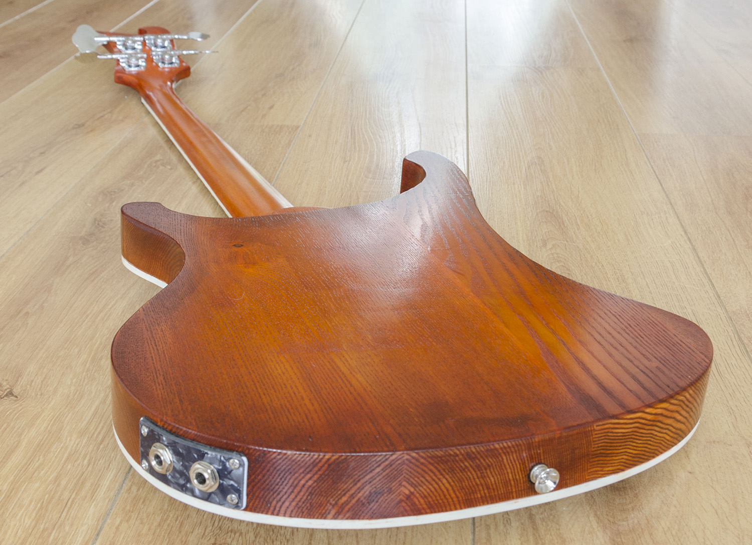

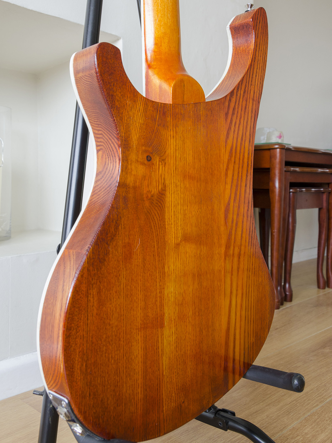

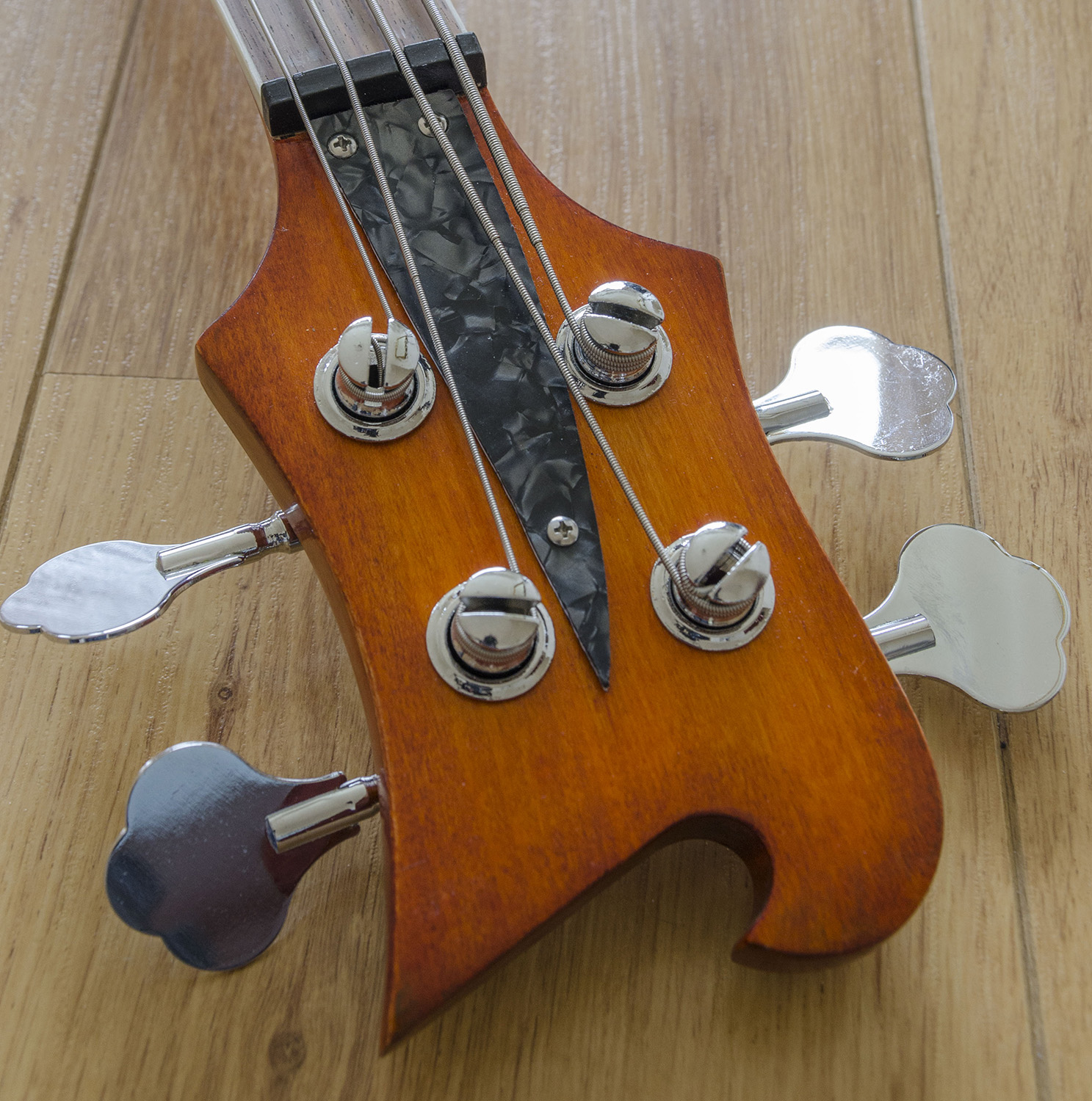

    I will throw my RCA-4 bass into the mix.
    Finish - Sanded down to 240grit and stained using Wudtone Burning Sky and Hot Auburn
    Neck - Frets levelled and dressed using similar methods to those mentioned by Ahabs_beard
    Hardware - Tuners as supplied with the kit. Bridge a 'no-name' item from ebay that I liked the look of. Control cavity cover, neck pup surround and truss rod cover I made myself.
    Electronics - Pickups as supplied with the kit. Wired for stereo with new pots, caps, switch and jack sockets.
    For those who don't know (and I didn't properly understand when I set out on the build) the bass has two jack sockets. One mono which works as normal and one stereo which separates the outputs from the two pickups then using a splitter cable each pickup can be run to separate inputs (eg two different amps).
    Build diary is here http://www.buildyourownguitar.com.au...ead.php?t=8183

    RCA-4 Bass

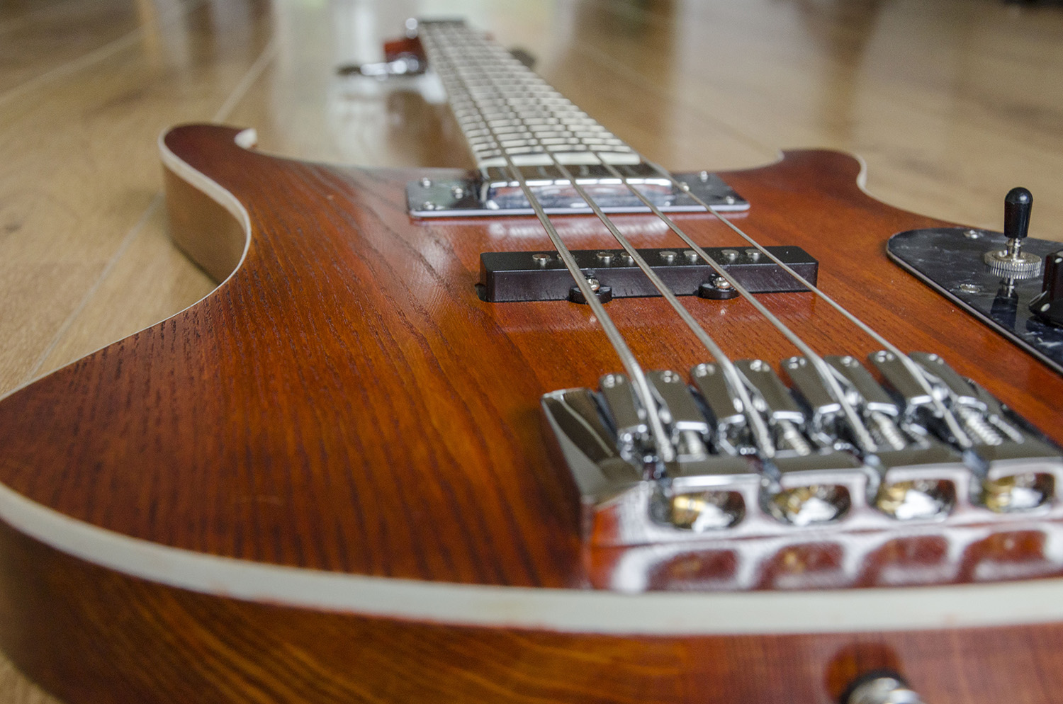

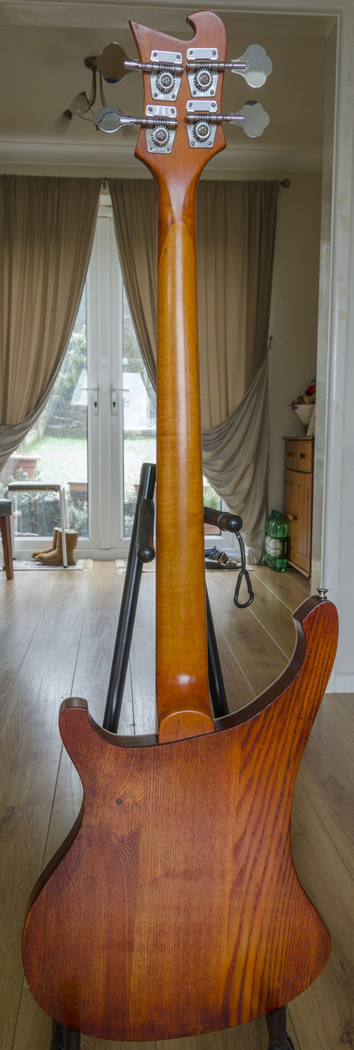

    And a few more pics
ID:	25353 Click image for larger version.
ID:	25355 Click image for larger version.
    Thanks for looking,
    Gary

    Holy crap! And I thought competition would be easier this month - looks like I'm wrong!
    I've always been really apprehensive about buying kits with binding, in case I get the stain over them...
    How exactly do you go about making sure that the white binding stays (or gets) clean?

    Quote Originally Posted by Ahabs_beard View Post
    When I saw your guitar I thought - no point entering this month Same could be said every month though.
    I wouldn't think it possible to do something unique with a Strat but you have managed it!
    I think some people manage to successfully mask the binding but the majority just stain over it then scrape the binding clean afterwards with a blade which gives a nice clean edge.
    It is not that difficult but mighty tedious and certainly in my case gives continued entertainment in spotting bits that have been missed
