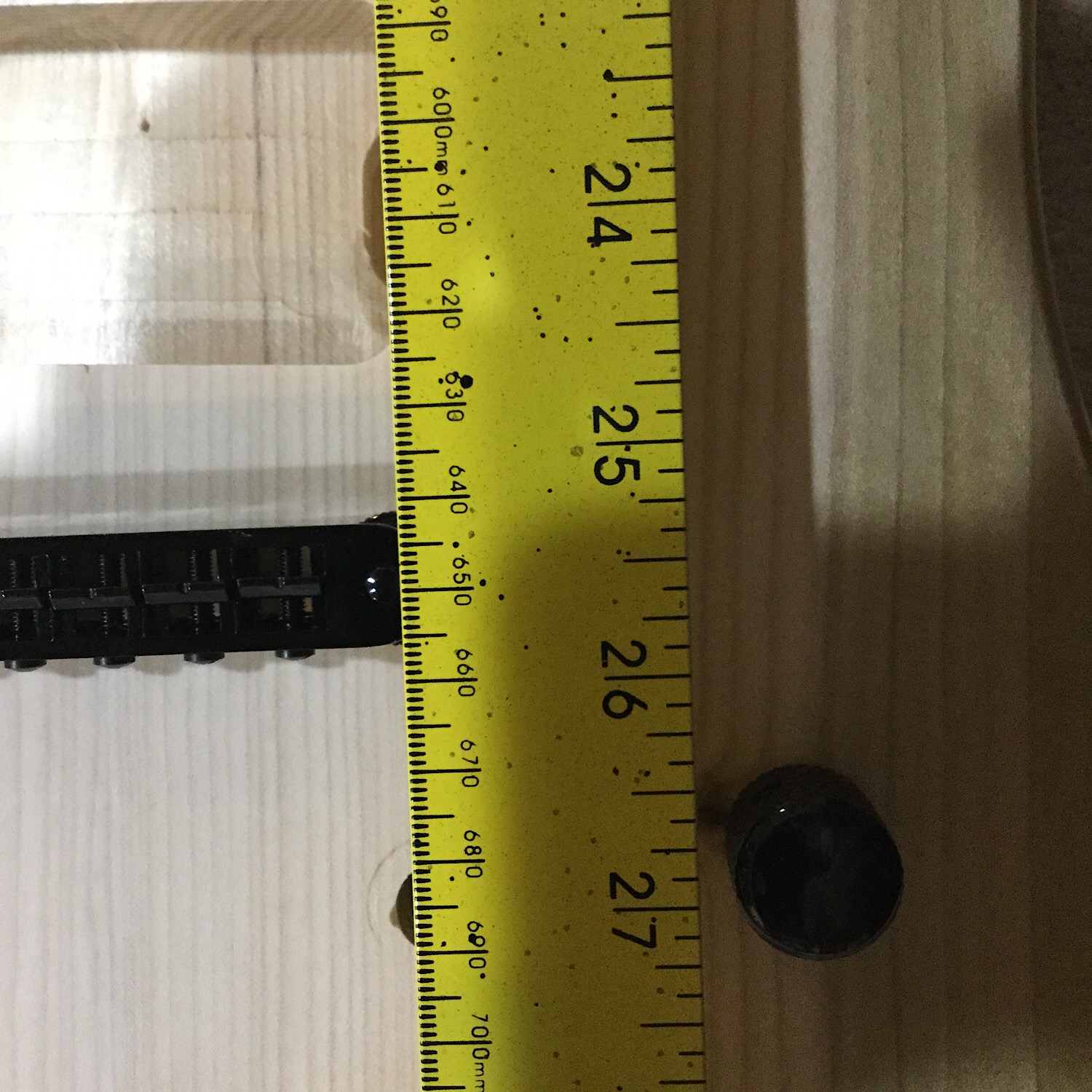

Doing a RD Artist build Neck scale length is 648 mm, nut to 12th fret is 324 mm and length from 12th fret to bridge center is 334 mm on the treble side. When i had this body made I requested 648 scale length is it set to long or made for a different scale. Next question is how to fix if needed remove wood from neck shaft or reroute a longer neck pocket ?
