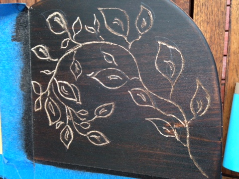

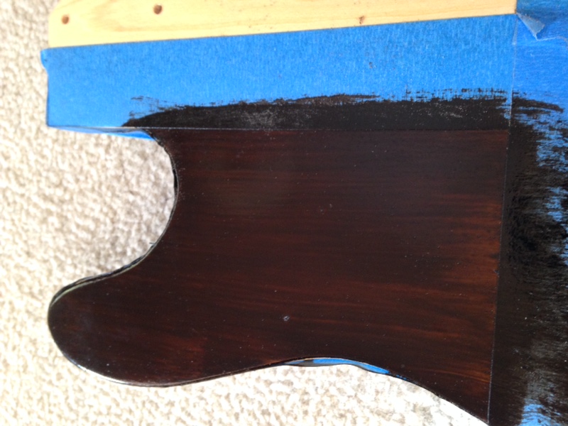

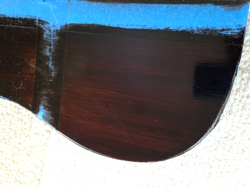

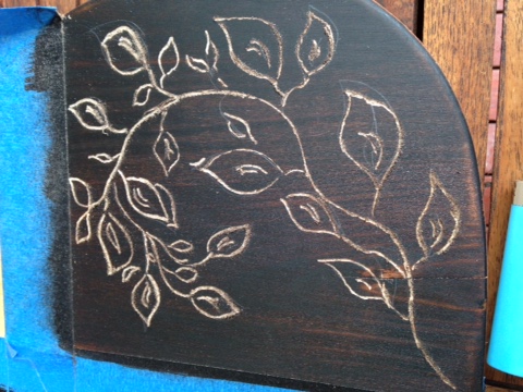

    Ok...so where am I on the build well, firstly been a a tad slack so not much however have been testing techniques.
    Basswood sample.
    Sanded 240 grit then taped into quarters. Why, so can I try test areas to get an idea on result and learnings ....very organised for me!
    Four samples:
    1 - 240 grit sand, shellac (thin coat), light sand, then applied a coat Brown jarrah (brush..not a good brush) - don't mind a bit of the hue of shellac coming through however will need a further light sand and diluted coat of stain before approaching any final finish layers.
    2 - 240 grit sand, proof sealer (now did a sand on this - some say don't but I opted to) coat of shellac, light sand, coat of brown japan (brushed on)
    For each of these there will be quite of bit of sanding required to achieve a very smooth finish and invest in a good quality brush or using of a lint free cloth for application.
    3 - 240 grit sand, tint directly applied (far out this wood is like a sponge), light buff then...yep tried a rough free hand dremel. The wood doesn't have too clunky a texture to dremel on however steadiness of hand is needed as the wood can burr a bit. Haven't done a light sand over yet.
    4 - 240 grit sand and then boiled linseed oil..(oh I did place this section over a flame to see if it would enhance colour and texture of wood..was marginal.

    I'm guessing that you are using Feast Watson stains, so yep, Basswood totally drinks that stuff when applied direct, but thankfully it doesn't usually drink it too deep.
    Love the dremel work. Hopefully you'll be able to seal it in like that without the stain drifting into your crafty artistry...

    Thanks Marcel ...I couldn't believe how the wood soaked the stain up (Feast and Watson)...going to try a few other stain colours and techniques as thinking the dark stain may be too heavy, mind you I do like the contrast you get with engrave. avoiding stain fill will be hard, so going to hunt around for best product to work with. Any thoughts? also might be crazy but going to do a test swatch with filling engrave in a contrast colour...far out...I think I'm crazy sometimes.

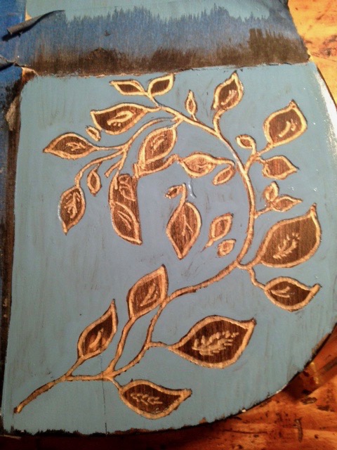

    OK...I may have gone a bit out there and this is only first paint (swatch) ...but the dremel pic stained in earlier thread I have sanded back, then engraved again with slightly larger burr, diluted brown jarrah (light wipe on) when dry sanded again with a 400 over dremel, 240 and then 320 then 400 remaining body. Reason I didn't go higher is more I'm still testing effects. I then applied an oil sky blue with a tiny brush..to see effect and do love the contrast of blues and browns..thoughts? am I crazy.. Click image for larger version.
