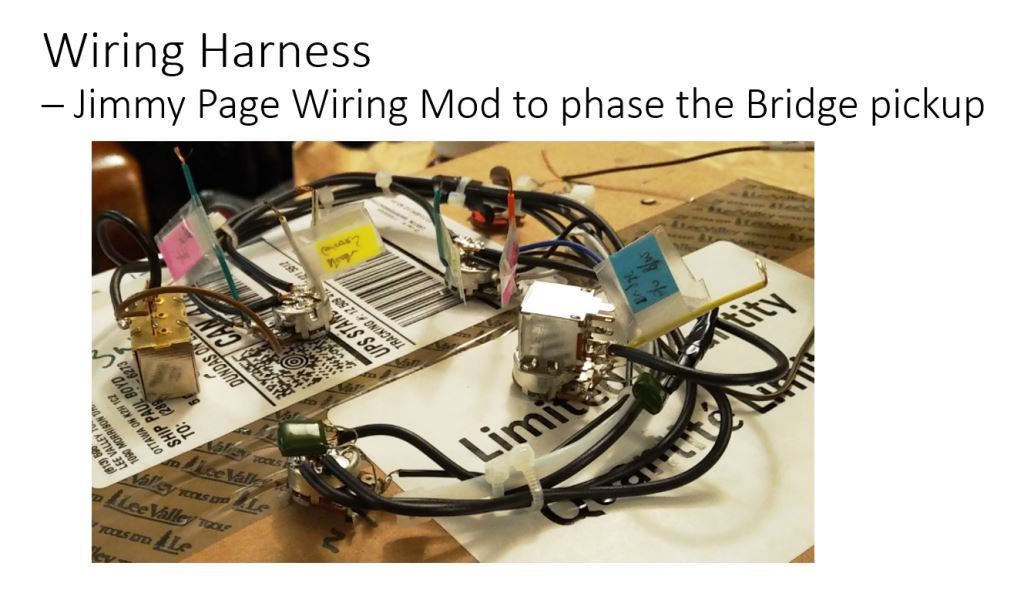

ID:	24869. The wiring was upgraded slightly with a push pull pot so I could adopt the Jimmy Page bridge pickup mod. I am interested to hear the Tonerider Rocksong Bridge pickup when I pull the trigger on that and engage the phase shift!

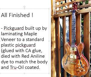

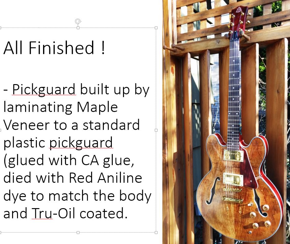

    Build is finished! This red-lady turned out great, and in my humble opinion plays as good as she looks!Click image for larger version.

    Thanks! I am so happy with this build. The kit was great and the ToneRider pickup upgrade was worth every penny!

    I have been experimenting with the phase shift as I have played the guitar more. I would say it sounds best when used for the rock-a-billy type riffs. I can't say it "quacks" exactly, but it definitely alters the tone. I am thinking of going with a rebel p90 at the neck to upgrade the stock humbucker there. The upgraded bridge bucker (Rocksong) produces an amazing tone. The scatterwound design is definitely more akin to a PAF type sound and produces a "vintage vibe" that complements this axe well.
