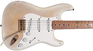

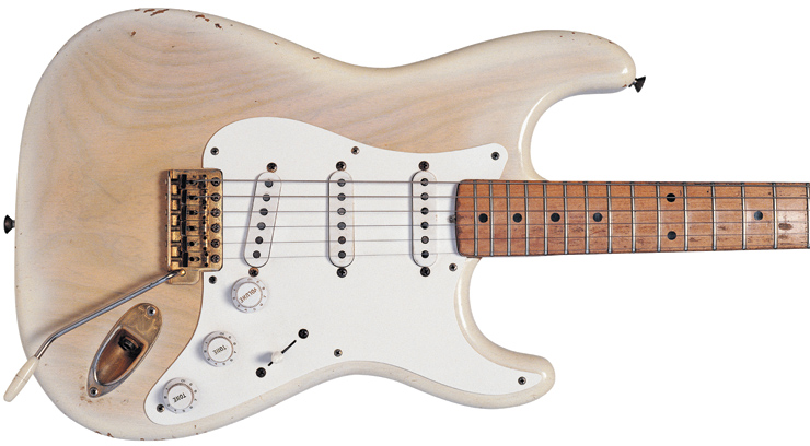

    Relic away I say. Just not to the point of abused or dragged behind a car like some relic jobs.
    That body's grain pattern demands a translucent Olympic White "Mary Kaye" style.
