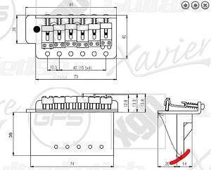

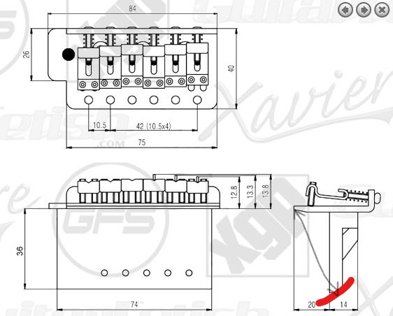

    I had a couple of questions though. This tremolo looks like it is exactly the same size, so can just drop straight in
    https://www.guitarfetish.com/Vintage...ars_p_844.html

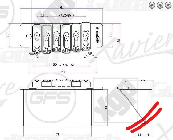

    But I was also looking at this one
    https://www.guitarfetish.com/Wilkins...ome_p_895.html
    and wondering whether there is any obvious reason it won't work? The body cavity is 43mm deep, and the tremolo block is 40 so I wasn't sure if that is enough clearance. I also wasn't sure whether the tremolo block being less wide was an issue?
    Apart from that I figure I'll have to cut the pickguard out a bit to fit it due to the added width, and the string spacing is 10.8 rather than 10.5.

    40mm depth block may depend on whether you set the trem for much (if any) up-bending. The rear edge of the trem block will describe the widest arc, with the centre of the arc being the pivot point on the edge of the trem plate (rear of the hole on a standard trem, front of the knife edge on a 2-point trem). The front edge (i.e. that facing the neck) of the trem block won't move as far downwards as the rear edge of the trem block when the trem is pulled up. Both edges will move away from the cavity cover when the trem is depressed. If you do set it to allow for a lot of up-bend, then the trem plate will probably be moved away from the body by a couple of mm to allow for the movement, effectively moving the end of the block away from the plate.
    So I don't foresee any problem. If you do find that the movement is bing hindered by the cavity plate, you could always open up the string holes in the plate into an elongated 'racetrack' shape, allowing easier re-stringing access and letting the trem block pop out of the hole rather than catch on the plate. But I really don't think that will be an issue. The trem block will more likely be stopped either by the front edge of the cavity rout, or the trem plate hitting the top of the body, before the block hits the cavity plate.
    In saying the above, I've forgotten that you'll also need to allow for the spring hook on top of the block, but I still don't really foresee a problem, and any problem will only occur on severe up-bends.
    The vintage trem looks to have a narrowed alloy trem block at the bottom, allowing for more trem movement in the rout, but that has the effect of reducing the distance of the rear edge of the block from the pivot point and so reducing the downwards movement in up-bends.

    The Wilkinson trem has a more desirable steel block, but the extra width at the base adds slightly more downwards movement.
Name:	InkedWilk trem_LI.jpg
    If really necessary, you could always file off 1-2mm of the bottom of the block.
    Thanks Simon, that is incredibly helpful and gives me much more confidence. I'll definitely give the Wilkinson a go - at worst it ends up being used in a future build.
