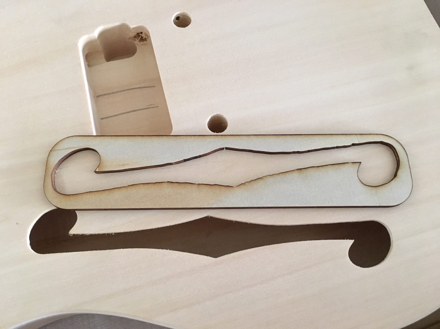

    This build is progressing very very slowly.....
    Good news is, I’ve got two students who are now going to order pit bull basses and start building.
    Anyhow, got a brief moment to laser cut the f hole reenforcement. The web was lacking exact matches of the F hole so I had to trace it by hand, then scanned it, then image traced using adobe illustrator, then export to laser cutter.
    Happy with the result. Now I need to pop it under the f hole and stick it.
    Thanks weirdbits for the inspiration. Click image for larger version.

    Gehoivey! That's some clever Vyving! You'll need to get some TEENY WEENY clamps to hold that in place while you glue it.
  9. #19
    Gavmeister used to use very strong magnets to clamp his F-hole veneers while the glue dried.
  10. #20
    I’m considering using tiny bulldog clips with a bit of packaging thin foam sheets to prevent denting.
