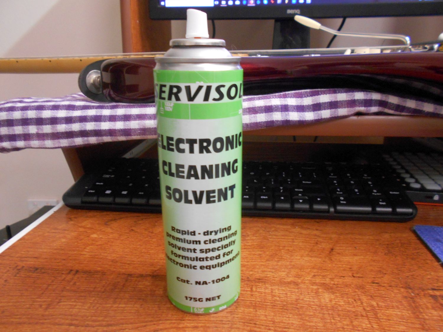

    The 3-way switch is certainly a good suspect, worth getting some switch cleaner and squirting it in there to see if helps. But without using a multimeter to check continuity, you'll never know for sure as the cleaner may make no difference.

    If there's a Jaycar Electronics shop near where you live, next chance you get pop in and buy yourself a can of this stuff, it's a specially formulated electronic cleaning-solvent, I use it all the time on pots and switches, does a pretty good job:
Name:	Cleaning Solvent_resized.jpg

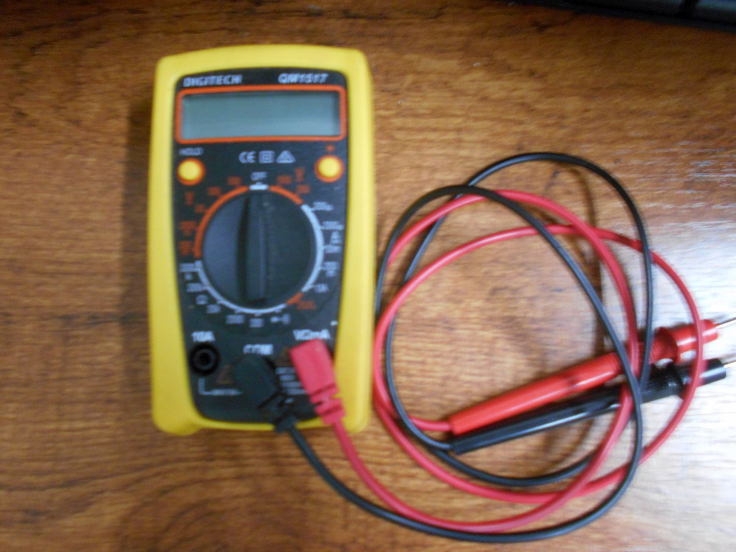

    Here's an example of a cheap digital multimeter that you can buy from Jaycar Electronics, catalogue number is QM 1517:
Name:	Cheap Multimeter_resized.jpg

    It features a continuity test function that produces a beeping sound if there's continuity, pretty useful to have.
