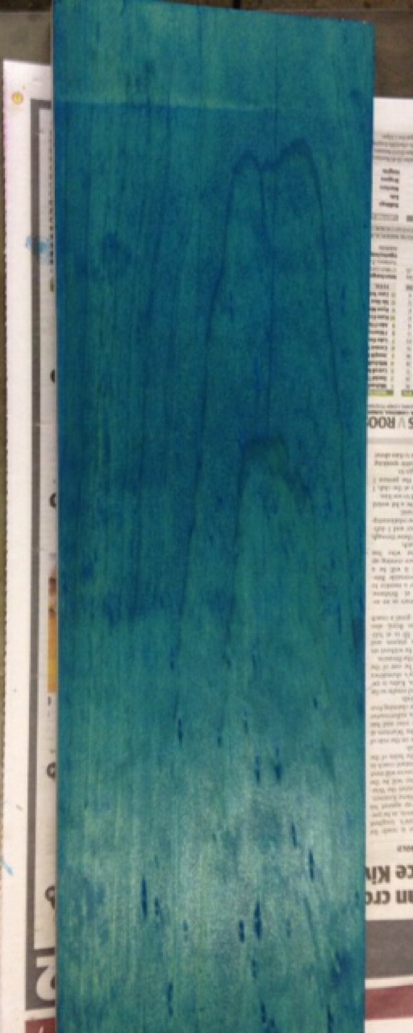

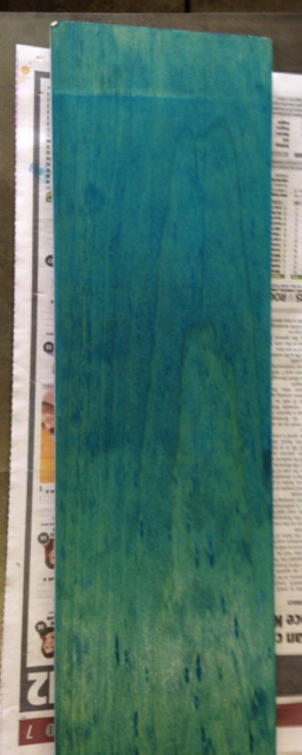

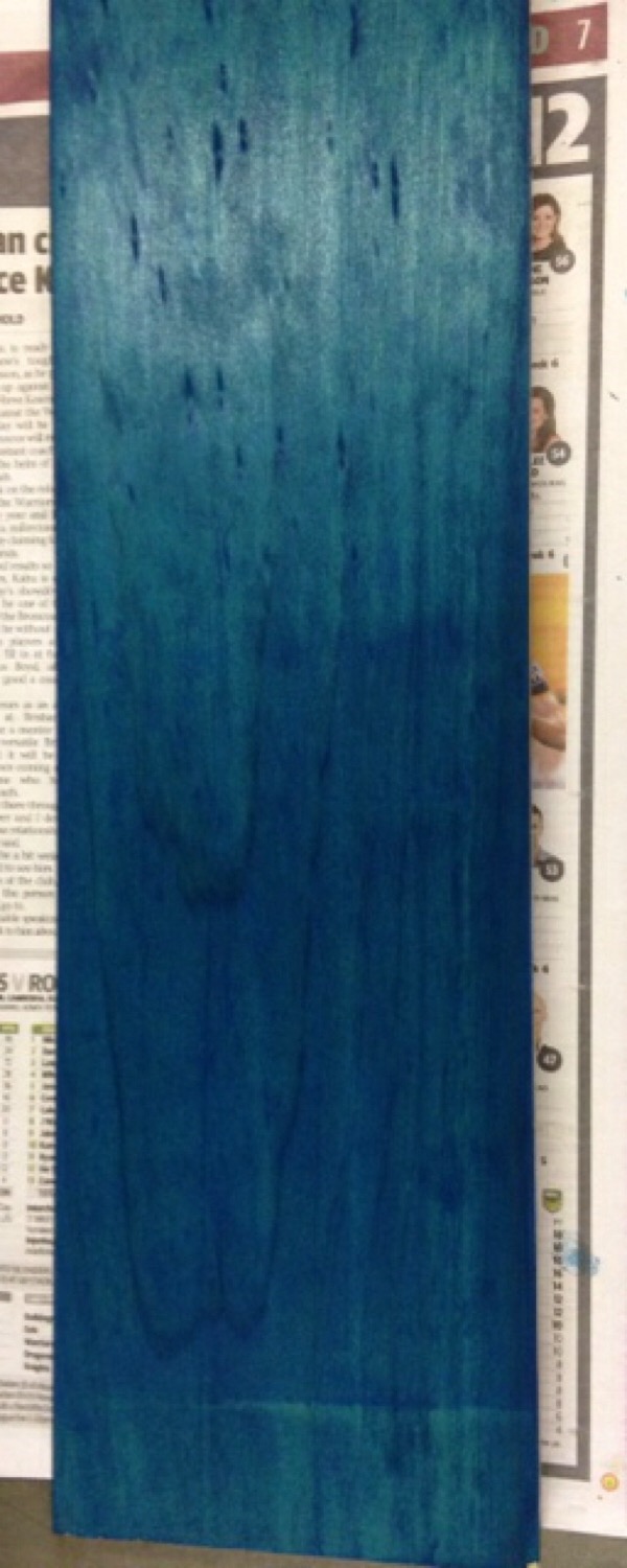

    I have been doing some experimenting with black and blue stains.
    I would like to get some opinions on how much black dye is required to help the quilting to stand out and how deep the blue before it is too much
    See below some photos of an experiment with a piece of pine , starting with a light coat of black and 4 coats of blue
    Has anybody had much experience with ubeaut water dye on quilted maple?
    Attachment 24179
    Attachment 24180
    Attachment 24181
    Attachment 24182
    Attachment 24183
    I'm afraid I haven't used quilted veneers, or the ubeaut dyes, but of the stained examples you posted I like the last and second last best - the colour is the most even in those two. I quite like the slightly green tinge to the earlier tests, but for me at least the uniformity of the darker colour is nicer.

    Quote Originally Posted by Denial View Post
    See below some photos of an experiment with a piece of pine , starting with a light coat of black and 4 coats of blue.
    Attachment 24179
    Attachment 24180
    Attachment 24181
    Attachment 24182
    Attachment 24183
    G'day mate. I did my TL-Q1 with Ubeaut stain. I think I used about 5 parts water to 1 part stain to pop the quilt, then sanded it back LIGHTLY! Try it out on scrap first and it is better to have it more diluted, then you can add another coat if required. The blue? All depends on the depth of colour you want and how the maple is absorbing the stain. Colour depth is always a personal taste thing. Again, start light and add more if required.
    If you are finishing with Tru-oil, don't forget that it will add a slight yellow hue to the finish. That could give you a slight green look. A clear coat finish is no problem.

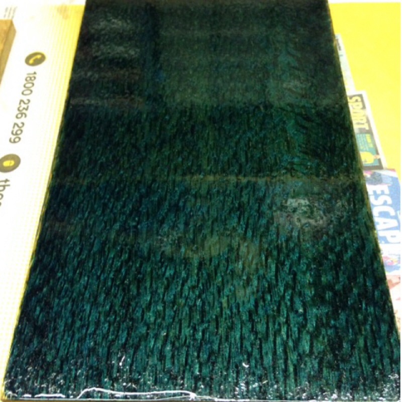

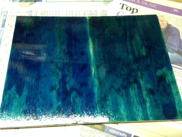

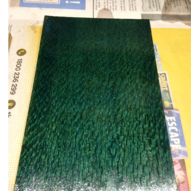

  11. #20
    Jan 2018
    Brisbane
    22
    Thanks IRL for the advise

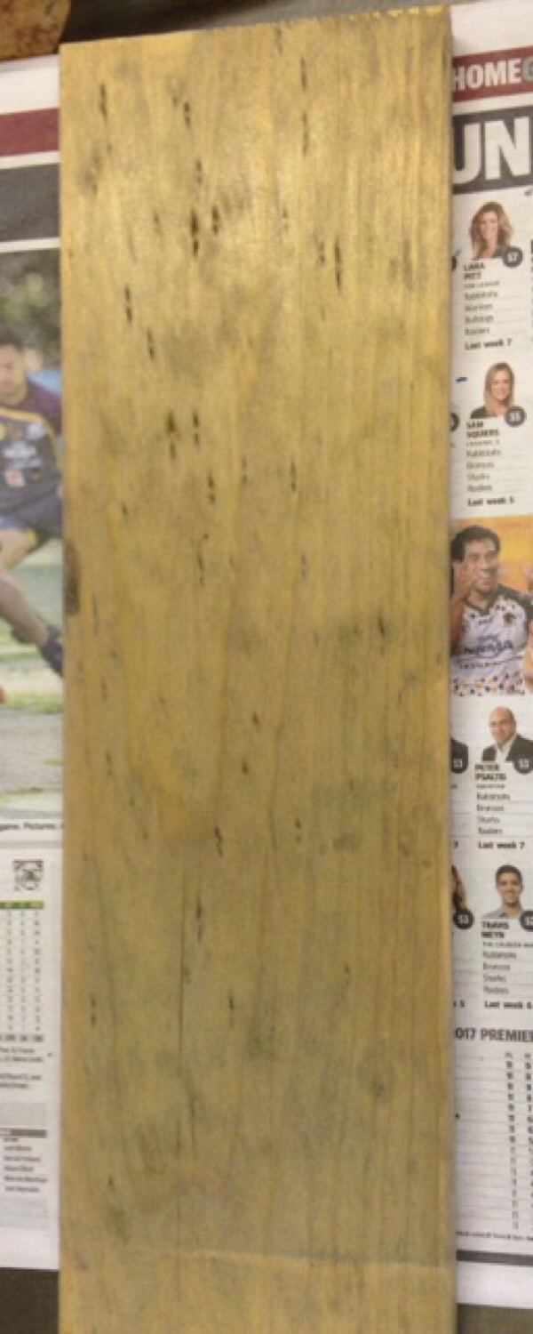

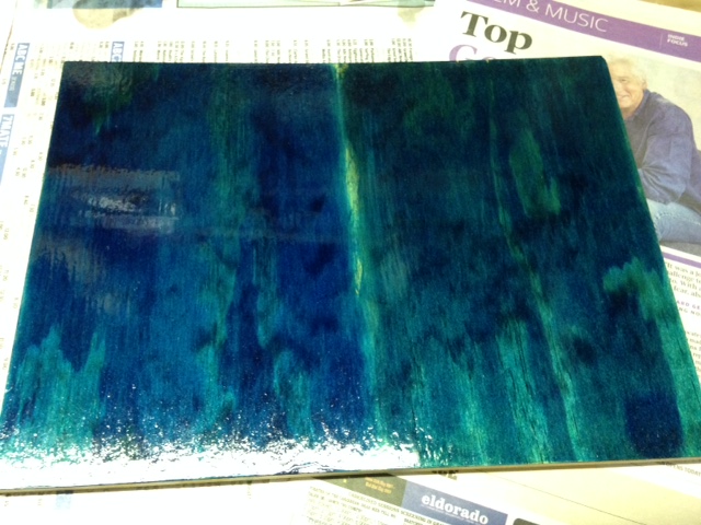

    I have also been doing an experiment with Tung oil finish over some staining to see the effect an yes it tending towards a more green hue see below a couple of photos
    This is a scrap of silky oak veneer on mdf from an old project.
    The first is with 1:5 black then about 1:3 blue with about 5 coats of hardened Tung oil
    The second is with just 2 applications of blue no black
    The third is with a stronger black with a little red added to the black, which " ubeaut" suggested would give a jet black and then the 1:3 blue
    I was doing this to see which would help the grain to stand out
    In all cases the silky oak has taken on a more of a green hue ( quite nice like peacock blue green) , i am thinking the maple will have less influence on the blue dye ?
    I also did a piece of scrap ply with a lighter pine but it does not have a lot of grain to show up. One side is just blue an the other side is blue over black
    .Click image for larger version.
