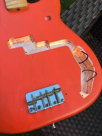

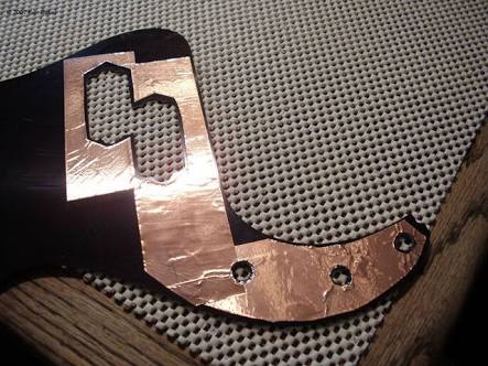

    Awesome info, once again, WeirdBits. We’ve bought the copper tape, but I hadn’t gotten that far in terms of learning. All the images I’ve seen for the copper tape show it shielding the walls and floor of the cavity. The pick guard has no shielding. Do we apply the copper tape to the back of the pick guard, or just ground the vol and tone pots together as you mentioned, WeirdBits?
    Something like these (first images I could find):
    These videos may also help guide you, bit rough though: wiring and shielding.

    Just note in Weirdy's pictures that the copper foil is brought over the edge of the cavity onto the body so that it makes contact with the foil on the underside of the pickguard to give a path to ground. I'd normally have a wider overlap to that shown, as the bigger the contact area, the more chance that good contact will be made. Just make sure it's all hidden by the pickguard. It's also best to have the foil running around a few of the screw holes, so that you know the two surfaces are being firmly held together in those locations. Elsewhere, any unevenness in the pickguard may mean that the body and guard don't actually touch in places.
