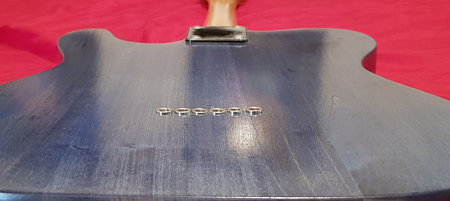

    Nice finish. Looks heavy.... like a slab of marble.
    Pedalboard Build

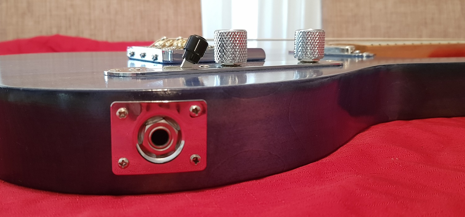

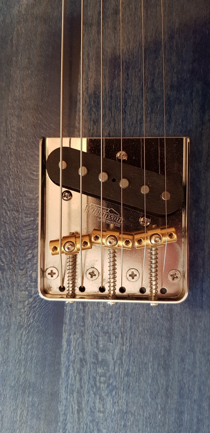

    Is that paint, or a vinyl wrap?
    Thanks. It’s paint with a couple of layers of clear coat for the gloss. Sorry for the multiple pics, but as you can see I had trouble posting them.
    5,666
    Quote Originally Posted by Liam Markby View Post
    Never apologise for posting lurid guitar finish porn Liam. We're all good with it.

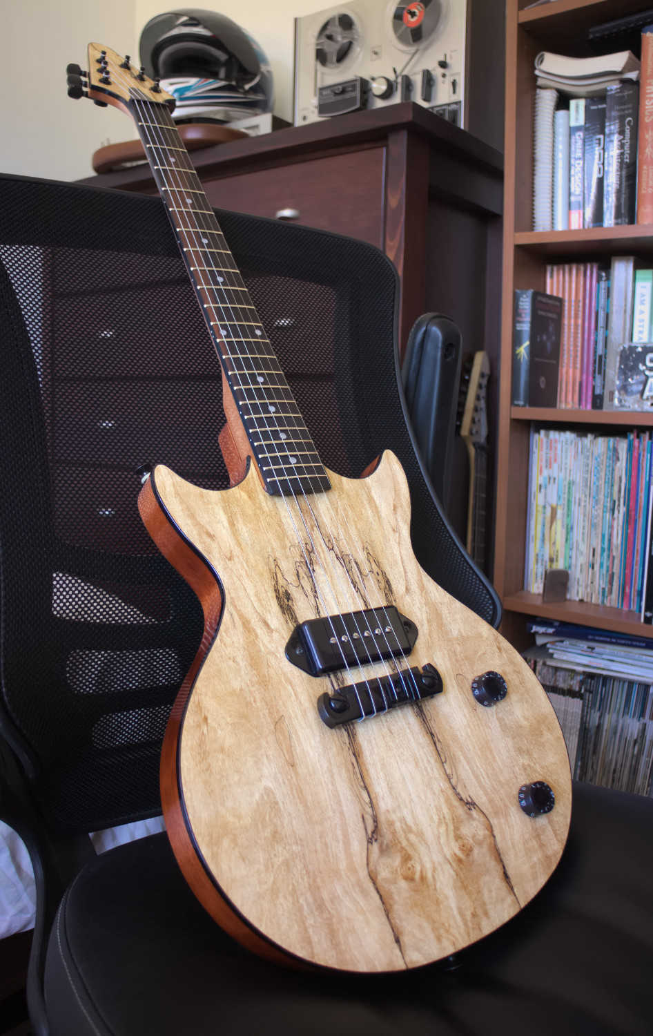

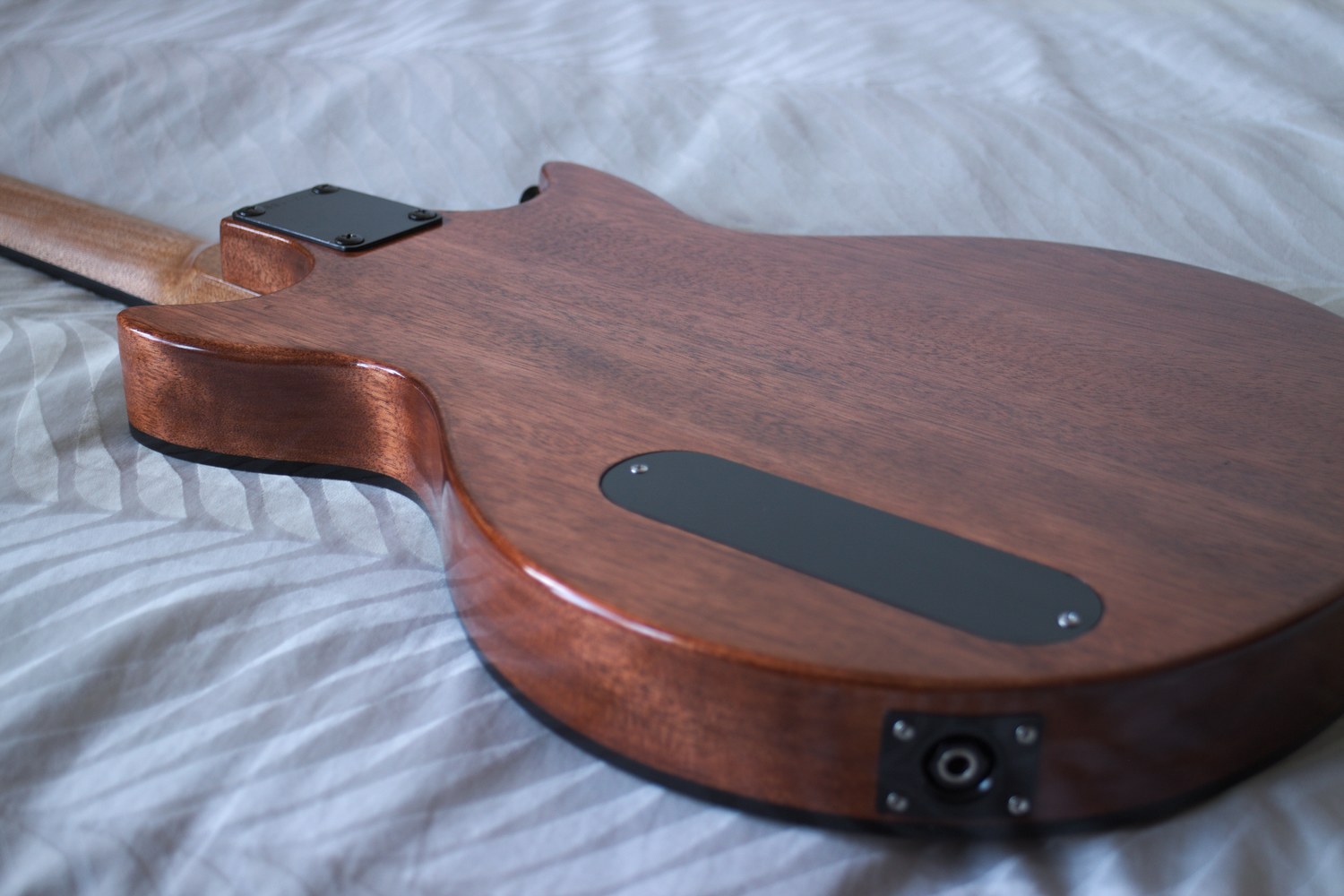

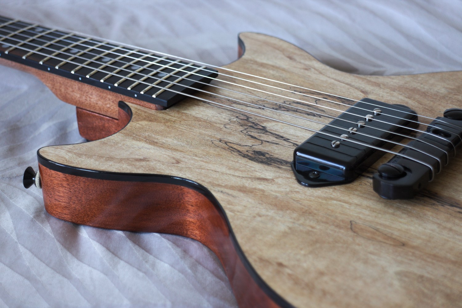

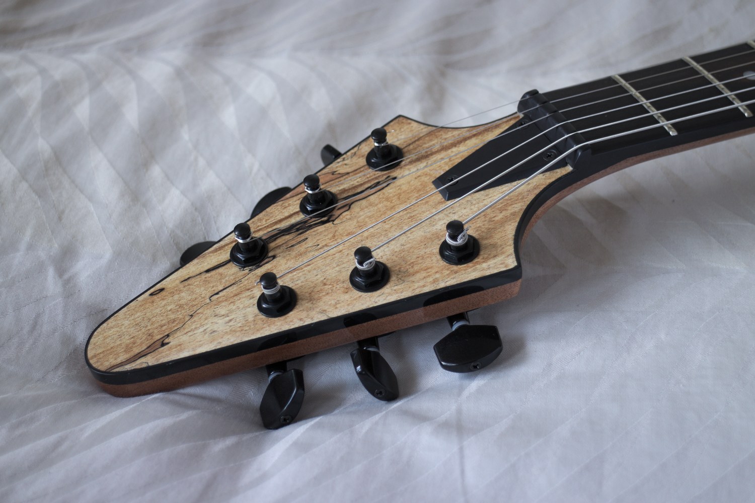

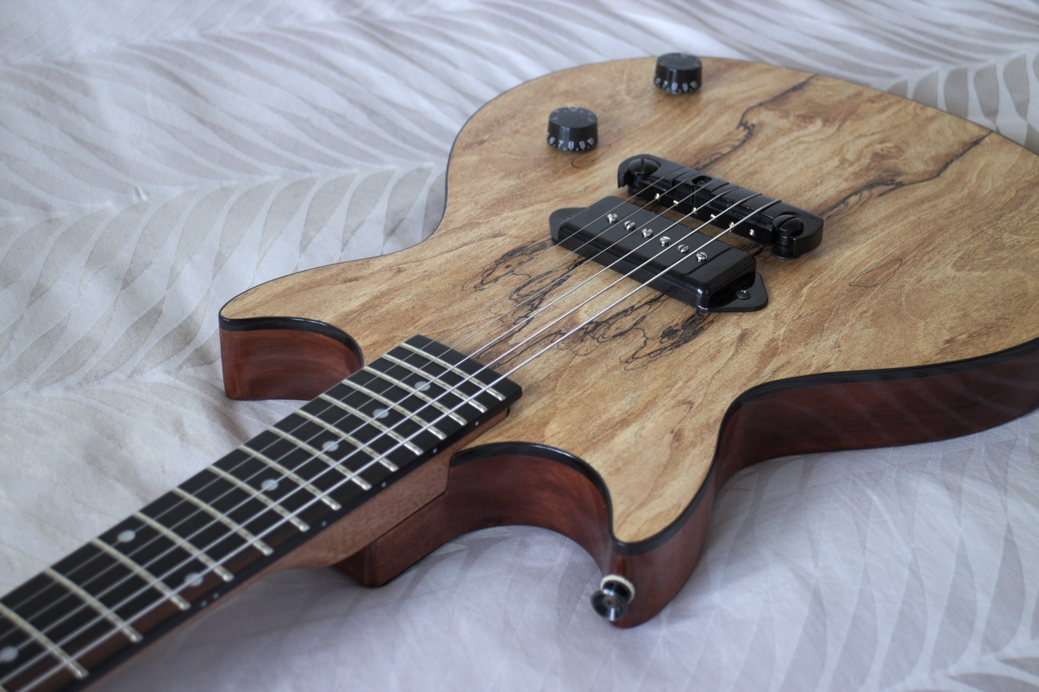

    Some people recommended I add mine, so here we go:
    DM-1S - Danish oil finish, gloss on the back and sides of the body, satin on the spalted maple top, with walnut stain on the back and sides of the body to bring the maple out. The neck is also Danish oil - smooth satin finish on the playable part, blending to gloss at the neck joint and headstock. I wanted a old-school-meets-modern vibe, so I thought the combination of old-fashioned wood finish with satin maple and blacked-out hardware would complement each other nicely.
    Hardware is a Wilkinson bridge and tuners, and a Tonerider Hot 90 for the pickup. Nut is still stock, with a bit of lubrication it works fine. The interior cavities are fully copper shielded. The neck plate and strap lugs are nicked from my old Martin Stinger superstrat.
    I can't stop playing this guy! The P90 is giving my noise gates a workout, but I love the unique sound you get using a P90 for metal tones. Also it's the first time I've had a scale this short, so it's fun playing with some of the stretchier chords, and feels impossibly relaxed after noodling around on the 8-string for a while.

    Hi John, I did use a can. Dulux marble effect I think. It comes out if the can almost like string.
