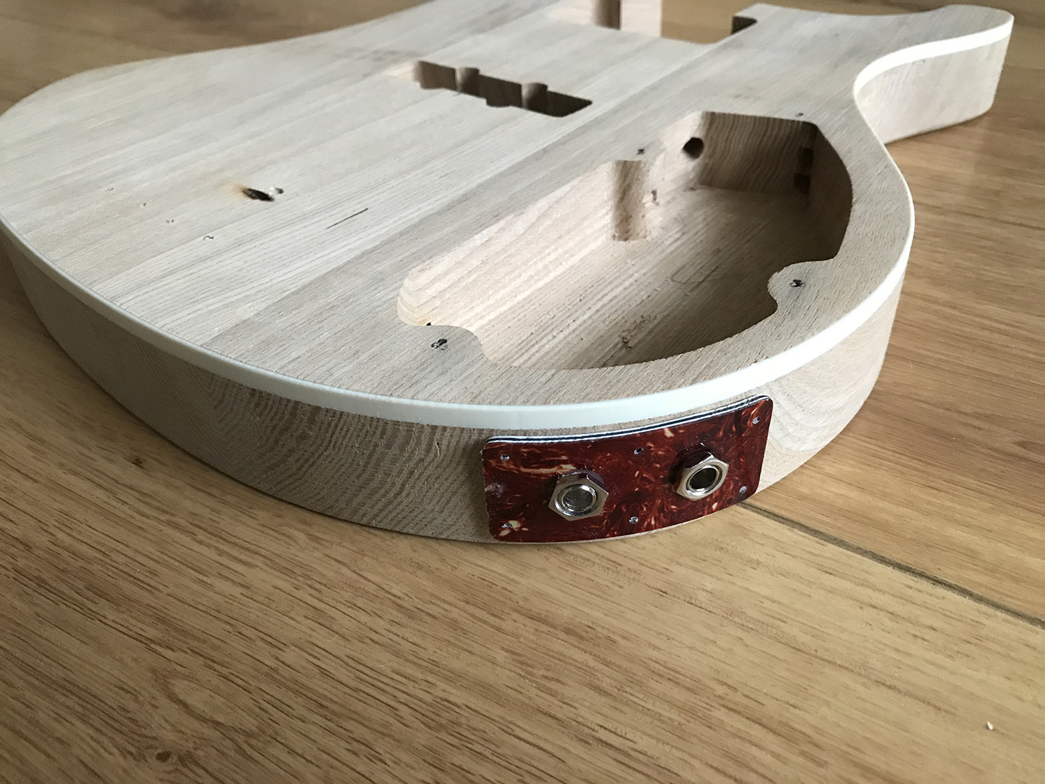

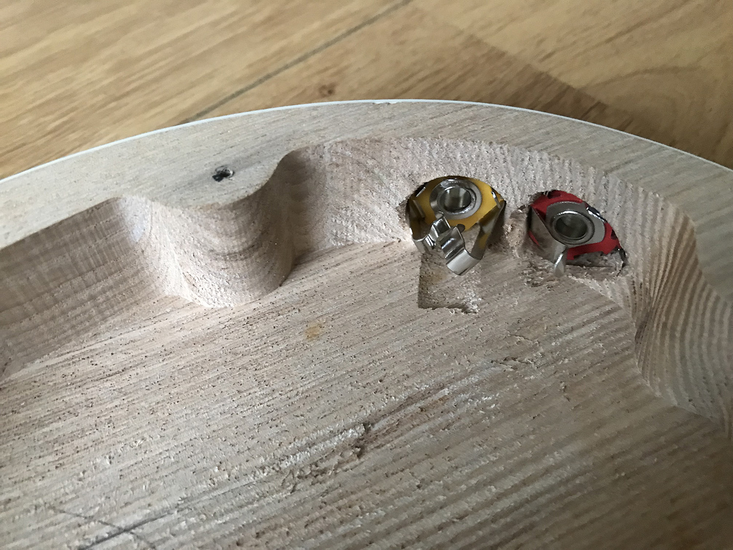

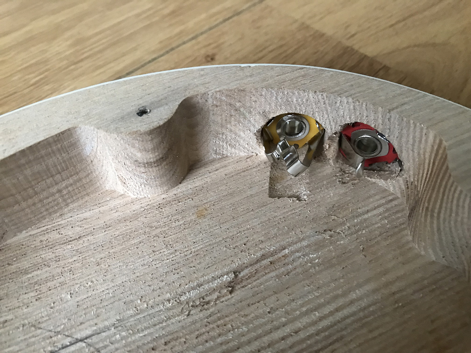

    Right, the bullet has been bitten and I took a hole saw to my lovely new guitar body and we now have provision for stereo and mono jack sockets.
    The retaining plate (or whatever you want to call it) I made from a bit of a scrap pickguard just to try the idea.
    I was surprised at how stiff it was but a quick dunk in some boiling water and it curved nicely.
    Its a bit thick though and I'd really like to make a recess for it to fit flush but I might just end up chamfering the edges so it looks better.
    The finished article will match the new pickguard and pup ring that I am making in pearlescent black.
    Quick question while I'm here - I know what I need to finish with but what grade grit is recommended to start sanding with?
    Dec 2017
    TORONTO, CANADA
    118

    Love that you're doing a stereo RC. Pretty damn cool! And I like the pickguard retaining plate - looks cool to me.

    I'd go with your edge chamfering idea for the jack plate. A tug on a guitar lead can put a lot of force on the jack plate, so it needs to be pretty sturdy, so thinning it down could weaken it too much and you'd probably end up replacing it pretty quickly.

    Thanks Simon that's a good point!

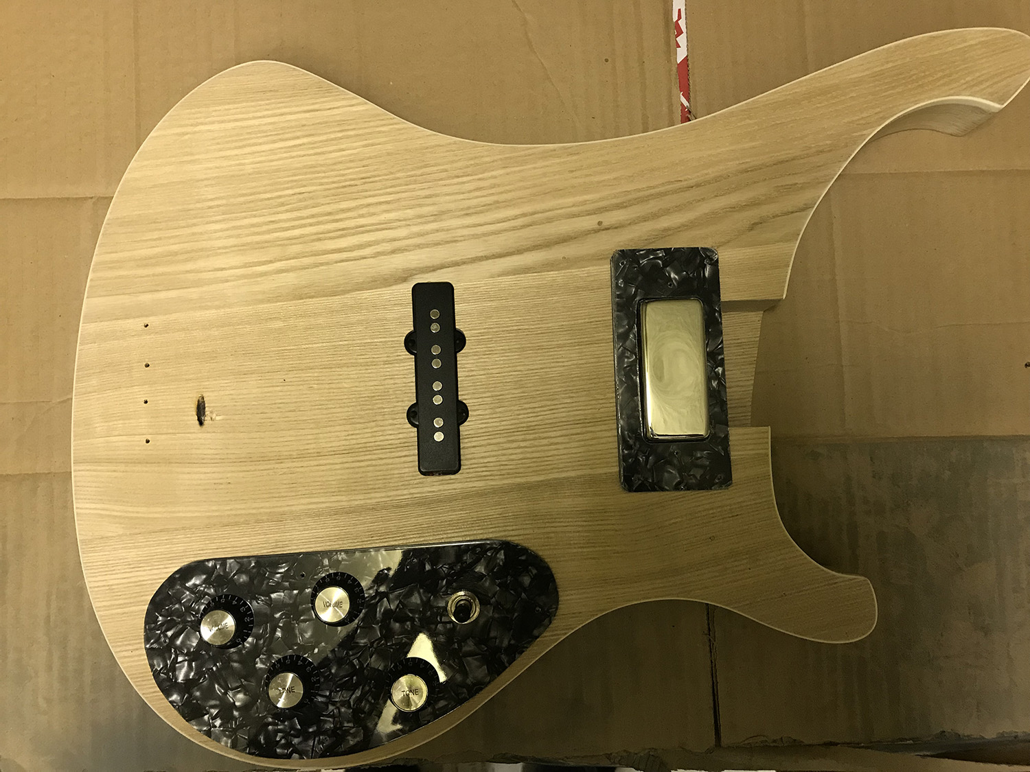

    Right, I think I'm done with sanding so time to start applying some finish.
    Last couple of pics while it is still naked wood and showing the plastic part I have made.
    The pickup ring was a real pain to do :-)
