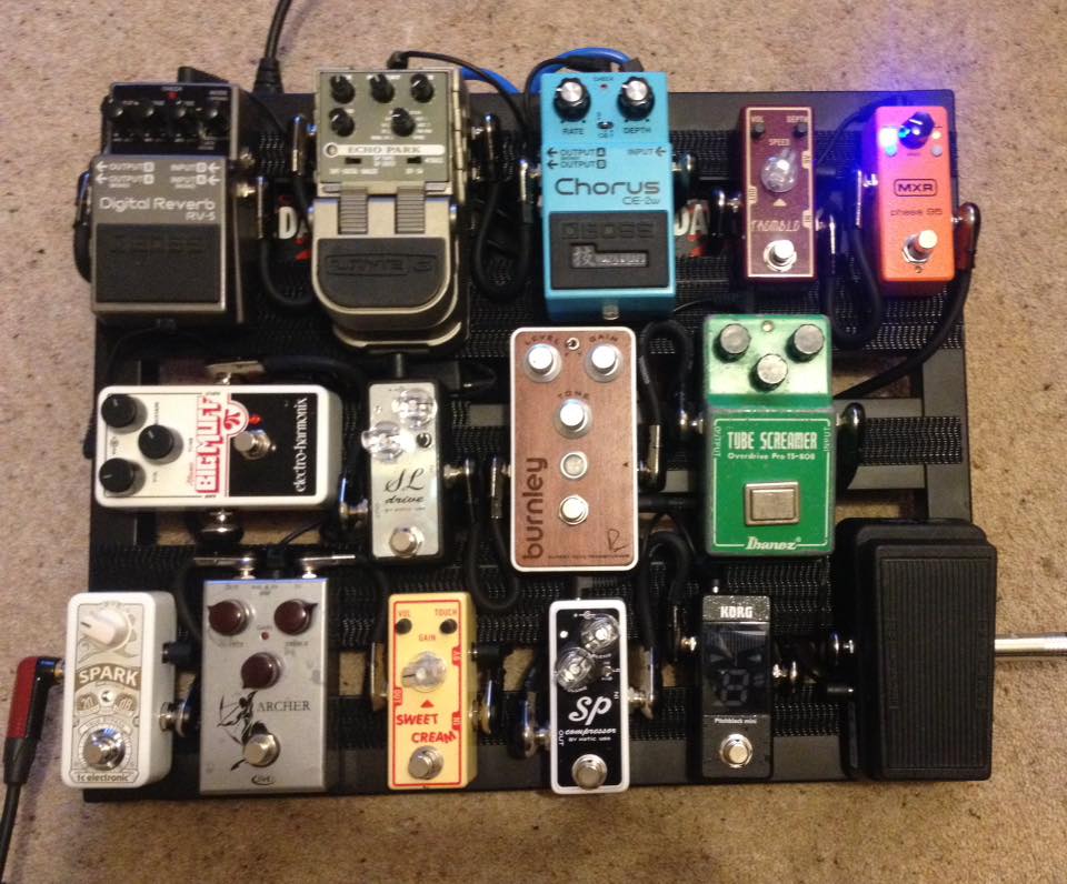

    My latest pedalboard version. Re-did it all using 3M Dual-Lock (the stronger adhesive version). Expensive stuff (much dearer than Velcro) but worth it. I was fed up with the Velcro peeling off the base of the pedals over time. This stuff is a lot more secure and there's also no play when the pedals are stuck down.
    I also made up all my own patch leads. I had been using George L's patch cables, but having the need to make some new ones up found that they were a) unreliable and b) had varying resistances on the signal core from between 0.3 ohms to near 100 ohms (generally in the 10 ohm region). So they went in the bin and I soldered up my own, all with 0.1 ohm (the lower reading my multimeter will give) connections.
    The Nano Big Muff is the latest addition and replaced a couple of Andertons' Tone City drive pedals as I had ended up with 4 pedals all sounding very similar to one another.
    The Line 6 Echo Park has also reappeared and replaces a TC Flashback, as the L6's tap tempo is a lot easier to use than the Flashback's strum tempo feature. The Korg Pitchblack Mini replaces a TC Polytune Mini that I really didn't like. The poly mode gave different in/out of tune readings to the individual note mode, and the individual note mode kept swapping to the poly mode even though being very careful to just sound one string.
    (Apologies for the poor picture).

    All on a Pedaltrain Nano 18 board with 2 x Voodolabs PedalPower 2 PSUs

    Good tip - might go buy some tomorrow. Nicely arranged board too.

    A mate of mine uses George L cables on his pedal board and was always having issues with them, he wants me to go through and solder all the cables for him, personally I think soldered joints in cables are the best, a lot of those George L cables use some kind of grub-screw mechanism to make the electrical connections between the cable conductors and the plugs, over time, these connections do have a habit of working lose, soldered-connections, if done properly, don't come lose.
  6. #16
    A lot of well-known people were using them when I bought my first George L's cables. (I was using the thin ones designed for pedal boards) Not sure if the first lot were better made than the recent additions, but the new lot were just terrible. They don't have a grub screw, the coax cable is just pushed onto a spike at the bottom of the jack body, the cable then bent over so it angles out of a slot in the body, then a cap screwed down to finish pushing the centre wire on the spike and help keep everything in place.
    It's all very hit and miss and you can't test just one end at a time as you'd never get a good connection with the thin signal wire in the middle of the coax cable (the cable is simply cut straight across - no stripping back). So you have to put both ends on, then test the resistance of the signal cable (I found that the shield was always very good), and if it's high, pull it apart, snip a bit off both ends of the cable, and try again.
    By comparison, I did have some Planet Waves solderless patch cables which do use a grub screw, and they were very good - all had a minimal resistance. But they are very expensive, so I ordered a whole lot of right-angles pancake jacks and some decent cable, and soldered up 15 patch leads.
    FYI, the signal flow arrangement is right to left on each level, starting with the Cry Baby Mini, but with the TC Spark Mini as the last pedal (fed from the Boss reverb) as a boost for solos. By adding a couple of extra patch leads I can run the chorus. delay and reverb in stereo if I want to, with the boost on only one channel.

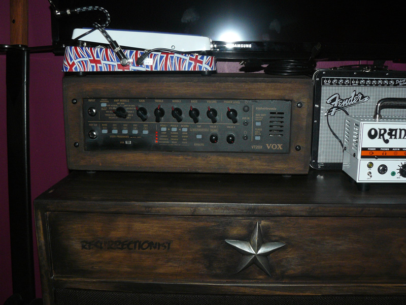

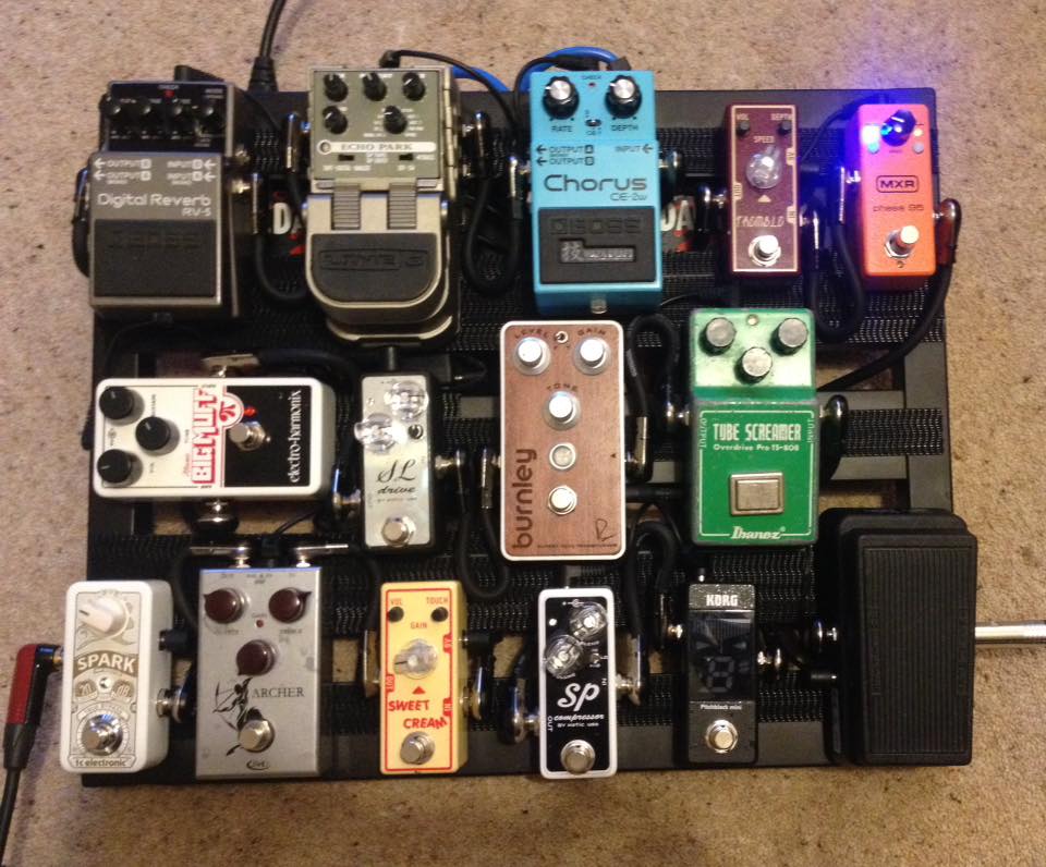

    I have my beheaded VTX20 on the desk for use with headphones for late night noodling sessions. I've saved a few presets of my own and there are times when the the thought of dragging the pedal board out, running cables and fiddling with pedals all sounds like too much effort. Much to be said for the modellers.
