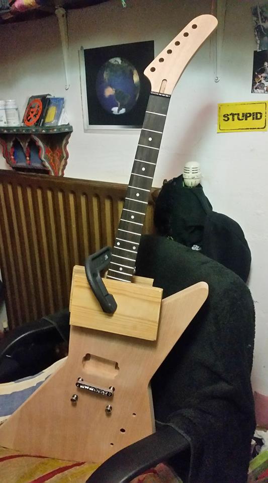

    Found the balls, and glued the neck on.
    First time using this glue, so fingers crossed it works properly (we'll soon find out if it didn't work hah)
    Measured like 20 times, found a few good spots, and then put the pickup in and realised they weren't good spots, then double checked how to measure the scale length, then marked, measured a few more times, then glued.
    Really keen to get this thing together, but not going to rush it.

    Hit the heel up to get that nice transition.
    Not amazing, and for some reason I couldn't get rid of the little micro lips, but it'll do (they look worse in the pics seemingly)
    Upside is it feels great, and mostly looks the part haha. Actually really surprised how it came out, both the sanding (though there was a mishap with the higher end of the neck being slightly thinner) and the glueing. Yeet
