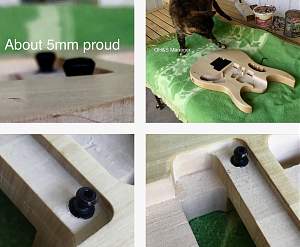

    Trying to get a pic up but this is an iPad!. Let's try this one. Click image for larger version.
ID:	23887 hope that works
  8. #18
    Dec 2017
    Buchan South VIC
    58
    As you can see, the top of the posts are level with the top of the routed out section - there is no cracking to be seen. But the screw heads are still about 5mm proud of the top surface - is this a problem please? And yes, the OH&S expert got in the way as usual.
    Doug.
  9. #19
    Doug, that’s not an issue mate, if anything you’ll be winding those posts up to get your bridge height set right.
    If you are really concerned, get your neck on in its final(ish) position and clamp it.
    Pop your trem bridge in loosely and run a straight edge across the neck to the bridge, I think you’ll find it will need to go up from where you have those screws set now.
    Edit: isn’t it the function of OH&S to get in the way? Usually for the greater good, or in your case an extended scratch or pat😁
