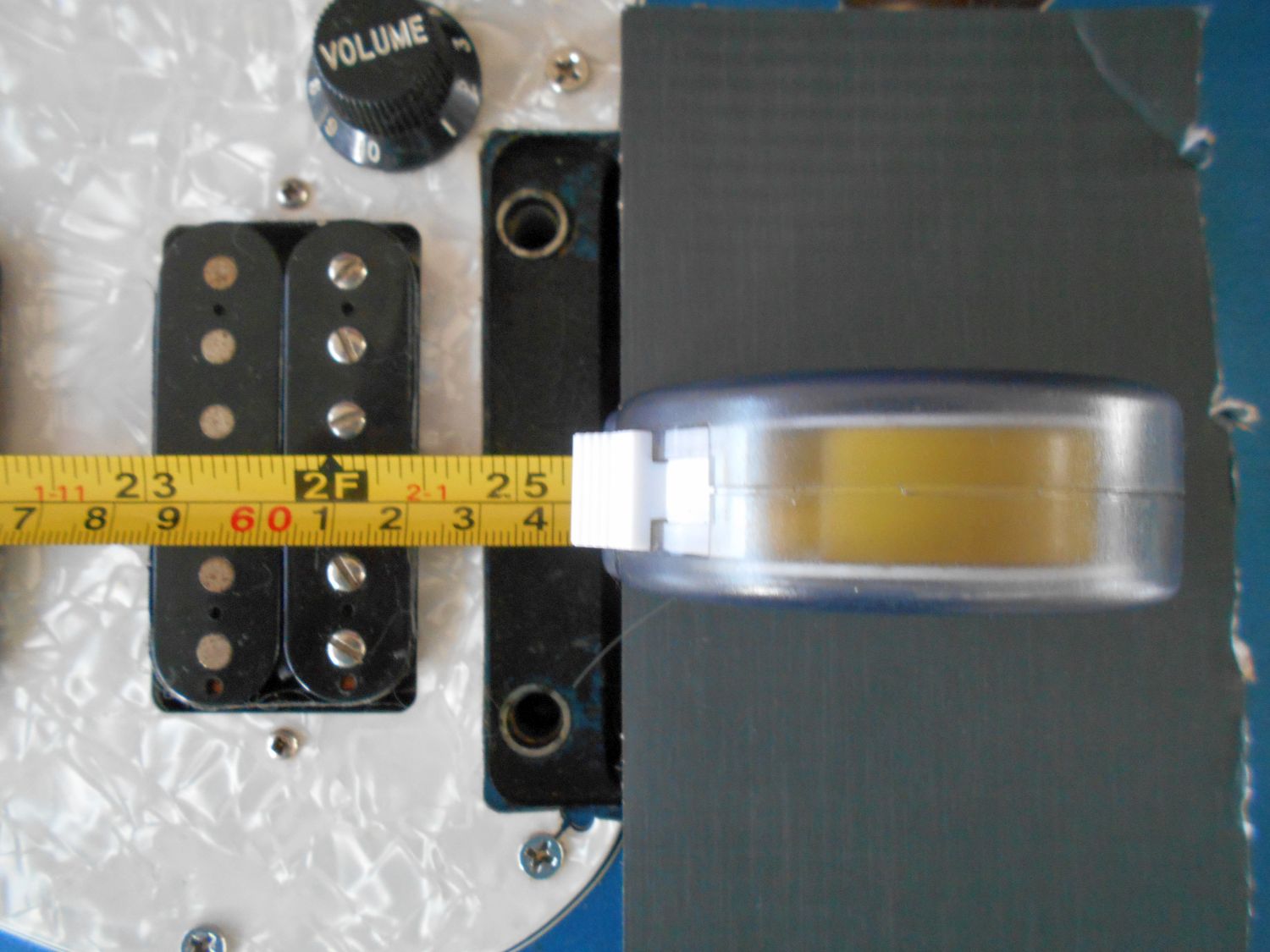

    As a way of confirming my serious suspicions of where the Floyd Rose bridge-routing was placed on the body of my Hot Rod Strat, I got out my tape-measure, set it to 25.5 Inches (it measures in both mm and inches) as per Fender Scale-length, and placed the tape measure on my Hot Rod Strat with the zero lined-up at the end of the fretboard, you can see in the pic where the 25.5 inch mark ends up over the bridge route, it definitely looks like the bridge route is a bit too close to the bridge pickup, I'm guessing it should have been positioned an extra 5-10mm away from the bridge pickup:

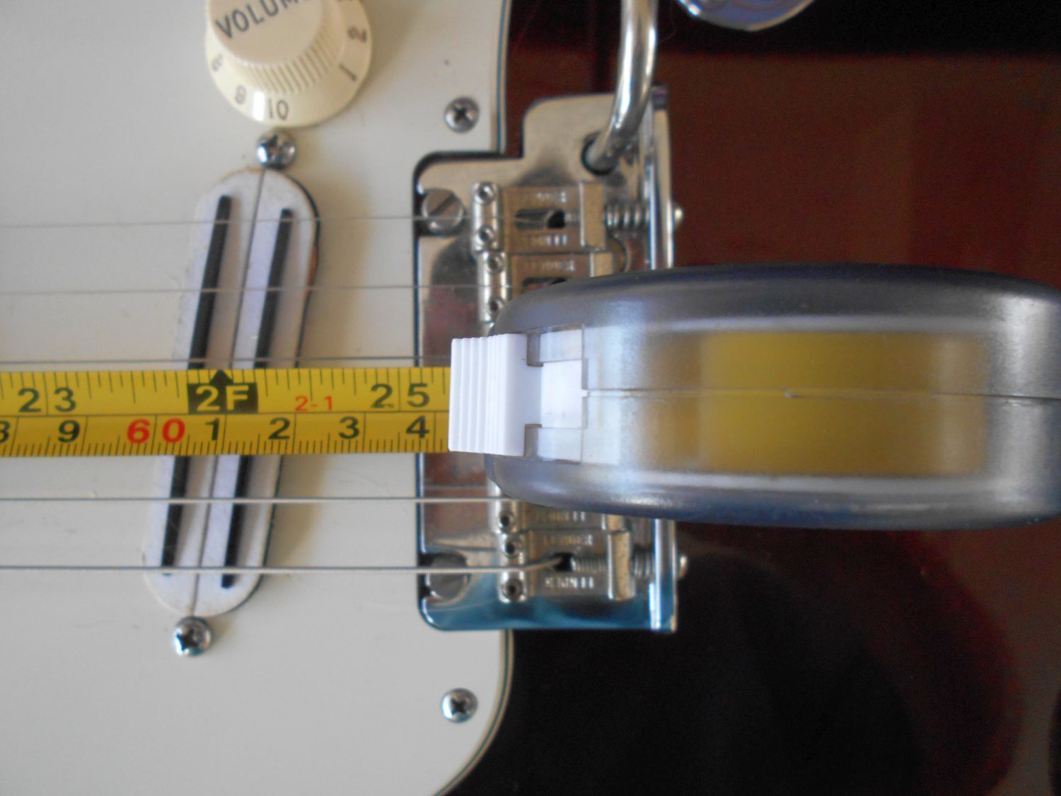

    As a comparison, I did the same check with my Fender USA Strat, since it uses the exact same scale-length as my Hot Rod Strat, as far as I know the intonation on the Fender Strat is set accurately:

    Notice where the 25.5 inch mark ends up in relation to the string-saddles on the Fender strat's bridge.

    I wouldn't worry too much about it, Doc. According to the StewMac fret calculator, an original FR should have the post centres at 25", a FR II and Schaller Floyd Rose at 24.937". So your posts look to be very slightly too far back, rather than too far forwards!
    The important thing is where the saddles end up, and they are positioned further back on a FR compared to a standard Strat trem plate in order to provide a larger arc of travel when the trem is operated, allowing for a greater pitch change range. The saddles will end up in the right position for a 25.5" scale length.
    Also, if you look at the distance the pickup is from the bridge, the trem end of the humbucker is about 62cm from the nut, whilst the middle of the trem end of the Strat pickup is also 62cm from the edge. So the average Strat pickup position edge is the same as the humbucker. In fact, as the humbucker coils are thicker, the screw pole pieces are slightly nearer the neck than the trem-side rail of the USA Strat.
    I really don't think there's anything to worry about. Any differences are down to the different trem designs.

    Hmmmm....that's interesting, when I tried installing the Schaller Lockmeister bridge (it's same like an original Floyd Rose, or supposed to be), and when I try to set each string's 12th fret intonation there doesn't appear to be enough range to move the low E-String saddle back enough to lengthen the string, the Gotoh Floyd Rose bridge seems to have more adjustment range, but when I try installing the Gotoh Floyd Rose bridge, I run into a couple of issues, firstly the brass sustain block is too long to provide enough clearance for the trem spring rout cover, secondly the bridge routing doesn't have enough clearance for the string clamp screws, I tried fitting a shorter sustain block to the Gotoh Floyd but that didn't work because the mounting screw holes on the shorter sustain block weren't in the correct positions, I think I may need to shorten the Gotoh Floyd's sustain block by at least 5mm in order to fix the problem, the Gotoh's sustain block is 40mm and the shorter sustain block I tried was about 34mm.
    I guess I could try ordering one of the Floyd Rose bridges that Pitbull Guitars sell and see if that works better.
    So, for the time-being it looks like I'm a bit stymied with the Hot Rod Strat, I need to order some new locking nut mounting screws from Realtone Music anyway, since the only two good ones I had have threads on them that are a bit chewed up and stripped.
    So, I'm going to leave the Hot Rod Strat for now till I can come up with a solution to get it back in a playable condition again.

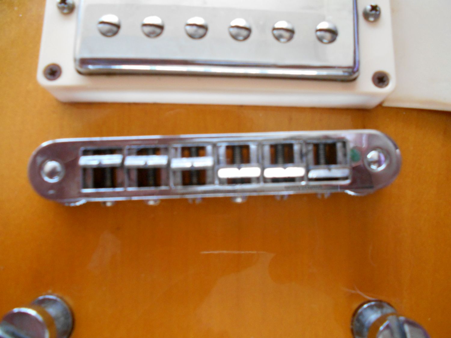

    Just out of curiosity I decided to check the bridge positioning on my Gibson USA LP Studio guitar, I know that it uses the standard Gibson 24.75 Inch scale length so I got out my tape measure and set it up so that it was locked on 24.75 Inches, interestingly my tape measure seems to show that the bridge is positioned a bit too close to the bridge pickup, I'll post a pic shortly.
    Here we go:
Name:	TOM Gooch_resized.jpg
    Before taking the pic, I adjusted the position of each of the string saddles so that the 24.75Inch mark on my tape measure lined up with the top of the saddle, the guitar is going to be getting some new bridge hardware, tuners, and a new nut fitted soon anyway.
    Does that look like the bridge is a bit too close to the bridge pickup, or is it pretty much normal?

    What's the nut to 12th fret distance? I'd never trust a flexible tape measure for accurate readings as the metal end is always out by a bit. If you haven't got a long metal rule, then try measuring again but start from say the 10" mark (so you are looking at 34.75" in total) as I find it's a lot easier to just add 10 to all the dimensions rather than any other integer.
    But measure to the 12th fret. Gibson have changed their scale length and although it's been close to 24.75", a lot of the time it's been slightly different. Paul Reed Smith said that he took a ruler and measured a lot of old and new LPs and said it's 24 9/16", rather than 4 12/16" (which would bring the saddles further forward). Don't assume it is 24.75".
