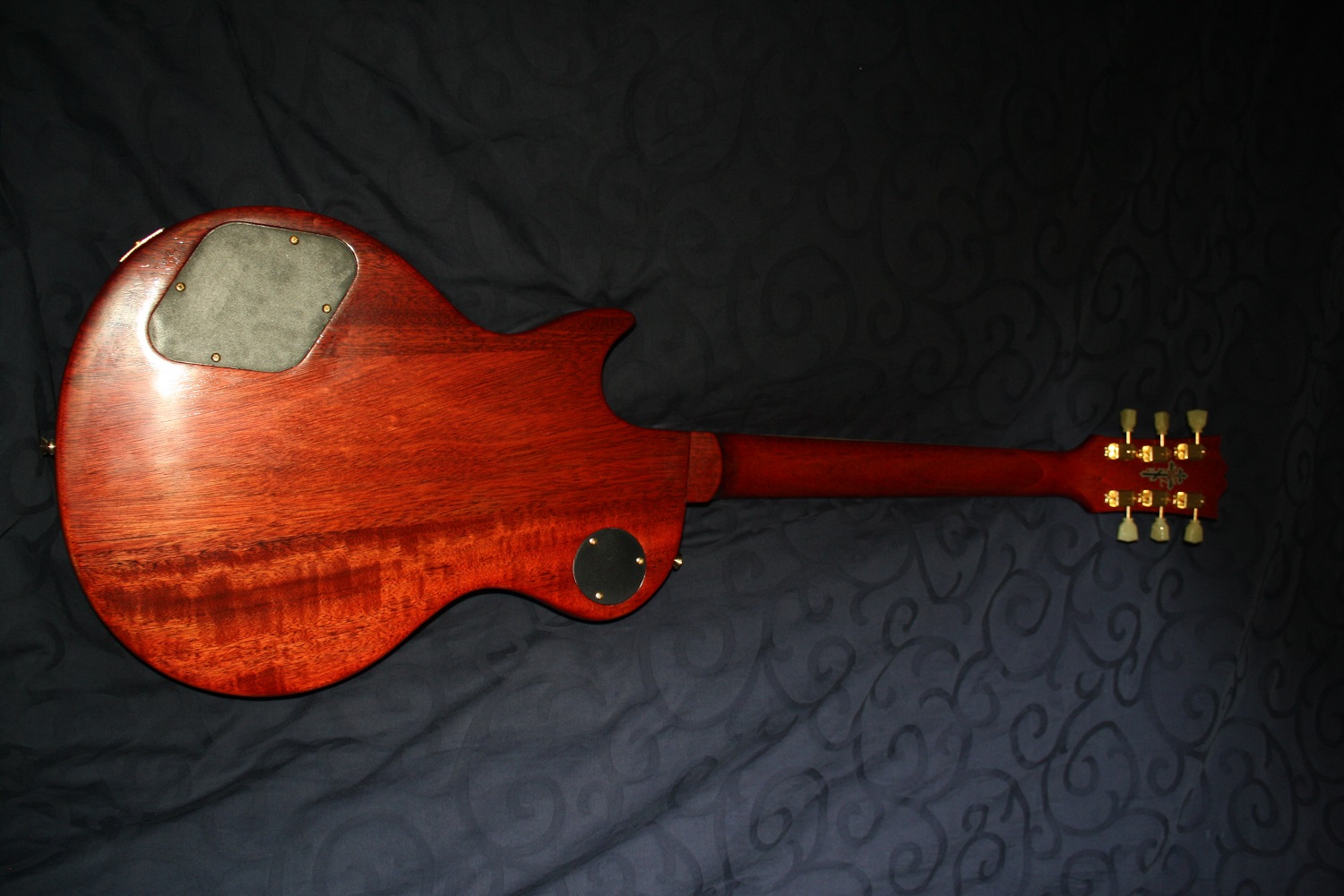

    Hi guys,
    Steve is correct that Timbermate is a water based product and DT is oil based....
    however......
    I can speak from experience, you can use timbermate as a grain fill and it reacts very well with DT. I always put timbermate first then apply DT over the top, it doesn't stop the stain coat soak in and brings out quite a lustre in the stain. I usually use at least 4 stain coats for the deepest colour with a week curing in between, then 3 -4 intensifying coats again with a week between. the intensifying coats should be applied thinly.

    This is ebony timbermate showing through DT Karajini red on the mahogany on my LP.
