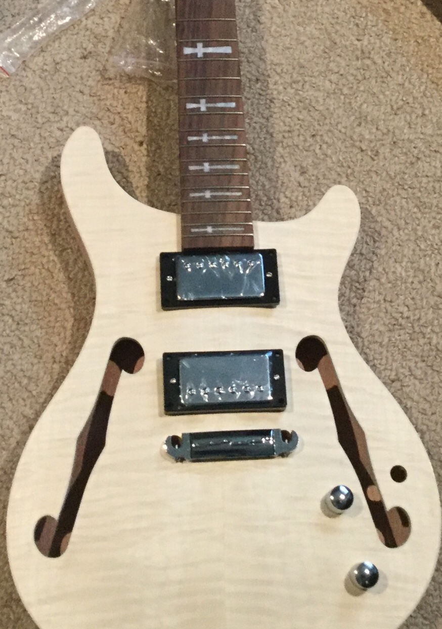

    This a mock build of my kit, The neck fits, but has just a little bit of wiggle room,
    I have started sanding, (Sorry no pictures), and is turning out well I sanded the veneer down to 400, as I did with everything else, I thunk I might stay with the pickups, but I am thinking of replacing the bridge.

    Hmmm...Interesting... looks like you got chrome hardware... mine came with Gold hardware..
    My neck fit gave me only a few mm of movement at the nut of which I needed to use nearly all of it to get the neck straight along the centre line. Be sure to have some temporary 'E' strings on when you set the neck else you may find that one of the E strings will leave the fretboard at the 24th fret. Had I glued my neck In the 'relaxed natural' position of the neck fit I would not have been able to use the high E above the 12th fret as there would not have been any fretboard under the string. When setting my neck and to get the temporary stings to sit correctly all the way down the neck I had to push the nut "up" (towards the low E) as far as it would go and then clamp the neck in that position.
    Also the heel of my neck doesn't traverse the entire neck PU cavity. I inserted an appropriately sized wood filler block into my gap and glued it in which essentially joins the neck heel block and the wood between the PU cavities. I figure in some ways it may improve the strength of the neck join and may possibly affect sustain but mostly it makes sure that when I set the neck the string length is as close to ideal as I can make it. If you have a close look on my build photos (any I build with a set neck) you can see the 'neck end gap' in the neck PU hole that needed filling. I'll include a photo here which shows the 'block' more clearly...

    Does the end of the fretboard have to line up with the start of the neck pickups cavity?
    Quote Originally Posted by thyoungscientist View Post
    The simple answer to this is no. It is more important to make sure that the scale length is correct. There are a few posts that cover neck positioning in detail on the site, but essentially the distance from the inside of the nut to the middle of the 12th fret on the high E string should be the same as the distance from the middle of the 12 fret to the bridge on that string.
    (See Gavmeister's post attached for details.. http://www.buildyourownguitar.com.au...ead.php?t=1895)

    Also what bridge would you reccomend for this
    Is a Gotoh Wraparound Bridge Good?
    How do you know it is the correct scale length
