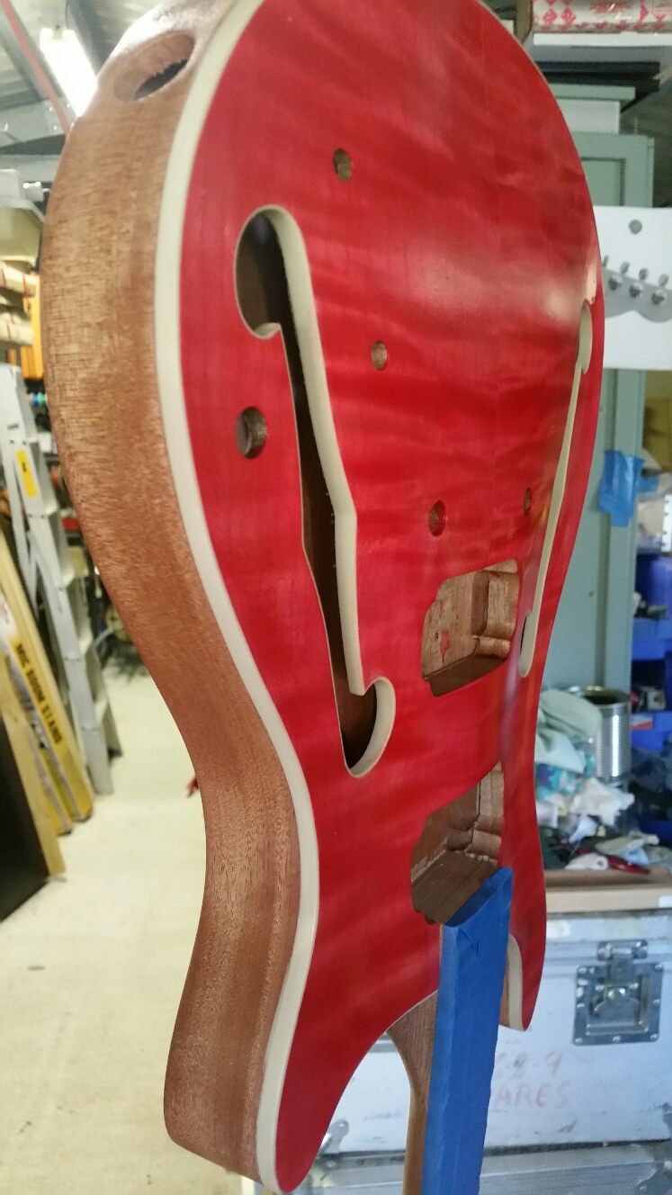

    Good thing this is only the first colour hit, yet at the same time it's a bit of a shame... I think I have some fixing to do...

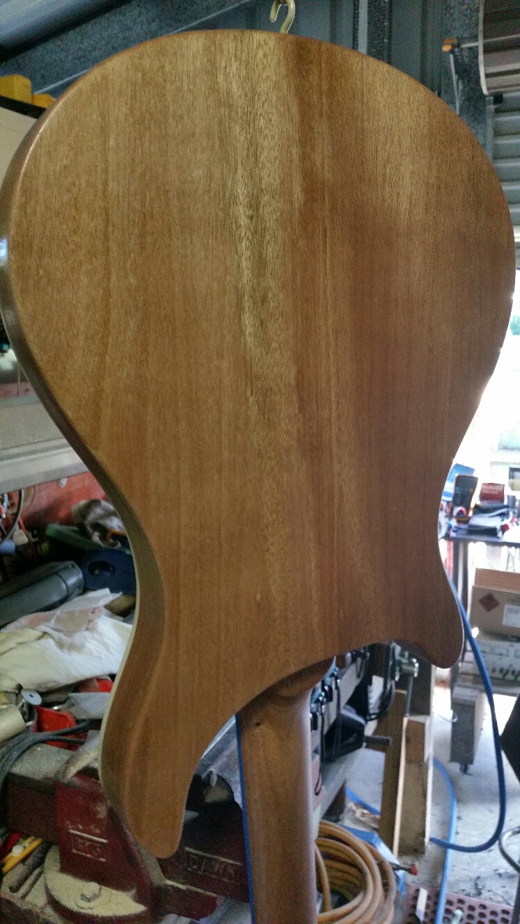

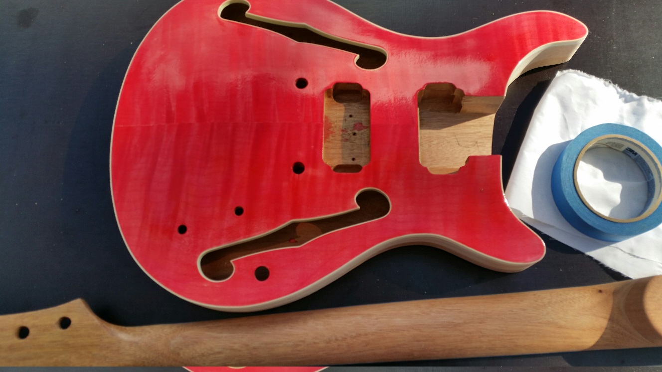

    A few hours with the wire brush & Goof-off, a little more staining with a watered down (weak) U-Beaut Red, and then a couple of coats of rattle can clear poly and it's amazing the transformation.
    The neck has only one coat of clear satin poly, but the headstock has two coats of clear gloss poly. Nil stain or filler, just natural Mahogany.
    Yeah, I know, nil filler = many many many coats of rattle can poly...... but I think it will be worth it...
    Next up is fit the neck, then more coats of poly...

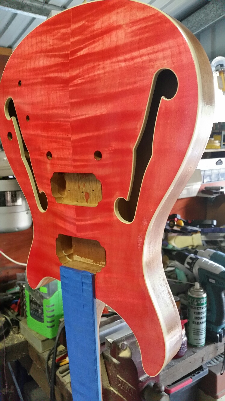

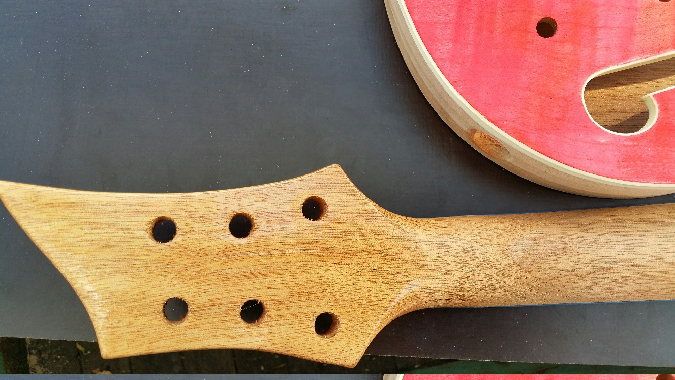

    In the mean time I'll keep applying coats of clear...

    Thanks to a few messages from Dedman I went and set my fears aside and spent some hard earned at Guitar fetish... One Gold Badass intonatable wraparound bridge on its way...US$23.00 + shipping.
