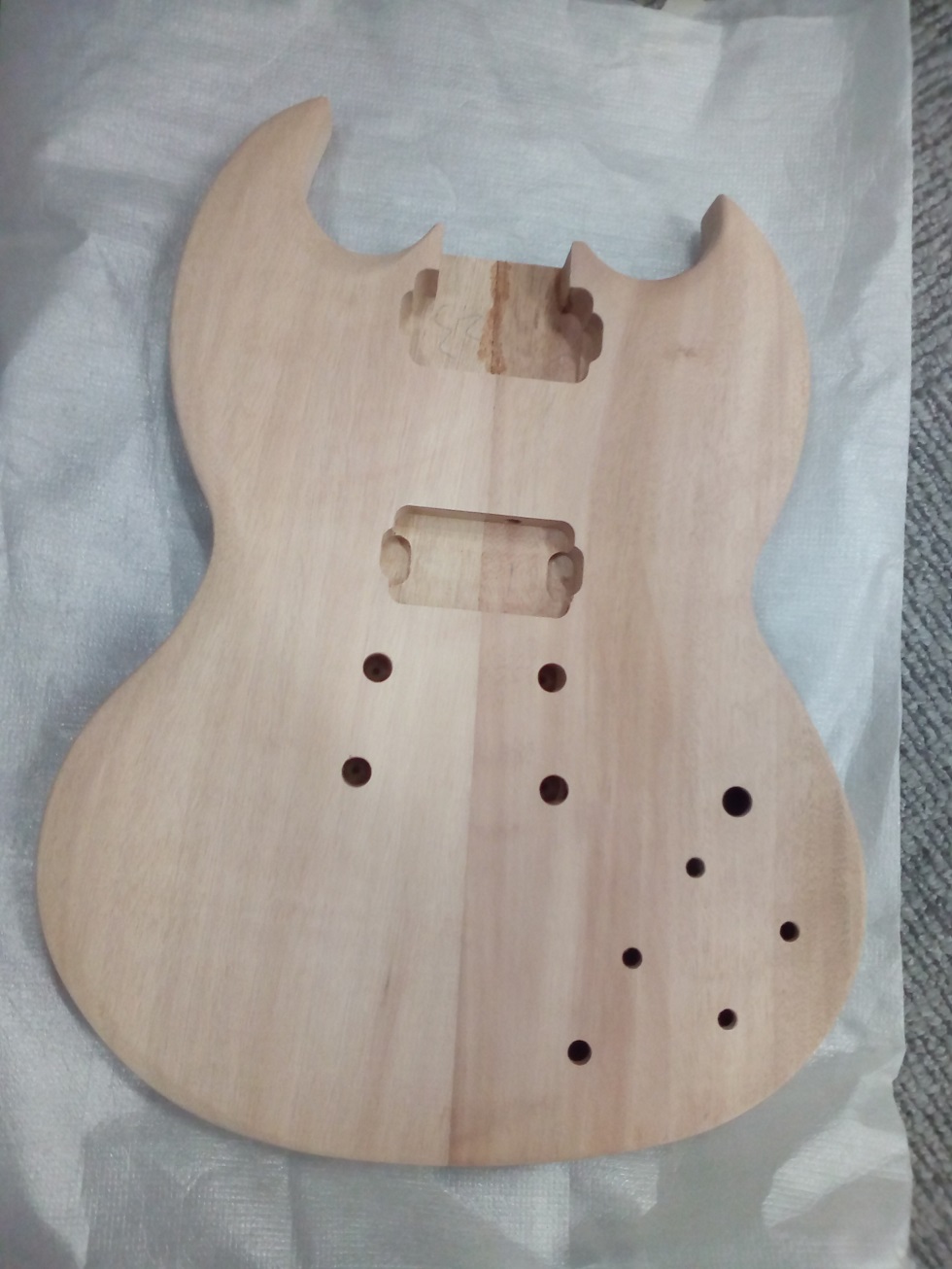

    Finally it has arrived it is 2 distinct planks. I will try to get the lighter plank darker before I Apply any stain on top.

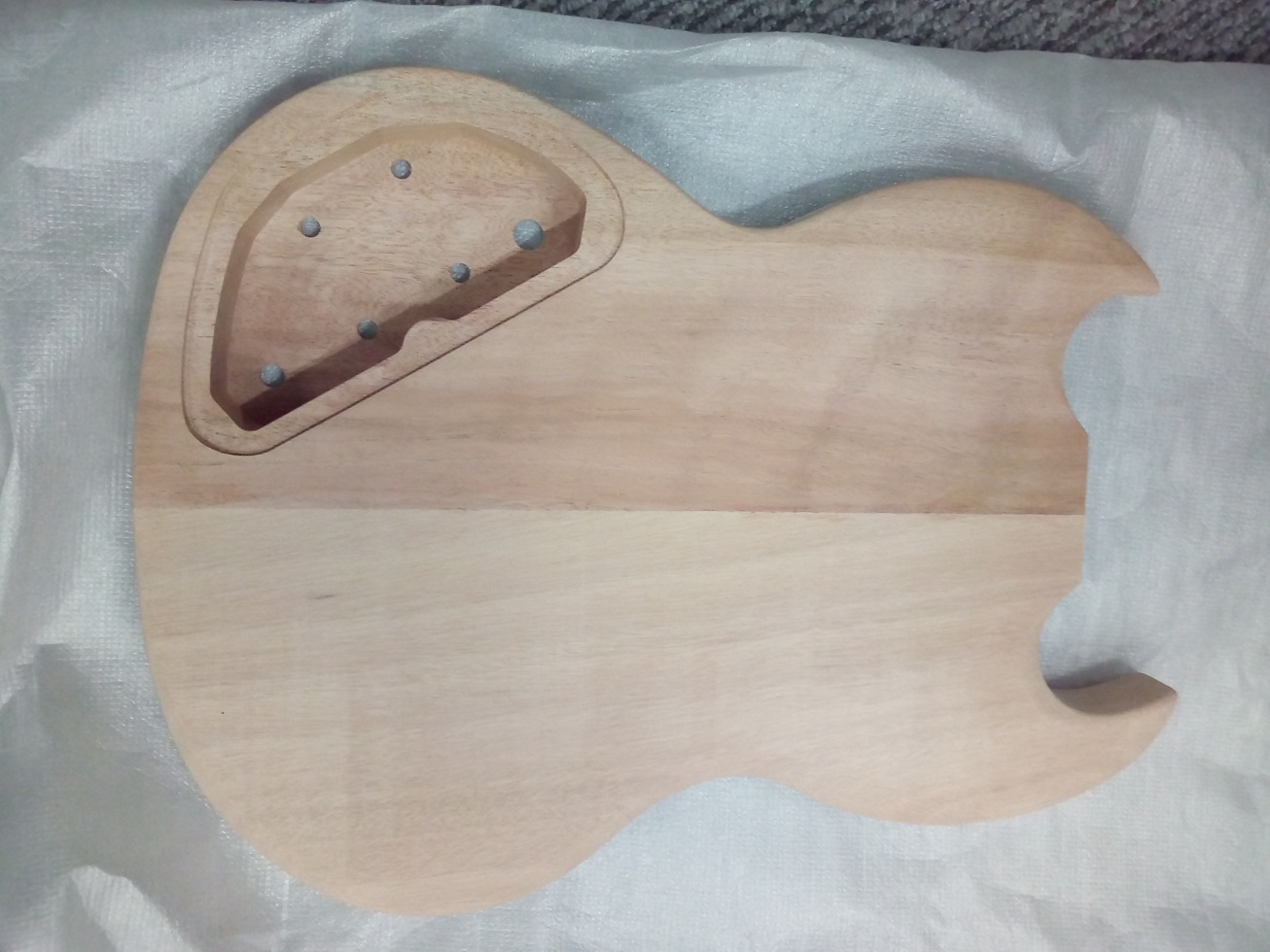

    I have spent a couple of hours sanding by hand whilst waiting for the sealer to arrive. This mahogany is as hard as I remember. Now I have it sanded to a good finish it has some fine what look like very fine band saw lines on the front almost like coarse sand paper grooves. If they do not sand out they could be an issue when I start on the dye. they could leave dark straight diagonal lines. I don't want to have to get the power sander out.
  8. #18
    Quote Originally Posted by DaveC64 View Post
    Sometimes you need to sand in the same direction as the machine marks and once they are gone revert back to sanding in direction of the grain.

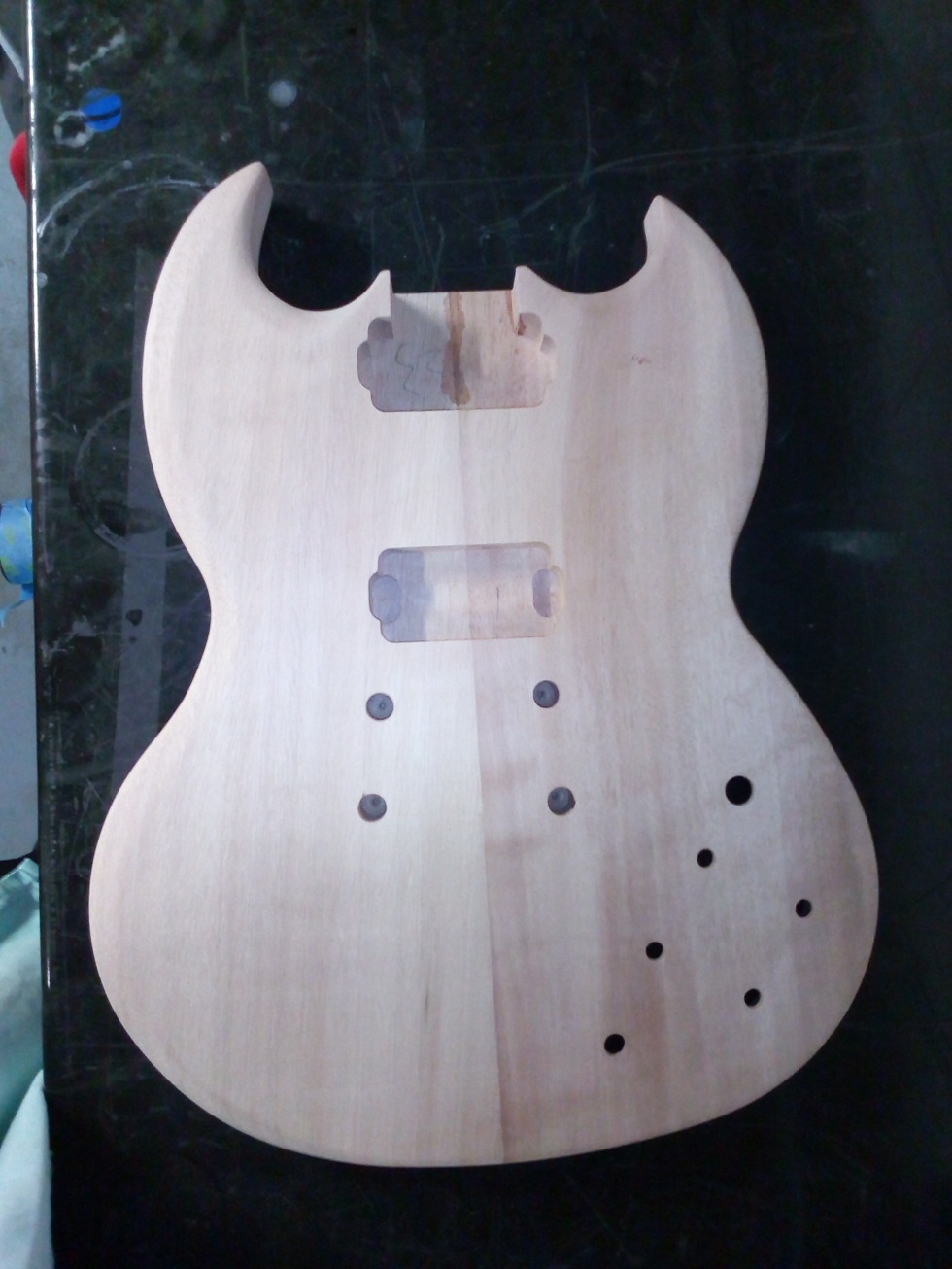

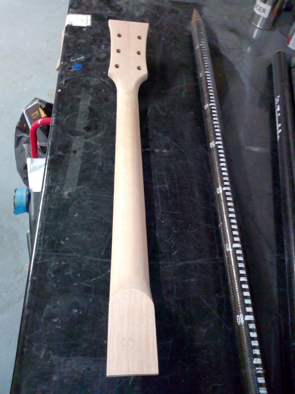

    Body and neck Sanded and sealed ready for the dyes when they arrive. Just got to sculpt the headstock
    Yep I tried that but the wood is so dam hard it is hard to make in impression hence I have used some sealer in hope that it will help with my next sanding pass.
