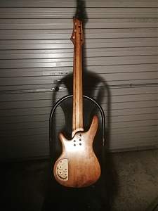

    First coat of stain down. Many more to go! Might only go a few coats of stain deep, before putting my satin finish (4 coats might be enough?) so as to keep the grain alive? Will know when each coat is cured, what looks nice

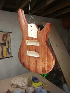

    Had an issue where some of the stain went black on first coat (think it was dust from the sandpaper mixing with the stain... should have run a hoover over before first coat) Had to strip some of it down and start again. A coat or two later, the body's starting to take on somewhat of a texture. The stripping and re-staining has added a more stressed and aged look to the wood but, I don't mind that, it gives it a little bit of character. The body won't be going any darker than this really. The most of the remaining coats are being mixed with a gold flake so, if anything, should brighten up a bit (it's nice to keep the appearance of the veneer visible).
    Oh well, I've made some mistakes, had to fix some mistakes... I've learnt a lot from this build for the future.

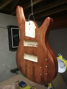

    All coats of stain now applied. Just have to leave it to cure for a bit before applying my satin finish. I think I brought it back from the brink in a few spots but, I know what NOT to do next time around... =P

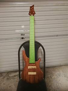

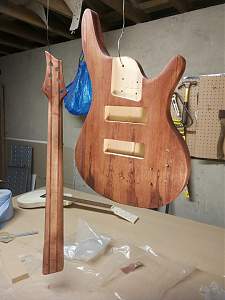

    Did a quick test to see how tight the neck was before doing the satin clear coat. Nothing a little 0000 steel wool won't take care of...
    I think the look is starting to come together =)
