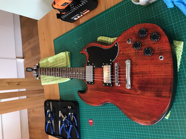

    So far so good. Neck fitted (at the correct length). All electronics soldered and installed. Tuners and strings going on tomorrow... at which point I’ll discover whether or not I’d followed the soldering video correctly 😉👍
    No matter what the outcome it’s been great fun and educational.

    All done. In tune at the open string and 12th frets (with very little tweaking required at the bridge). Although I suspect the I’ve got the neck pickup installed the wrong way round... 🤔
    Thanks everyone for your help and support. A couple of days ago it was probably going in the bin 😄

    Yep, normally the polescrews are at the other side, next to the fretboard end. Looks sweet though Zed, and a great save on the neck reset, not an easy thing to do. Great job man!😄👏🏾
  8. #18
    Nice work, pick up fip is easy enough so not a major drama. Guitar looks great.....starting to think I need an SG...

    Oh good, it’s not just me then?
  10. #20
    great work Zed, glad you got the neck sorted and the build looks tops !
