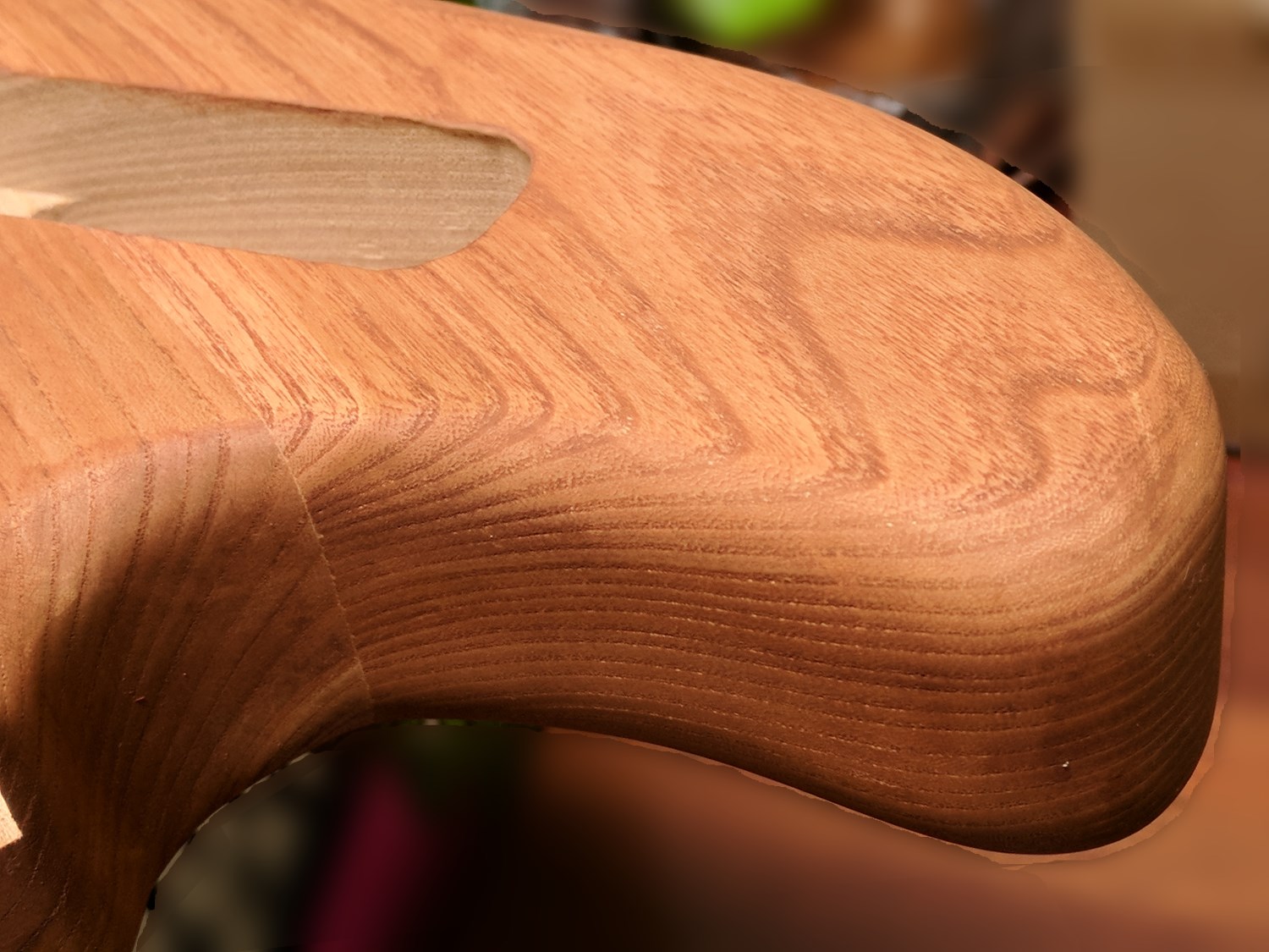

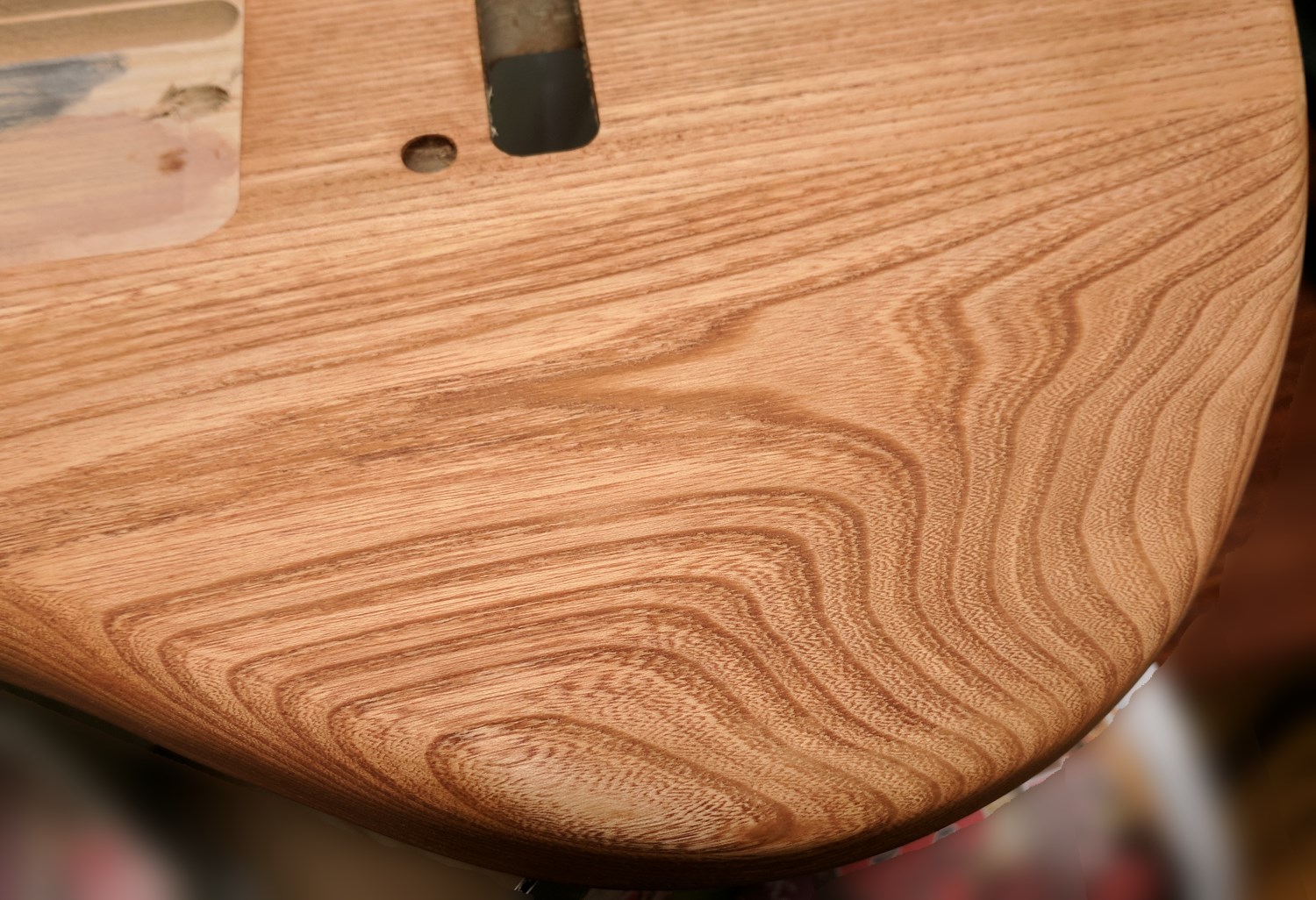

    Following advice I used Timber Mate filler. Tried Ebony, Jarrah and ultimately Hardwood/Tas Oak. Found that Ebony and Jarrah tinted the surrounding wood, although I later found that DT Nullarbor Ochre obscured the Jarrah colouring. Shots after sanding the filler:

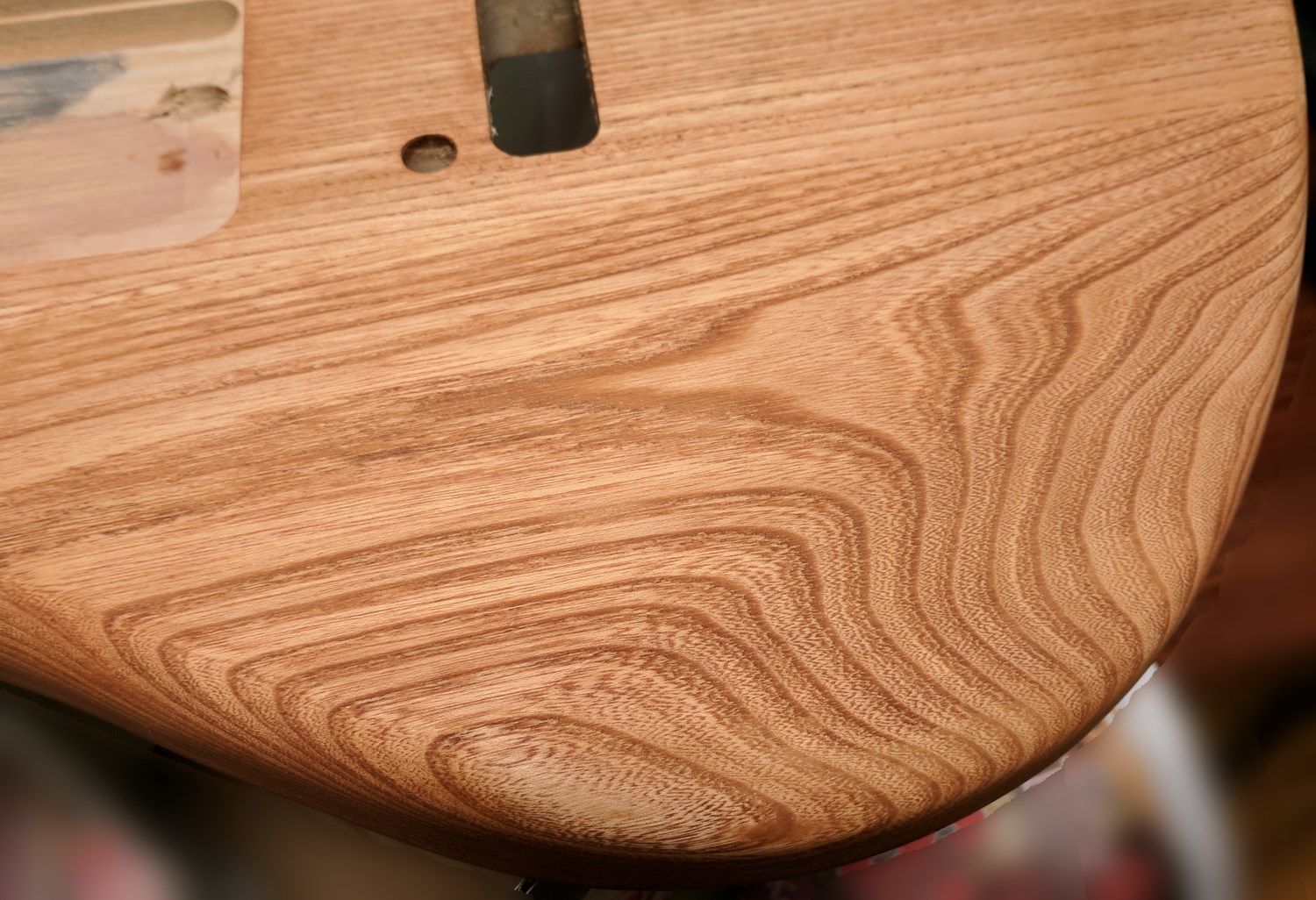

    Applied DT Nullarbor Ochre stain coat. Filler took on more colour than base timber. Generally okay but a few spots with excess filler

    Thanks Andy40.
    I actually sanded down to 400 grade, partly to avoid or correct the 'tear out' you mentioned, which occurred in one spot when I first sanded with a heavier grade. (I also dampened with water to help raise grain and holes in the bottom of the concave curves for sanding purposes - not sure if this ultimately contributed to the glue line visibility problem).
    Re your suggested spot fix approach, do you ultimately re-stain the whole body or can spots of new DT application be happily blended in ?
    I quite like the current nutmeg colour. How much darker will multiple coats make this ?

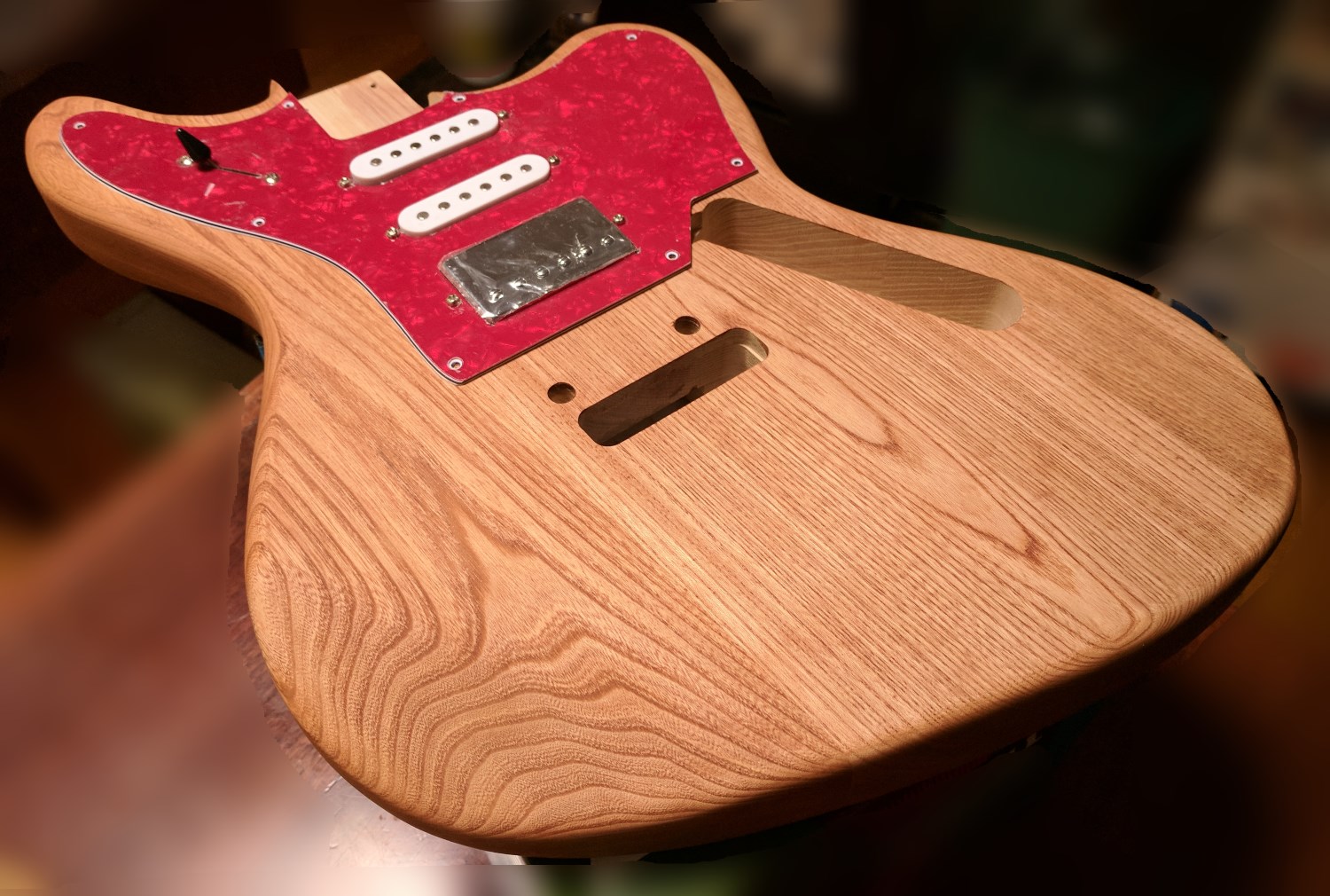

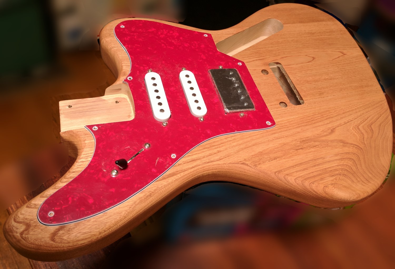

Name:	Top from rear.jpg
ID:	23080 Click image for larger version.
Name:	Top from front.jpg

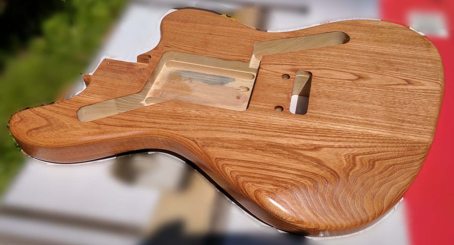

    Have now put 3 coats of DT Nullarbor Ochre on and think the answer to my question about how many coats to apply was 2.5 !
    Here's how the body looked after coat 2 - a big improvement on consistency from 1st coat and almost good enough with only a few minor dry spots.
Name:	DT Coat 2.jpg
    I let it sit for a number of days and opted to put on a 3rd coat. Has had about 4 days of warm temperature (high 20's to mid 30's) and still does not feel completely dry (compared to 1st and 2nd coat outcomes) as it still exhibits a slight tackiness. Also looks like the DT has pooled in a few places as if it didn't soak in and/or blend in on overlaps. Happy to take any feedback about how the base coat of DT behaves in a multi-layer situation and also happy to hear suggestions about how to remediate any spots where the finish has not fully blended.
