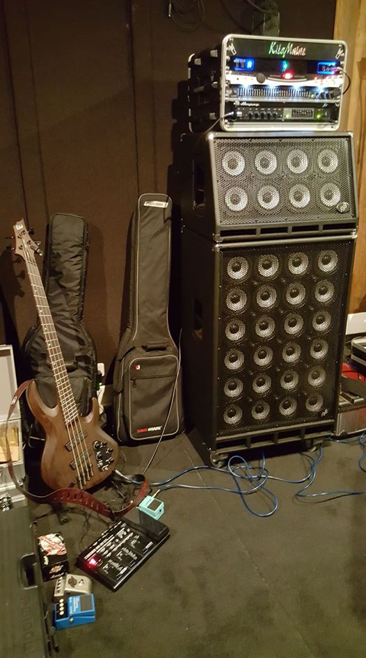

    Thank you Simon. I must study the equations more and understand them proper. I had band rehearsals tonight and used the Ampeg B2 with both the PJB cabs and it sounded great on both passive and active basses of mine and held up well against the rest of the band. They were quite impressed as so was i. We could every note that i played on the bass.
    I have attached a pic of my set up.

    Awesome rig METAL.
