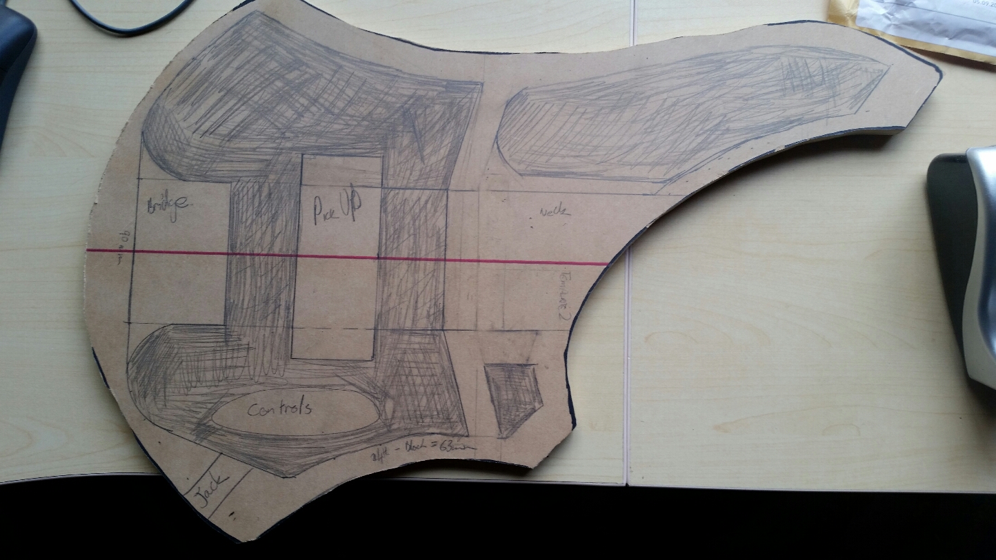

    Chambering, and a trap for young players
    I've sketched out some areas which will be carved away, leaving solid areas where necessary for bridge, pickup and neck join.
    The trap? I initially measured the scale length from the back of the bridge- not from where the saddle will be seated. So back to the drawing board for the neck design a little bit. Just glad I caught it before cutting up valuable timber!

    Interesting design. A little bit Status, a little bit Zon, a lot cool.
  10. #20
    Just don't remove too much weight so that it becomes neck heavy. You can take out a lot of weight near the centre of gravity and it won't do much to the balance , but taking it away from the bridge-end, which is a long way away from the CofG, will have a much greater effect on the balance (principle of moments). All very difficult to calculate though, so just bear it in mind.
