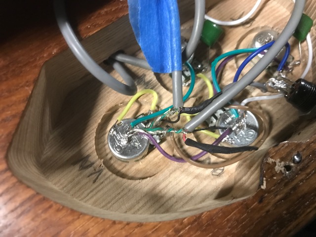

    If you've not removed the socket, are you able to provide a clear photo of your wiring? Not sure, but it sounds like something else might be involved.
    Sounds like that

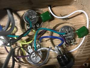

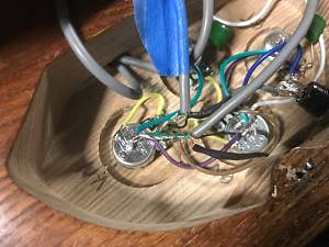

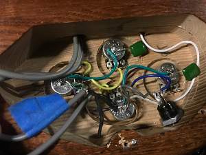

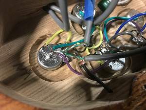

    Thanks Paul. Photos attached. On a side note, just to make the day a little more frustrating, two cover plate heads sheared off while i was tightening them - by hand.
    I insulated the red/white with black shrink. The rest, i followed the above diagram. Again, the guitar sounds and plays great, it's just I suspect something is a little sketchy.
    Love to know your thoughts.

    I confess I'm having difficulty seeing everything. Check for solder bridges between wires, terminals, etc, on all pots and the jack. Use a magnifier to see clearly, and/or use a continuity or ohm meter to confirm or exclude.
    Is a green wire from a pickup twisted around the shield material? If so, check that the green insulation hasn't melted from soldering.
    If you can get in closer with the shots (maybe use a tripod?) it will be easier to examine.
    I feel confident that you will get this sorted. Many issues arise from bridges, shorts, or grounding issues.

    Quote Originally Posted by Paul_H View Post
    Bummer about the screws, by the way.
    I routed around the cavity on my IB-5 so the cover sits flush. That was a nerve-wracking job!
    I left green/white as they were out off the box. Are you referring to it possibly contacting a wire other than the sheild?

    I didn't use the stock pickups for my IB-5, so I wasn't sure about the appearance of the pickup leads.
    It is possible to melt wire insulation if the soldering is prolonged, and in paired cables (such as twisted cables) this can sometimes contribute to shorts that are not immediately evident.
    Good light and a clear head are your friends for this kind of troubleshooting
    Agree. Going to let this sit until the weekend. Should have the new socket by then to cross reference whether the issue lies there. Got my magnifying glass and head lamp ready to go. I'll report back.
    Thanks again Paul.
