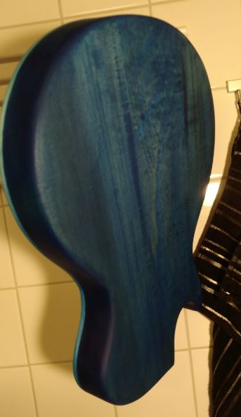

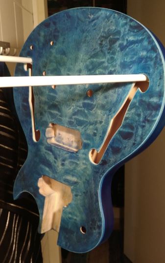

    I finally managed to do the sanding and painting
    Here is the result:
    I'm pretty happy with the result. During the process I realized that I wanted darker blue shade. It just looked more consistent. I didn't know beforehand if I would go for the burst as I was doubting my abilities. In the end, I decided to go for it anyway :P

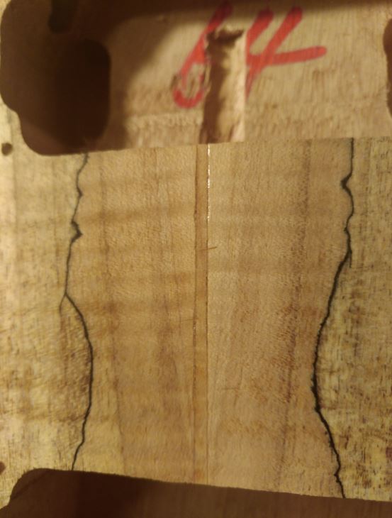

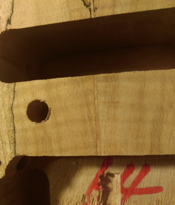

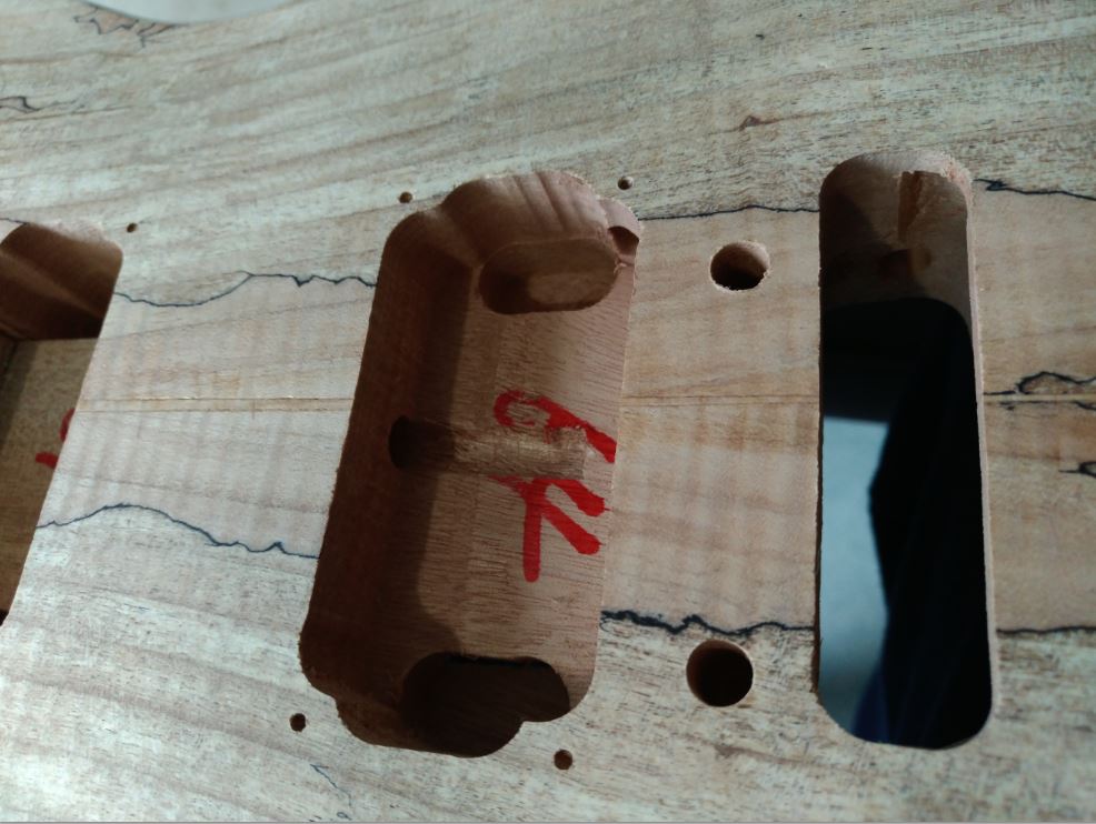

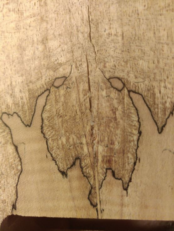

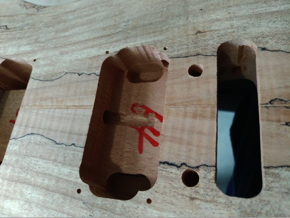

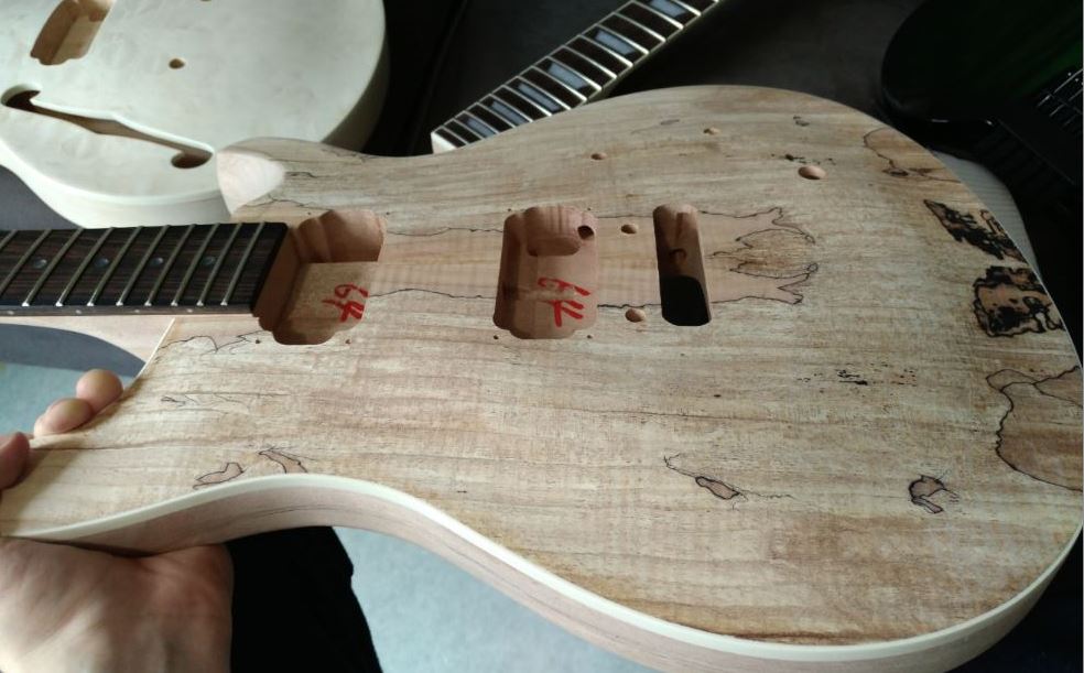

    Off topic: I also got a bit crazy and ordered another DIY kit. There is pretty big glue problem in the center. If you happen to have some ideas how it could be dealt with that would be awesome !

    Hi Thibault, it's a bit hard to see the glue spots, can you wipe over the veneer with a damp cloth and take a photo and post please ? There are glue remover products such as goof off I would try that. The other method using a small wire brush you will risk damaging the thin veneer. The ES-2V build coming along well !
  7. #16
    Is it just me, or is there a gap between the two halves of that veneer?
  8. #17
    good point Pabs, certainly looks like it when you zoom in.
  9. #18
    Member ILRGuitars's Avatar
    385
    Use Goof Off for the glue spots. Works well but you might just need to use some extra stain on those areas. No big problem.
  10. #19
    Yes! There is gap and in the factory they have "fixed" it with a random wood splinter and glue
    It's a good opportunity to learn new things
    Thanks for the feedback!

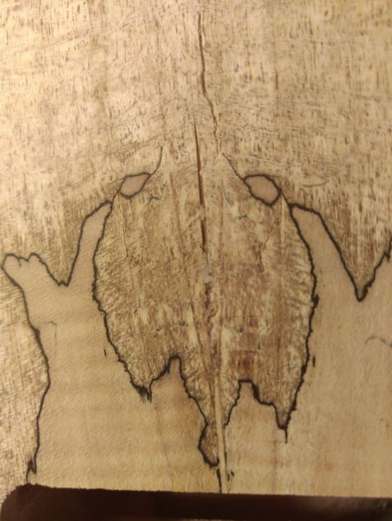

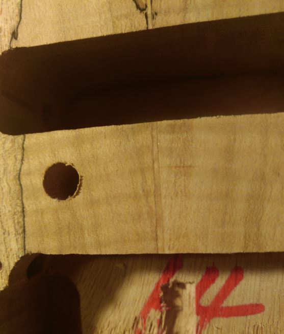

    I took some closeups !
    I used methylated spirits to highlight the area.
